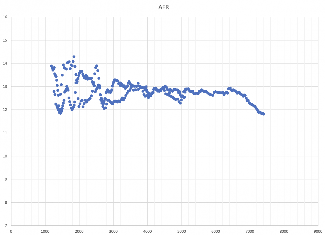

    After running Terra's CSL Tune on my car it jerks below 3500 rpm when running at full throttle. And if this continues, all pistons will misfire.
    When I measured the air-fuel ratio, it shows 10.0 up to 3500rpm.

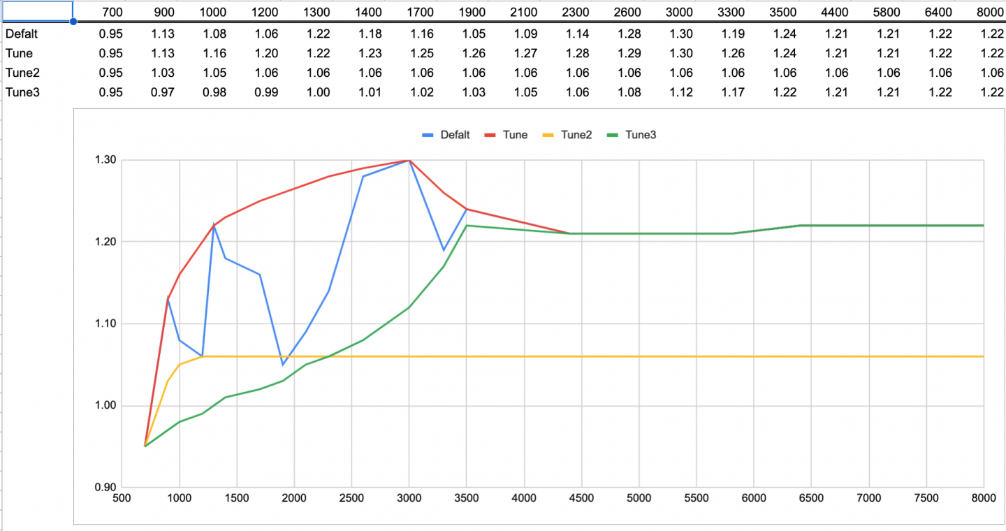

    This is what I did.
    ① The fuel injection coefficient of the full throttle map was lowered step by step.
    > does not resolve.
    ② I turned off the catalyst protection control using Martin's tool.
    > does not resolve.

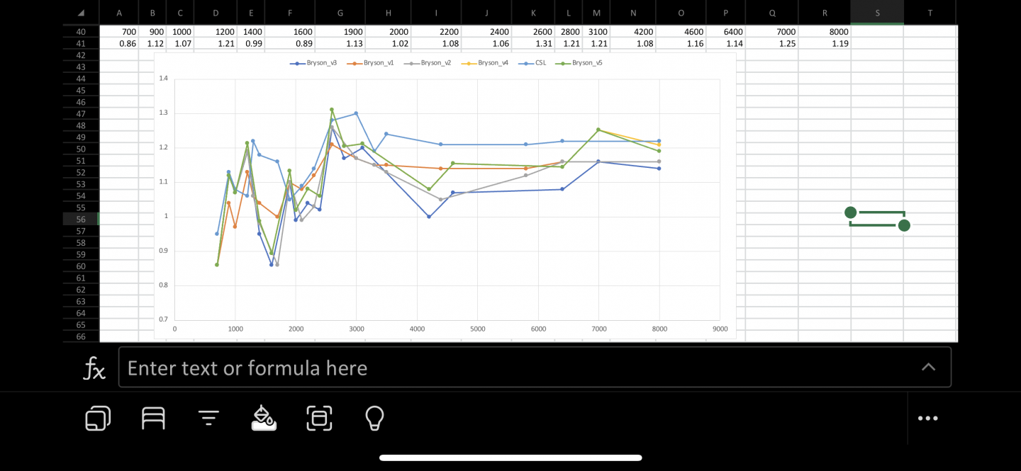

            Sending from my phone, but I found that in my interpolation map, I had to change RPM targets to get a flat AFR curve due to the added resonances of the airbox and SS headers. I’m running the flap, so don’t copy these numbers, but here’s where I ended up for WOT with multiple pulls overlaid (v5):
            Click image for larger version  Name:	IMG_5521.png Views:	0 Size:	262.3 KB ID:	224192
            Click image for larger version  Name:	v4 pulls.png Views:	0 Size:	400.4 KB ID:	224193

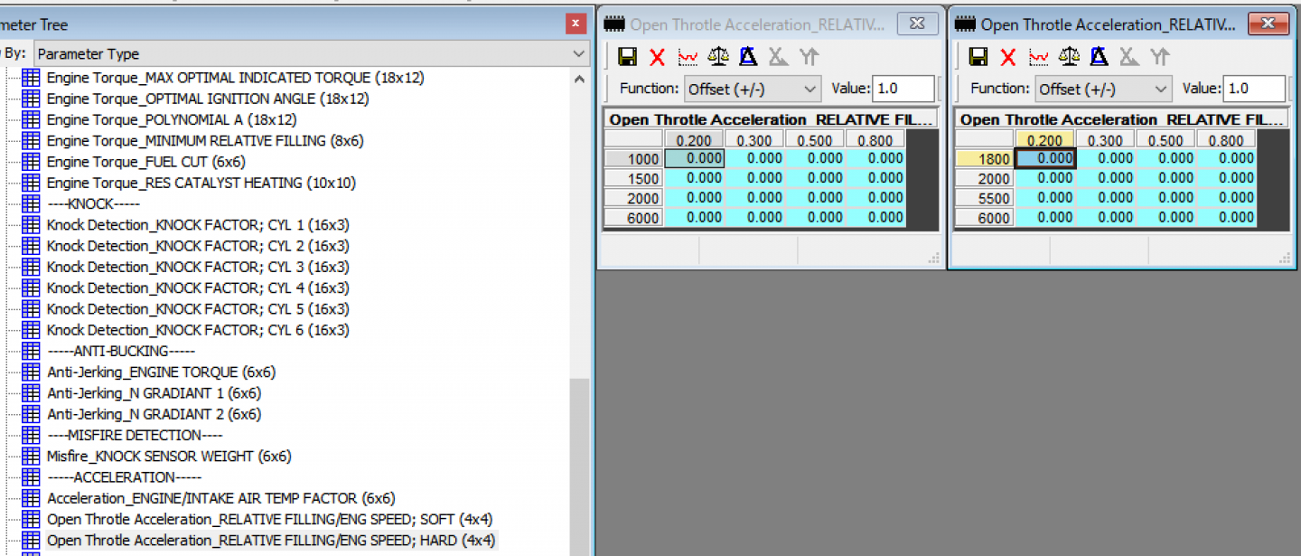

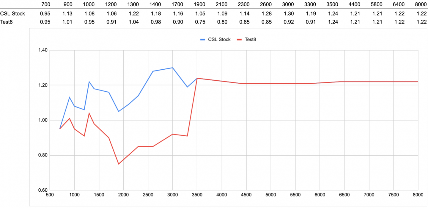

                Thanks for the advice. I made some adjustments based on your advice and made a big improvement.
                1.Does open flap table mean KF_DKBA_RF_N_HERD/SOFT? When all of these were set to 0, a slight improvement was seen.
                Click image for larger version  Name:	KF_DKBA_RF_N_HERD:SOFT.png Views:	6 Size:	358.2 KB ID:	224294
                2.After adjusting the KF_TI_N_RF_VL (WOT injection) table, the jerks were almost resolved. It showed an AFR around 12.5 with the following injection factor settings. (I can't show you because I haven't been able to integrate the engine speed and AFR..)
                Click image for larger version  Name:	TEST8.png Views:	6 Size:	249.3 KB ID:	224295
                My blind spot in this case was that I didn't think the injection factor would need to be this low. What I noticed this time is that the effect of securing the intake air volume of anteater nose (stock CSL) is amazing. Hats off to the BMW M engineers 20 years ago.

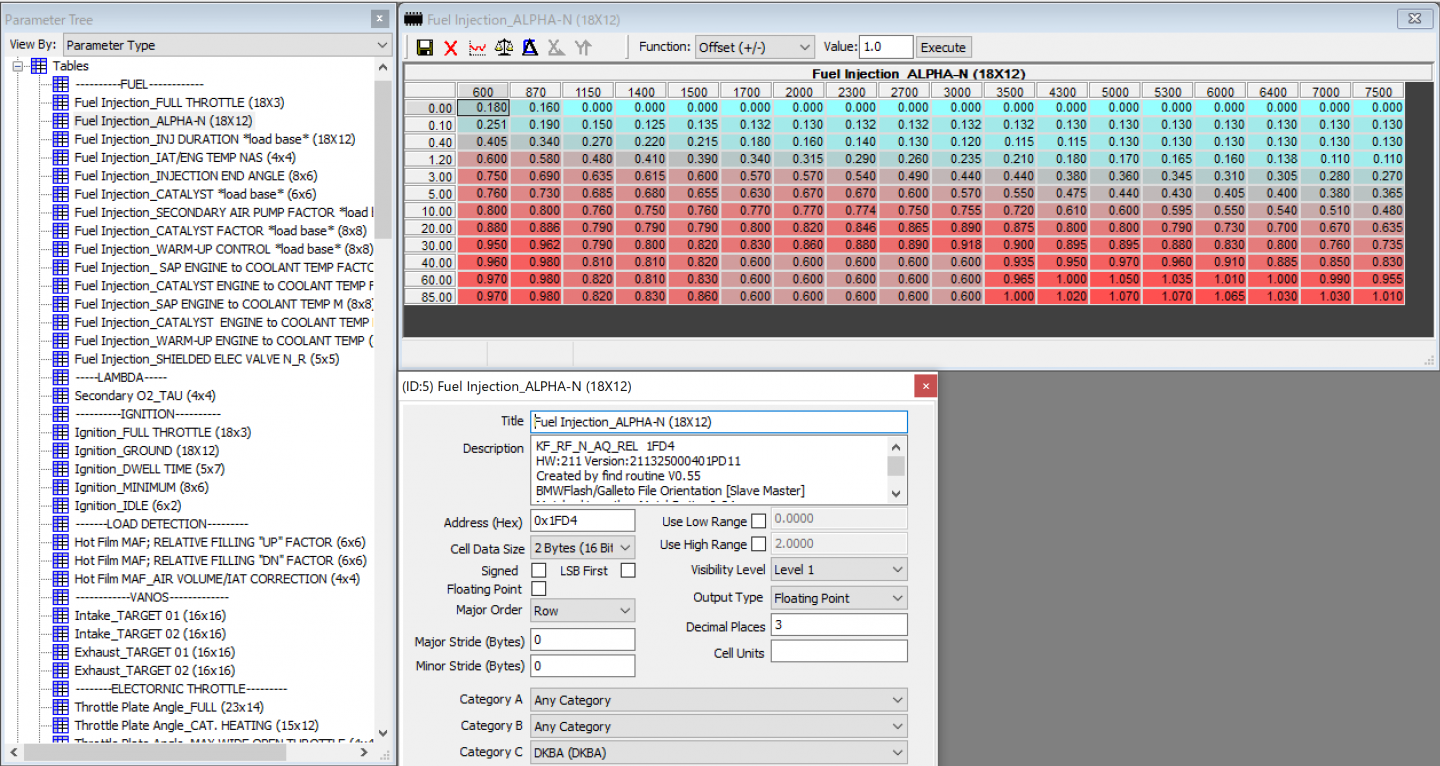

                        Which table is specific to the open flap? I didn’t realize there was one..
                        Sorry for late response…there are 3 of the „famous AlphaN“ maps. One is normal operation, one is emergency/limp and one is added if flap is open (not sure if it’s always added when flap is missing, best is to zero out). All these are 20x24, so look out on the public XDF for these 3 maps, I’m using my own xdf but these should be included. I have no notebook with me on vacation, but when I’m home I can look up the addresses if you don’t find them. The map for the flap starts in the lower areas with many zeros, easy to find out which is the correct one to zero completely out when flap is deleted.

                          According to public XDF (000401PD11) the ”famous AlphaN” is known to be 18*12.
Name:	スクリーンショット 2023-07-11 17.10.18.png
                          20*24 maps are not found by looking around public complete XDF.
                          Is what I'm seeing radically different? I'm a little confused.​
                            This 18*12 is not used per my knowledge to calculate RF in 0401 SW. The 18*12 is the limp mode base map to calculate RF (if Maf is faulty or not present) you would use in non CSL „AlphaN“ tunes. You must use the 20*24 maps in 0401, some time ago I saw a public xdf with these included, but the conversion inside the cells was not correct if I remember correct. But anyway the size and location was correct.
                            When I’m back I will let you know the map names.
