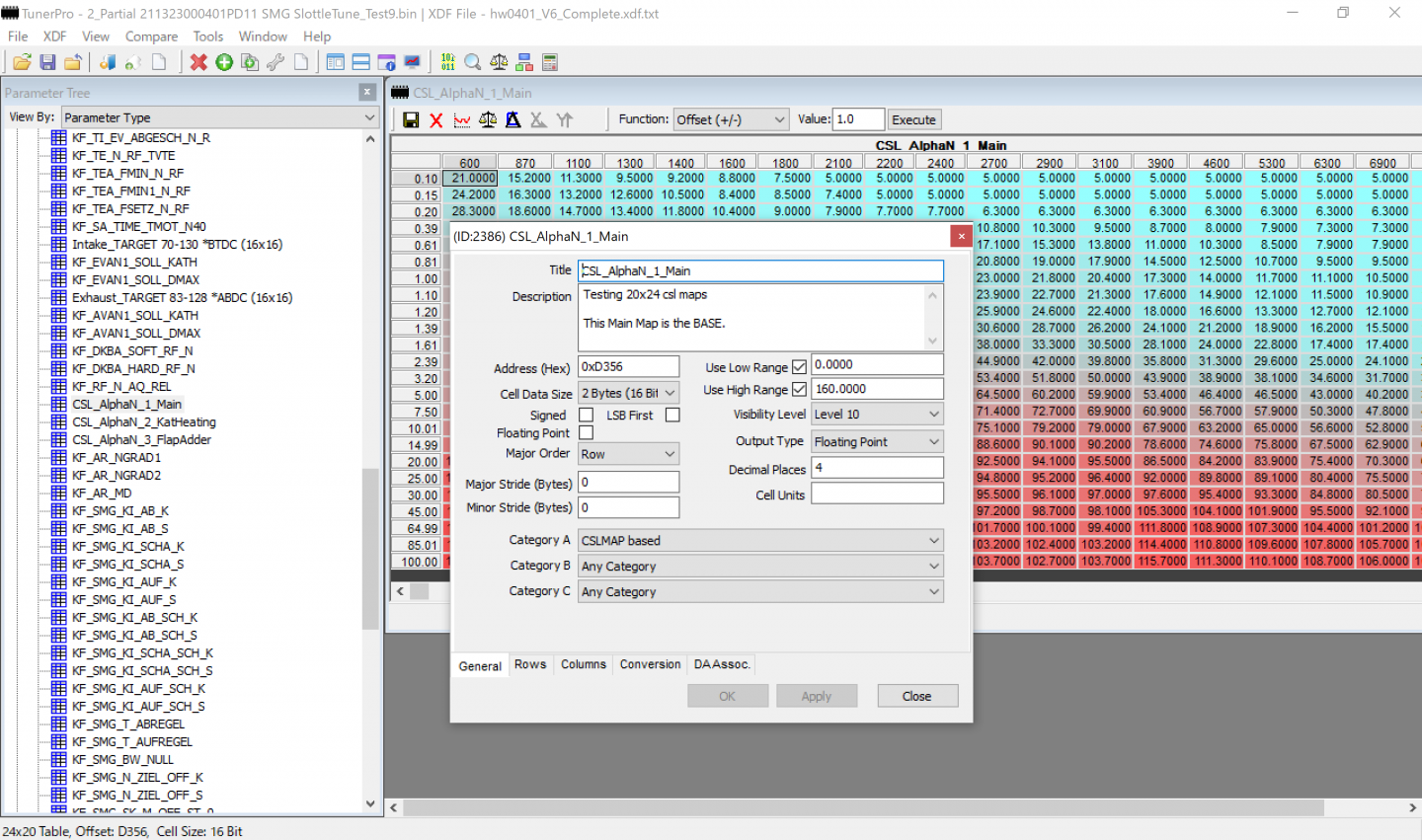

        Any update on locating the 20x24 map? I’ve checked all the maps in tunerpro and have yet to find anything remotely close to a 20x24 sized map.
        They start @0xD356. Three 20x24, all same size/factor. First normal op mode, second Cat heat and last is flap adder.

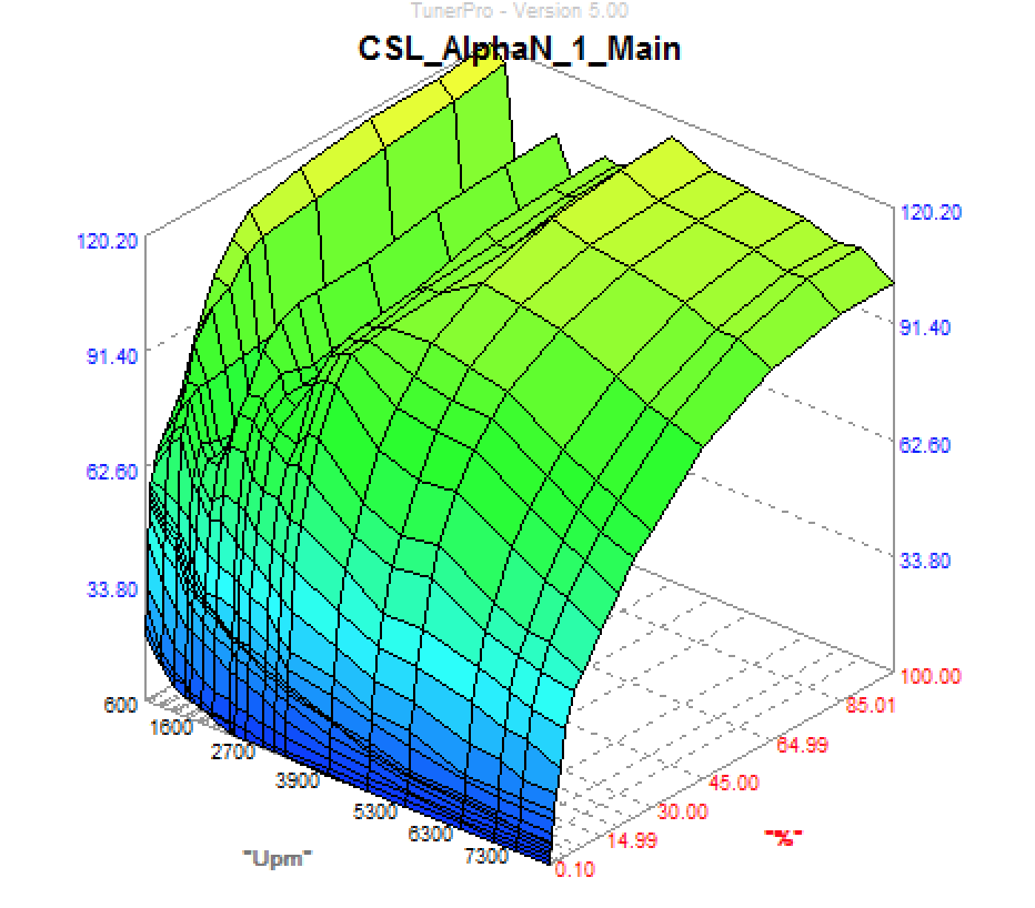

            The linked XDF has them, here's a 3 dimensional plot of the alpha-N map, it shows how much resonance there is between 1500 and 3000 RPM!

              They start @0xD2FE. Three 20x24, all same size/factor. First normal op mode, second Cat heat and last is flap adder.
              Thank you for sharing the information. Looking at the XDF that Bry5on forked to GitHub, the alpha-N main Map address is 0xD356.
                https://github.com/Bry5on/MSS54-XDFs...mplete.xdf.txt
                Thank you very much. Are you the one who created this XDF?
                With this, I was able to stand at the starting line of the setting.
                    It wasn’t me who created it, I’d downloaded it at some point and can’t find the source. Regardless, I’ve added it to git so it should be publicly available now as long as one has the URL
                      Sorry for confusion, I’m not sure from where I got these address.. I have checked it this time on my own xdf and it’s indeed 0xD356. I have edited my post!
