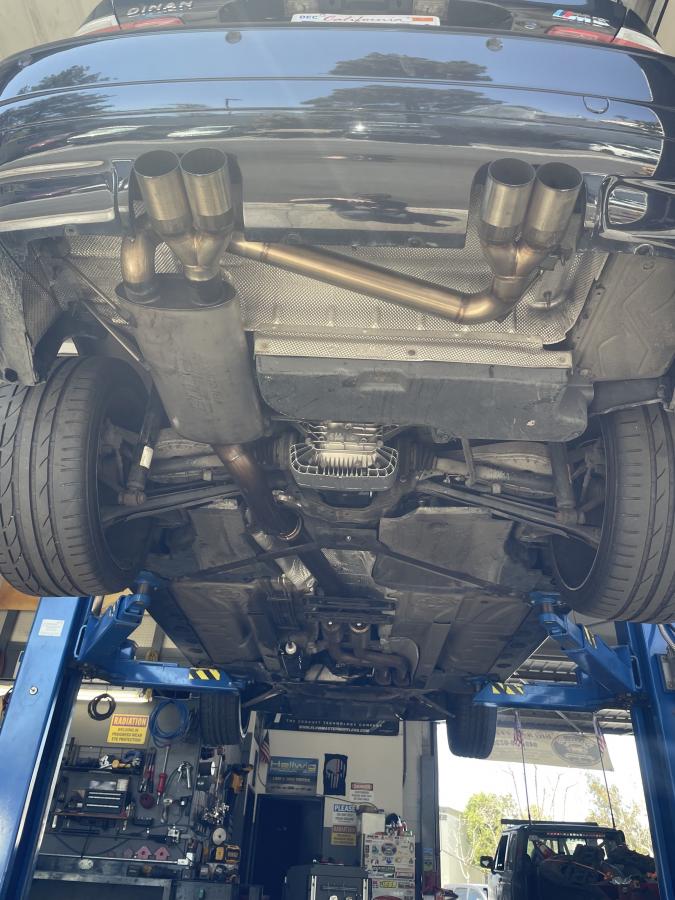

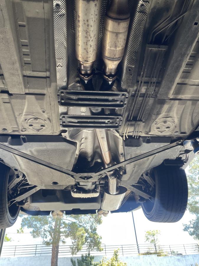

                  FWIW, I put on a custom 3.5" Y pipe setup, and felt a noticeable loss in mid range torque, as described. I do feel like the car pulls harder up top though, which is ok for me, as it's mostly a track car. It is LOUD and throaty, even with the added resonator. Exhaust pictured (sorry if the pics are gigantic)
                  Click image for larger version  Name:	dataurl262030.jpg Views:	0 Size:	115.5 KB ID:	239573
                  ​Click image for larger version  Name:	dataurl392106.jpg Views:	0 Size:	101.7 KB ID:	239574​
