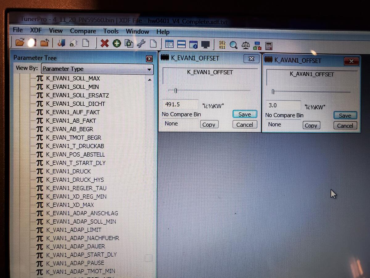

    This is a reading from my Stock DME I just pulled up, the readings are the vanos offsets. Why in the heck would they be this far out of spec? I assume someone must have changed them, but why?
    I currently have a different DME installed in the vehicle with CSL Software as many may know by know by all of my posts in regards to that.

    Are you using the correct xdf?
      That I do not know. The XDF I used to produce the values I just posted a Screen shot of was the one Martyn linked to me so I could view my CSL DME offset values.
      here's a link to it the XDF I am using
      https://github.com/saildot4k/MSS54-X...4_Complete.xdf

        Yup you're using the 0401 xdf which is for CSL DMEs. Different program versions have the same parameters located in different places, which is why you're seeing values that don't make sense with your non-CSL DME.
        Here's a table of the different versions: https://github.com/saildot4k/MSS54-X....-1601-to-1801
        Page 10 of this document describes how to identify your program version: https://github.com/saildot4k/MSS54-X...dification.pdf. You can also load a tune read from your non-CSL DME into Martyn's tool and it will tell you your program version.
        BTW I would recommend going through and reading everything on the GitHub page (all documents and everything on the wiki) if you're going to continue messing with your tune. It'll help you understand everything a lot better.

          Thanks man, makes me feel much better, thanks for the links. More reading, seems like I'm spending every night reading about something for my BMW. Could be worse...
