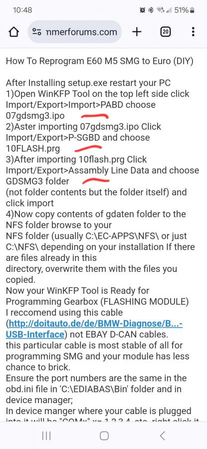

    I have never used WinKFP and am trying to program my E63 M6 with a Euro SMG tune and having a few issues.
    It is basically the same thing one would do for an E46 M3 SMG2 Euro tune. Anyways, the issues.
    I tells me to import "PABD" and "P-SGBD" files and then import assembly line data, do a few things and then flash.
    One issue I have is whenever I choose the requisite files for either "PABD" or "P-SGBD" I get a message saying "file already exists! Overwrite file?"
    If I choose overwrite file I get an "error 11 file could not be copied"

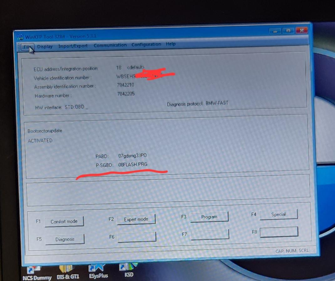

    The other issue is if I proceed I get this:
    I am supposed to have "10flash" under P-SGBD and it says "08flash", another laptop I used says "07flash"
    I am not confident in proceeding for fear of bricking my SMG module.
    Any help would be greatly appreciated!

    Here is a quick synopsis of the instructions/files:
    Click image for larger version  Name:	Screenshot_20240214_224803_Chrome.jpg Views:	0 Size:	85.6 KB ID:	253561
    I am following these directions:
    https://www.bimmerforums.com/forum/s...moother-shifts!

      *.prg have to be at C:\EDIABAS\ECU
      *.ipo (winkfpt ipo, not INPA ipo) habe to be at C:\ {EC-APPS\} NFS\SGDAT
      if you are flashing in expert mode, *.0pa and *.0da have to be at C:\...\NFS\DATA\DEVELOP
      in comfort mode all you need is in C:\ {EC-APPS\} NFS\DATA\ (ECU short name)
      if You don't know what You are doing, keep away from Winkfpt
      You want still flash use expert mode, but You have choose pabd and p-sgbd like you see above, selct ECU adress = 18 , select desired xxx.0pa and xxx.0da
      I still recommend keep away

              These refers to E46 CSL SMG, not to E6x SMG.
              There are different SMG ECUs, as you can see at PABD: 02GDSMG2,ipo ans 07GDSMG3.ipo
              Flash procedure is same, but:
              Shift timing is not in SMG ECU, but in MSS65.
              So don't waste your time
