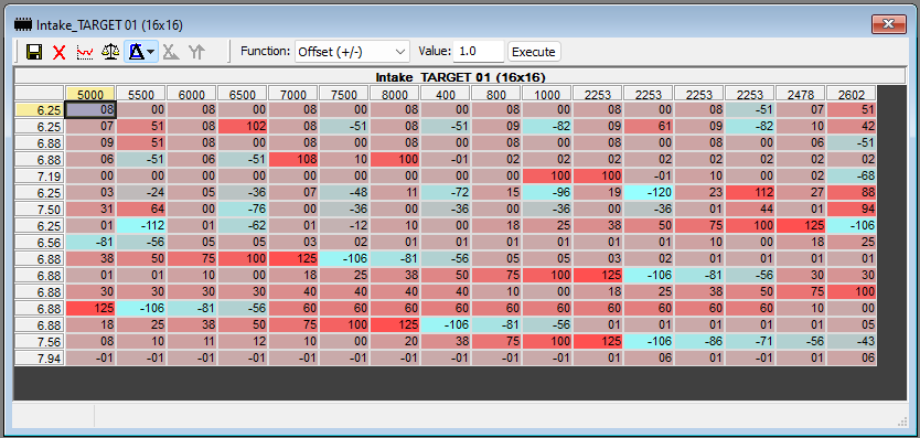

      Flicking through the tables and a handful of them are scrambled which I'm assuming is the XDF not mapping the data correctly? Intake_TARGET 01 for example:

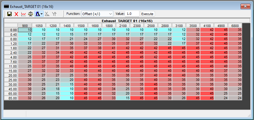

      Others look okay though, for example Exhaust_TARGET 01:
