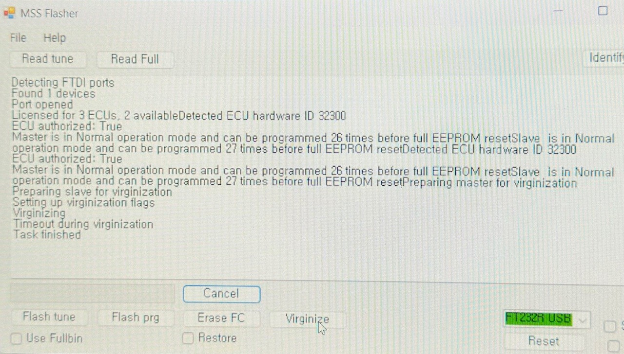

I completely initialized the DME using the virginize function of mssflasher and flashed it with the desired full bin file. I even perfectly inputted the VIN information.

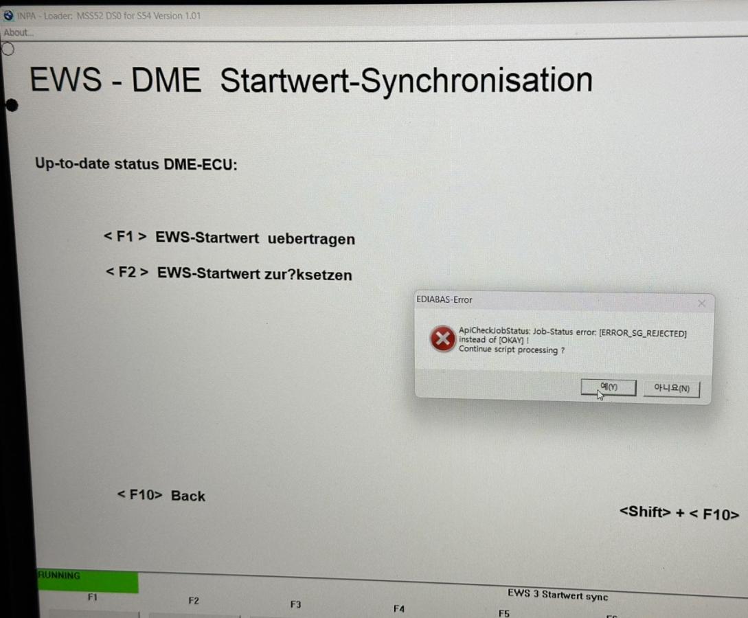

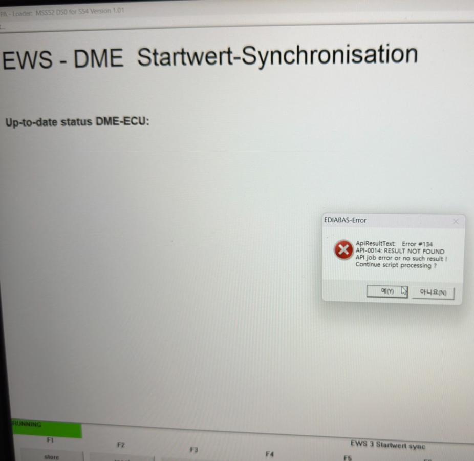

However, I got stuck at the last step, which is syncing with EWS.
When I use the sync function in INPA, it shows Error_SG_Rejected.

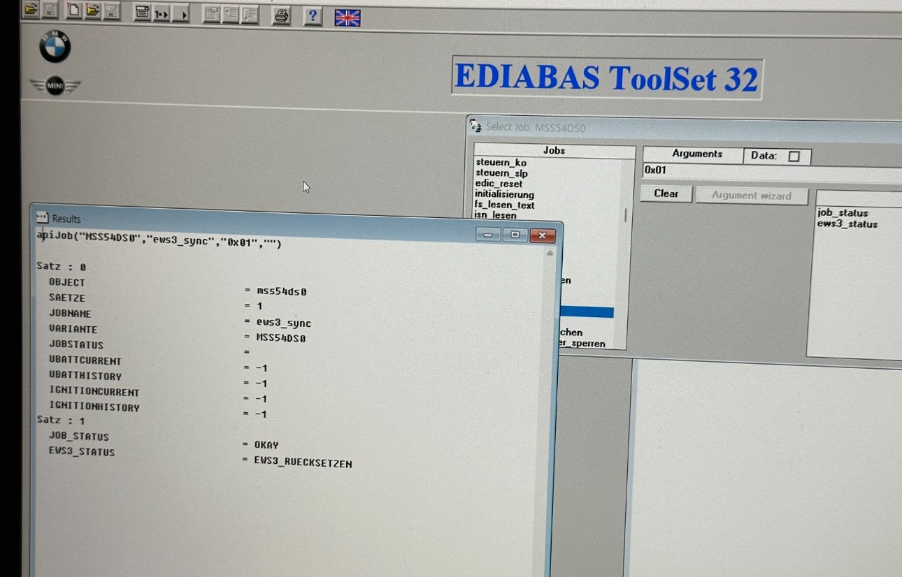

When I try the method in tool32, it shows "okay," but it still doesn't seem to be synced.
I followed the instructions in the last post of the thread below for the sync method in tool32:
[Link to the thread]
(https://nam3forum.com/forums/forum/s...one-dme-solved)
