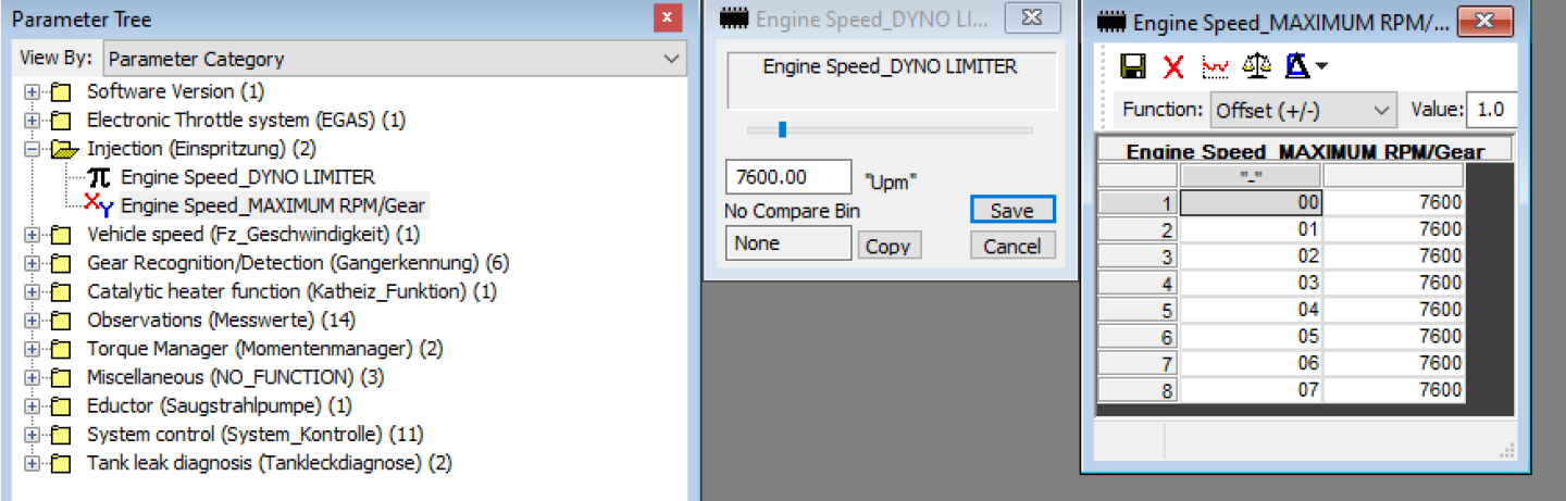

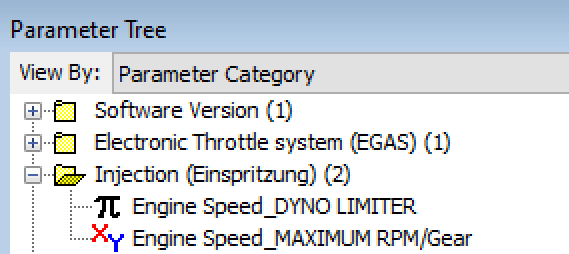

    I have an S54 swapped into a non-E46 chassis, running on a 1501 (non-HP) MSS54 DME, and I have changed the RPM limit in two places - the dyno mode parameter, and the engine speed per gear table.

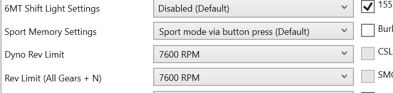

    I also opened the file in ECUWorx binary modification tool, and both fields confirm the same value as in TunerPro.

      Dyno limit = 7600
      All 8 cells in the X/Y table set to 7600

            To which set point did you adjust the limiter
            All values set to 7600.
