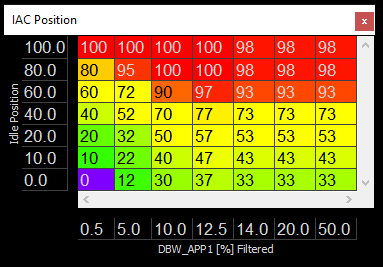

      Cheers Mirza, I have an AEM Infinity on my M3 and like the stock DME it uses the IACV for the low throttle inputs, however the throttle is super twitchy in areas it's using the IACV, I was hoping to mirror the values the MSS54 used
      I guess I'll just play around with the current values and try and soften it up a little.

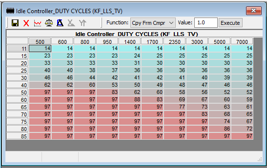

        I've just loaded the CSL XDF and bin and found this one, which looks interesting:
          That's just the duty cycle needed to achieve a target air mass (y-axis) for a given RPM.

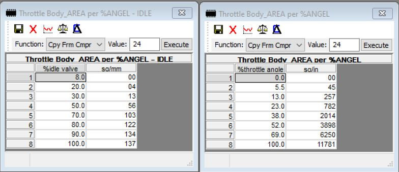

            The idle control valve operates during the first 10% of accelerator travel, then the throttle plates open. DME doesn't reference actual throttle plate/IAC position per-se, but rather the relative area of the opening, as a result of throttle plate or IAC actuation. The closest thing you'll get are the maps that convert throttle blade/IAC % to actual relative opening (sq/mm).
            KL_AQ_ABS_LLS & KL_AQ_ABS_WDK
