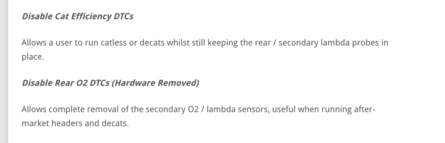

    I have Euro Headers (SG) with cats in section 1 like EuroSpec, and now and again i will get a CEL for Cat 1.
    I was wondering if tuning it out via ECUWORX would be an option?
    Here are the two options that i saw.​ Not sure if this would even work, or if I should consider other options. My main concern is that by doing this I would be damaging the cats or other components, and I am not entirely sure if it would work at all.
    Click image for larger version  Name:	Screenshot 2024-07-27 at 10.04.13 PM.png Views:	0 Size:	101.5 KB ID:	273574​I would also be grateful for any other feedback in general, or if anyone has had this issue before!

    subscribing for info. was literally just tinkering with these settings tonight. i diabled both items you have listed, but I have post o2 and egt deleted. euro headers with HJS cats welded in.

                Post CAT o2s don't adjust the fuel trims. They only monitor cat efficiency. Far simpler to just turn em off and force readiness for GA emissions.

                  Reviving this thread.
                  I cleared codes and Disabled Cat Efficiency first, will drive around and see if CEL comes back.
                  If it does i will commit the second change and keep you guys posted.
