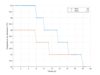

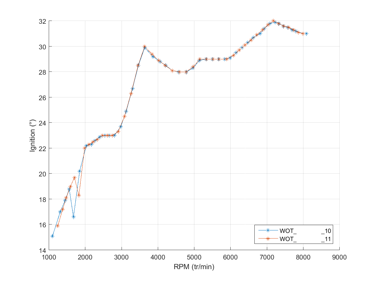

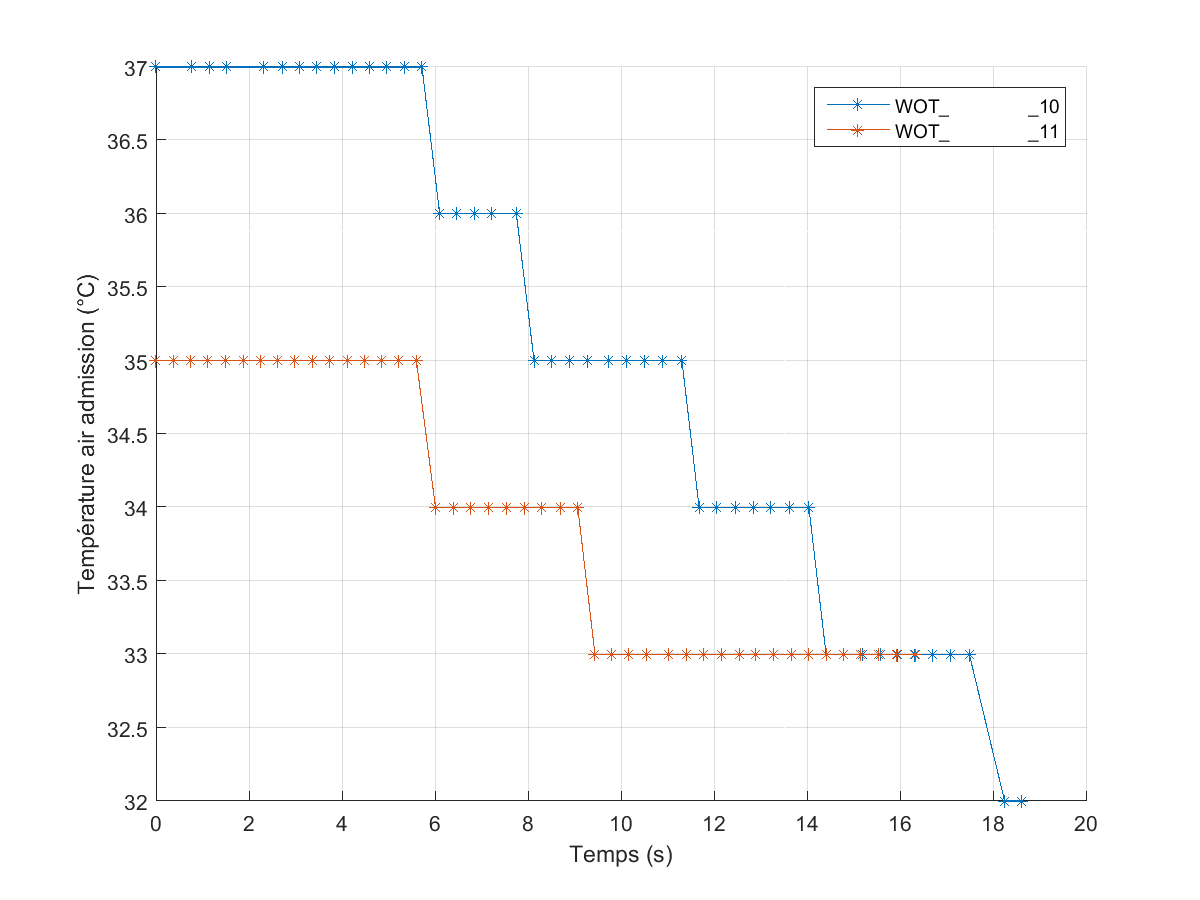

I´m currently running a Karbonius Box with 0401 CSL software. Have done some basic logging and waiting in the moment for my new wideband lambda for accurate AFR logging.

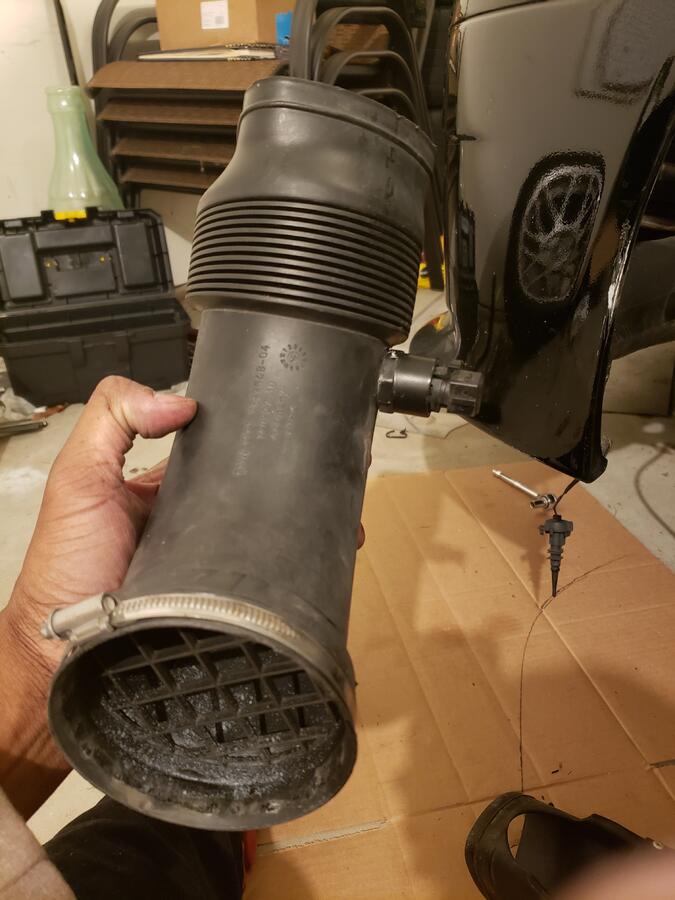

While logging, i found out that the original CSL IAT sensor get massive heatsoaked and read at 20°C ambient temp 50-55°C IATs even at high speeds. And ignition is retarded up to 10° from programmed values.
Have someone here logged his engine after MSS54HP MAP conversion with IAT in OEM position? Maybe can someone provide his logs?
I think the best way, is to relocate the IAT or maybe reduce the IAT ignition retard factor (not have found the right scalar yet, really hard to find out without the funktionsrahmen/ECU definition document)
Best regards,
