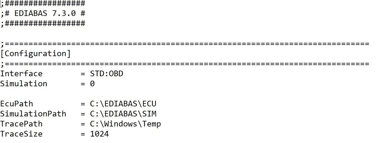

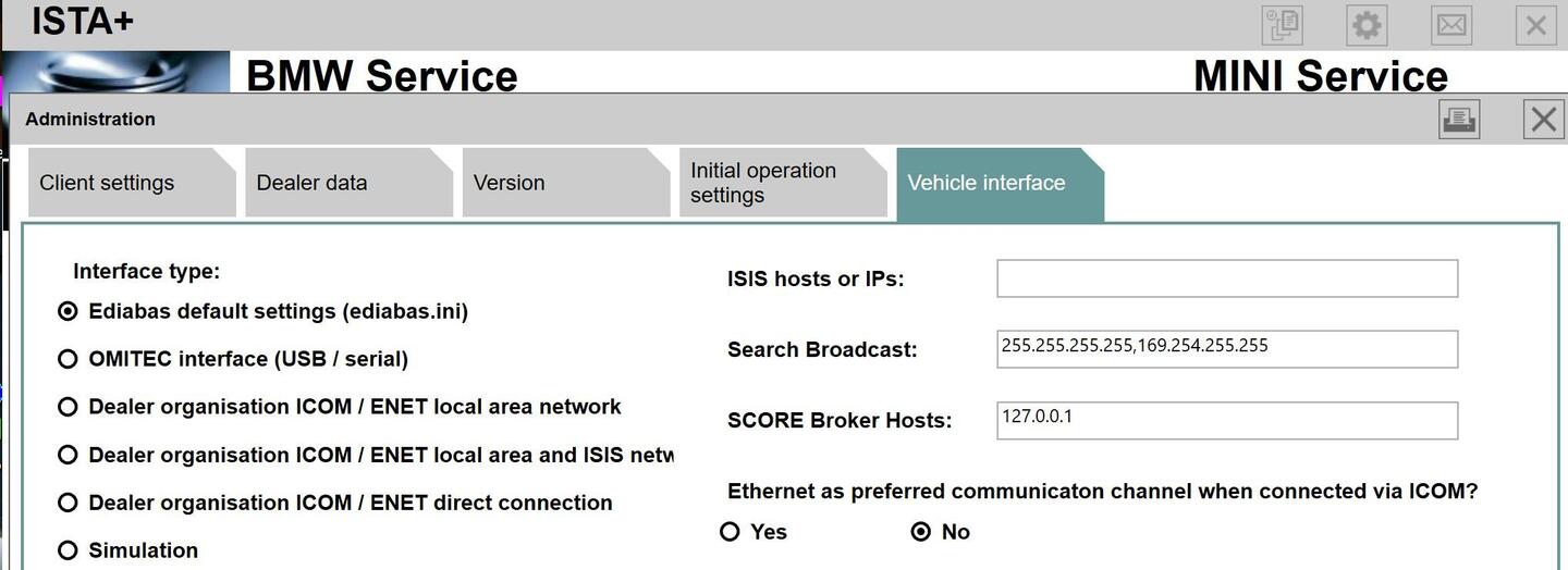

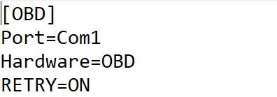

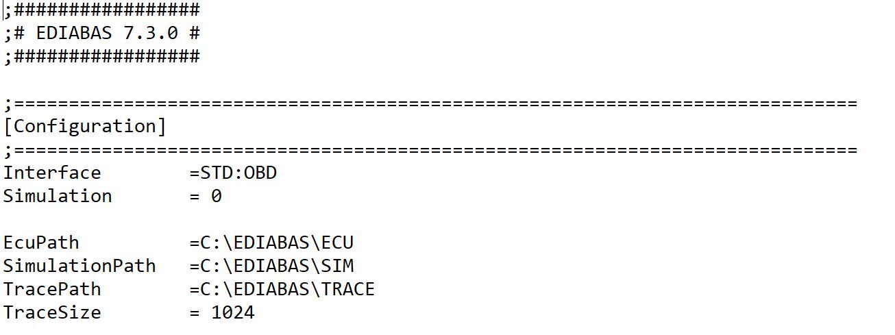

              Hmm, oh yeah I recall what you're talking about. Sorry for misleading you. These are my settings below:
                You need to open up your directory and find C:[Your_Program_Directory]\EDIABAS\BIN\EDIABAS and set the configuration as shown in the picture. And then open C:[Your_Program_Directory]\EDIABAS\BIN\OBD and change the port to COM1 and Hardware to OBD (as shown in the picture as well). Hope this helps.
