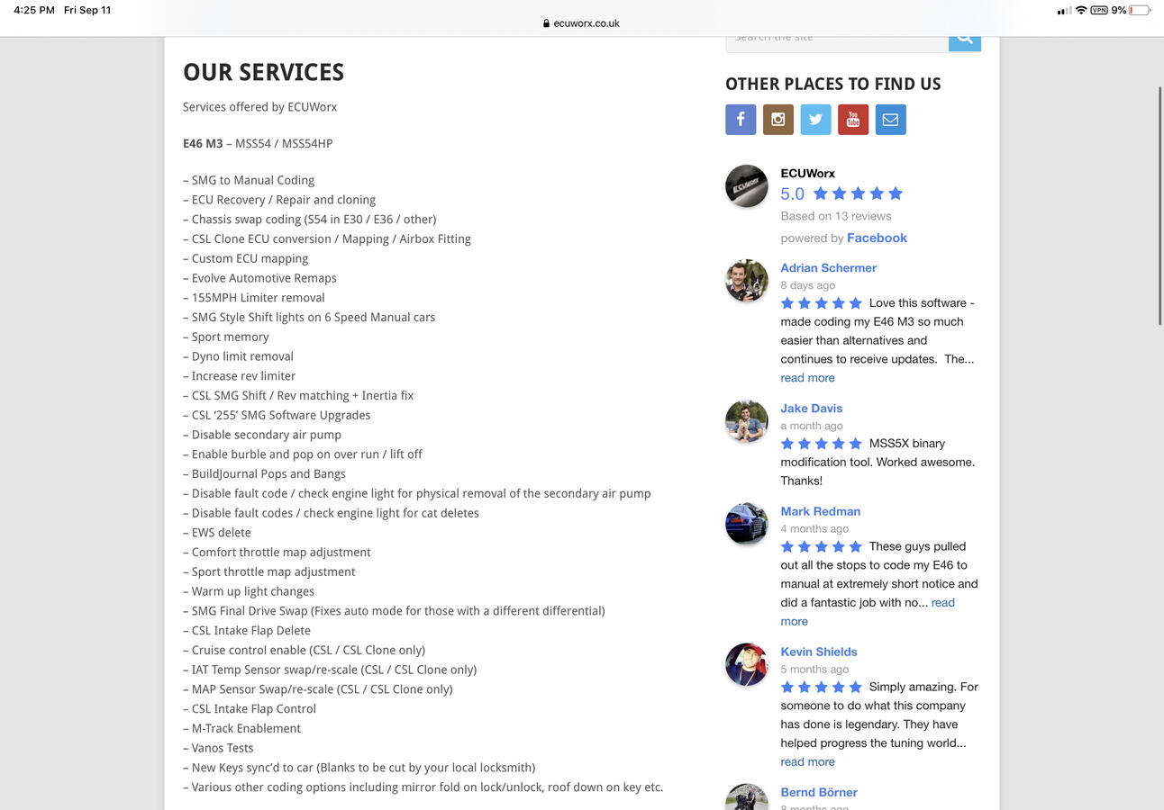

                Thanks that’s what I was looking for. For some reason, its not listed as an option on their webpage.
                  This is what you want: http://www.ecuworx.co.uk/how-to/a-ru...-what-they-do/
