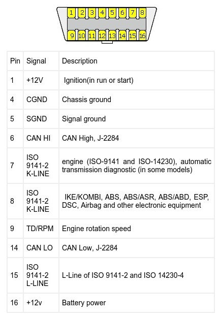

    You will need to solder pins 7 and 8 on your cable together. The engine uses k-line on pin 7 while all other systems are on pin 8.
      This.
