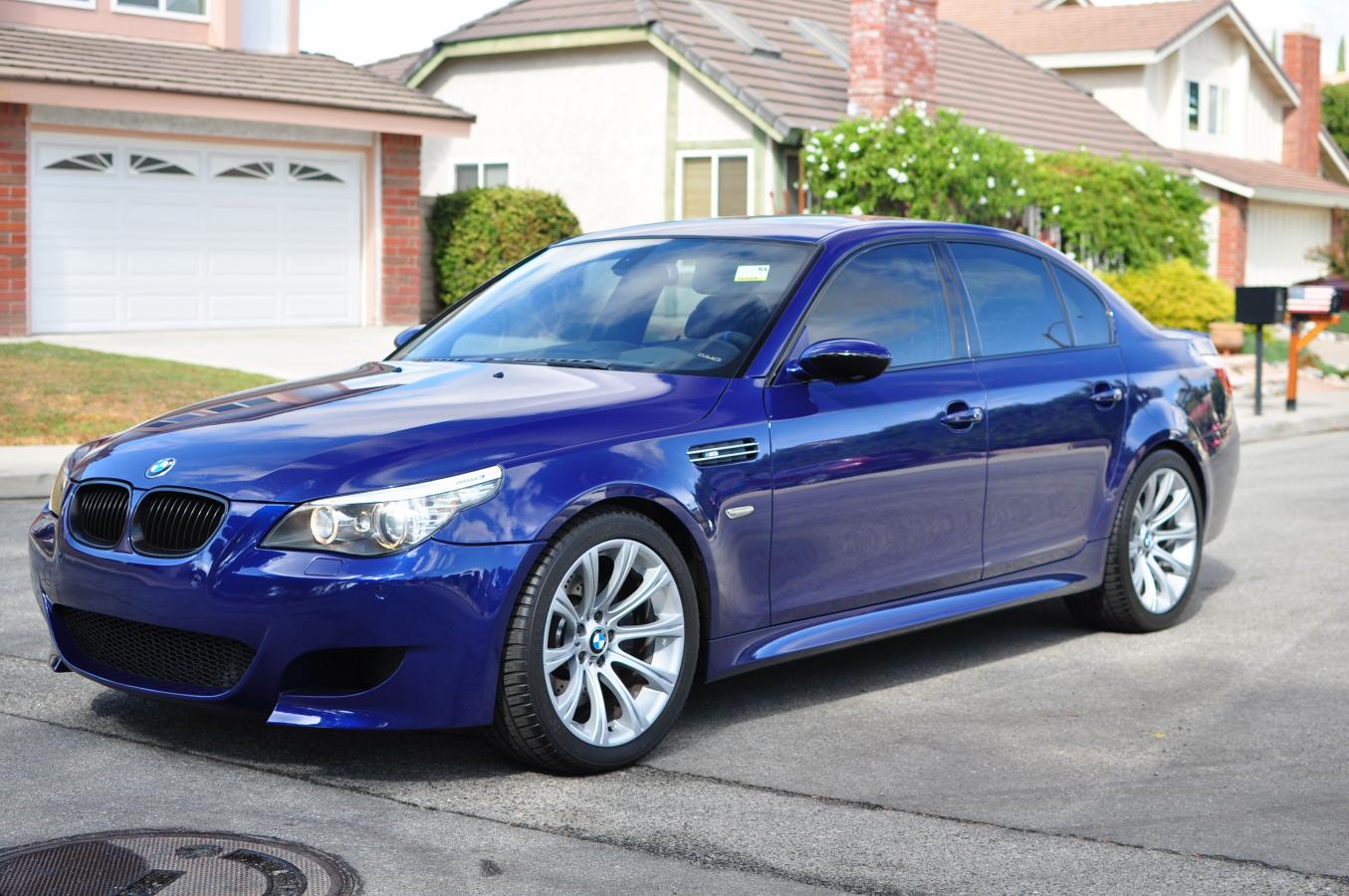

    I recently corrected my friend's 2006 M5, and took some photos that I shared on IG, but since there's a detail sub-forum, and this forum could use some more content, I figured I'd post here as well. Maybe people will see this. Or not
    Click image for larger version  Name:	E60M5day103.jpg Views:	17 Size:	114.7 KB ID:	196788
    Car has a little over 100k, and it was pretty well taken care of. He did have the front bumper resprayed, but everything else is original and there are no serious dents/clearcoat failure/defects.

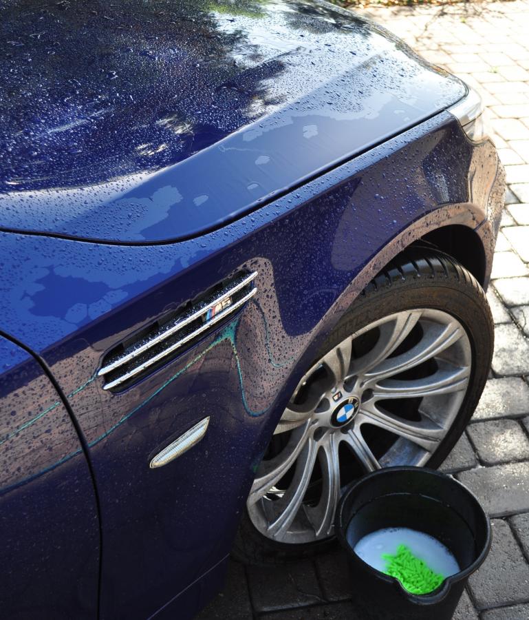

    I start with a typical car wash, but I use dish soap so as to strip anything on the paint. I used to also spray some iron-x type of decon products, but found them to be fairly useless if I plan to clay the car anyway. You can see water beading up - the car was already in good shape for its age.
    Click image for larger version  Name:	E60M5day104.jpg Views:	15 Size:	130.2 KB ID:	196789

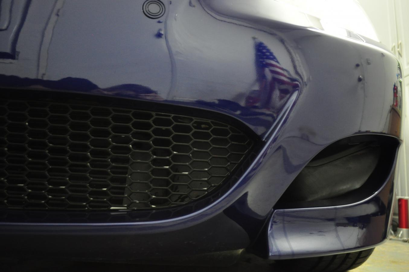

    Also, before compound/polish, I always treat all plastic/vinyl/rubber with protectant and let it soak in. Below you'll seee the front bumper where there's lot's of plastic, but also the side grilles, and all window trims.
    Click image for larger version  Name:	E60M5night16.jpg Views:	16 Size:	79.8 KB ID:	196791

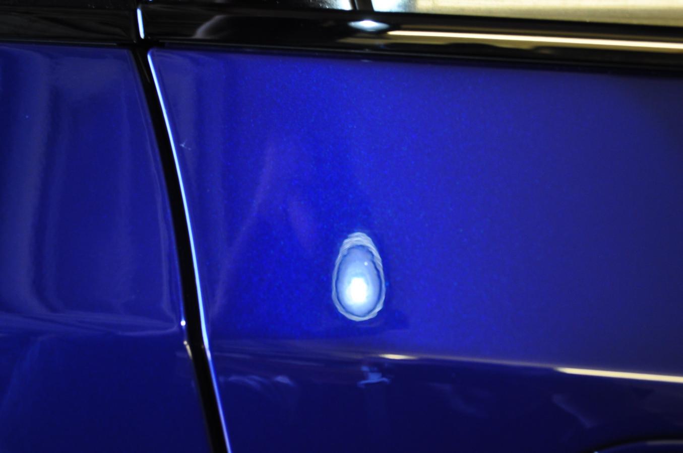

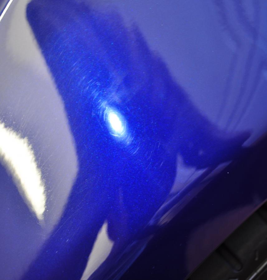

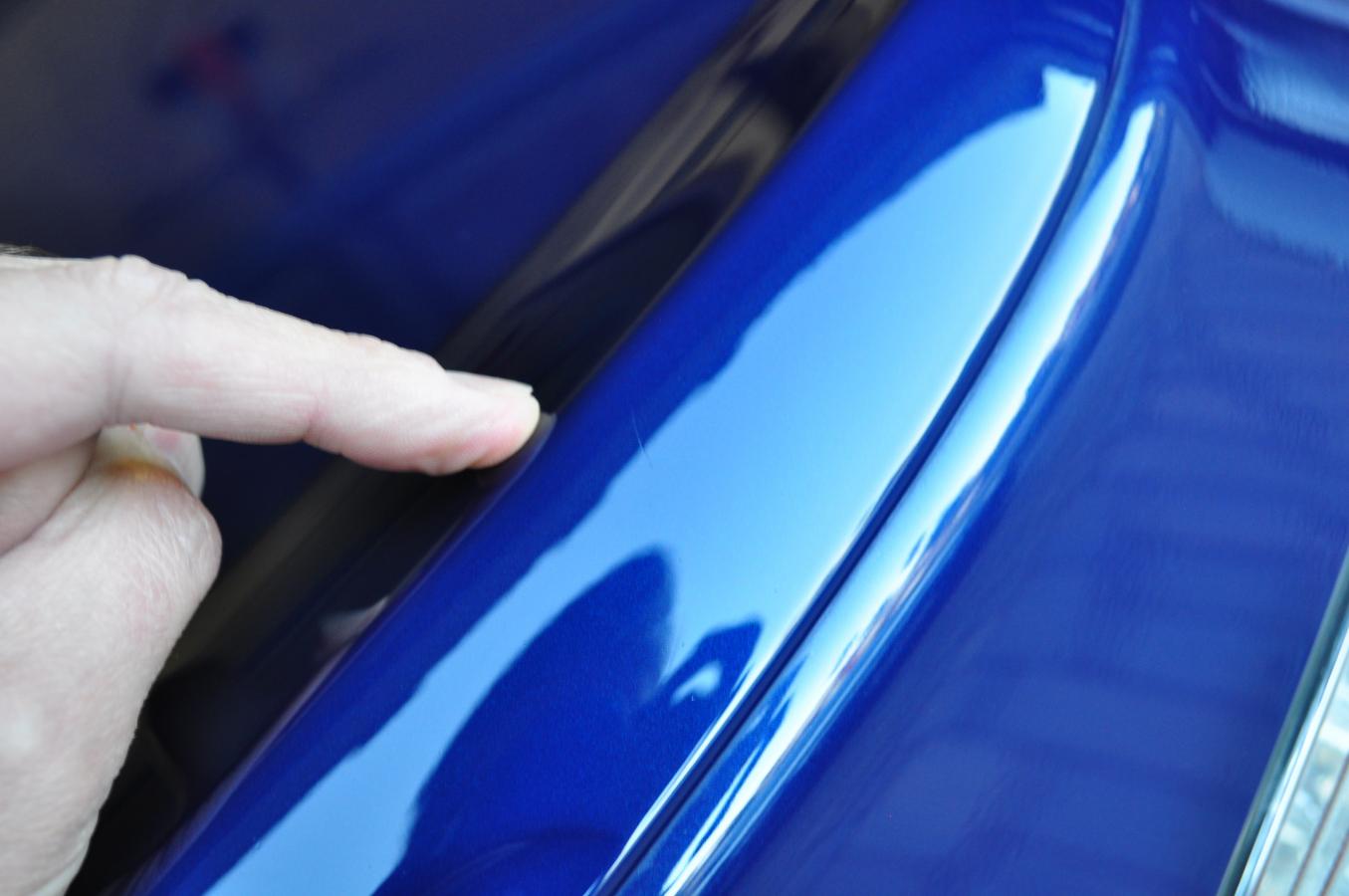

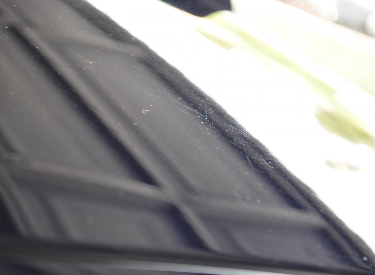

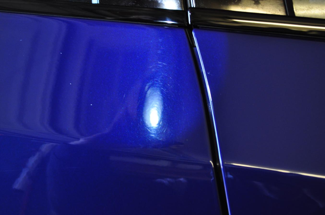

    Next, I'm going to show some BEFORE shots. Mostly, it's fine scratches/swirls, but some other marring like scuffs and waterspots/etching. All very common, and not that bad for a 2006 car.
    Click image for larger version  Name:	20221027_172005.jpg Views:	14 Size:	101.6 KB ID:	196792
    Click image for larger version  Name:	E60IBday323.jpg Views:	1 Size:	56.8 KB ID:	196834

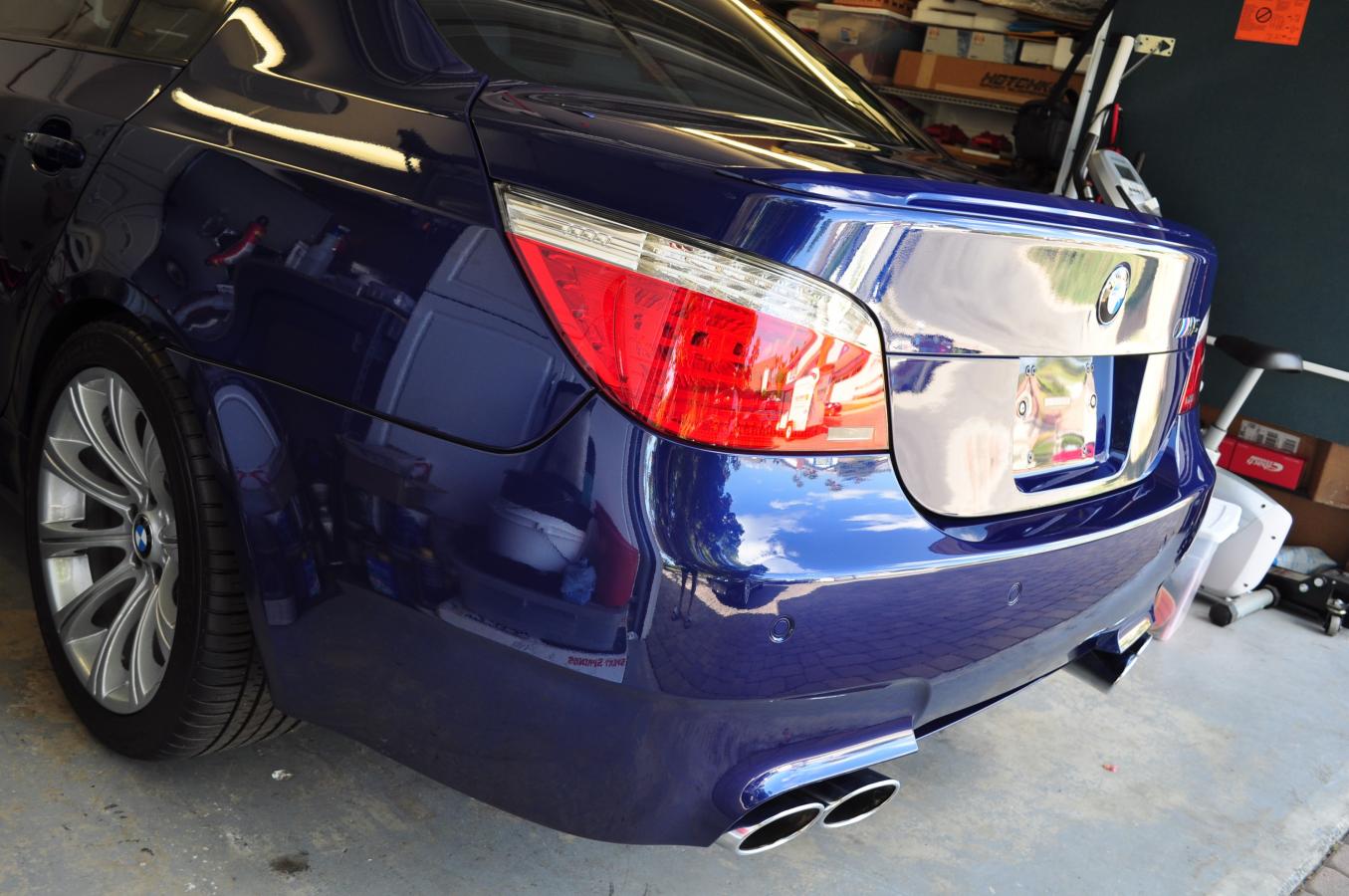

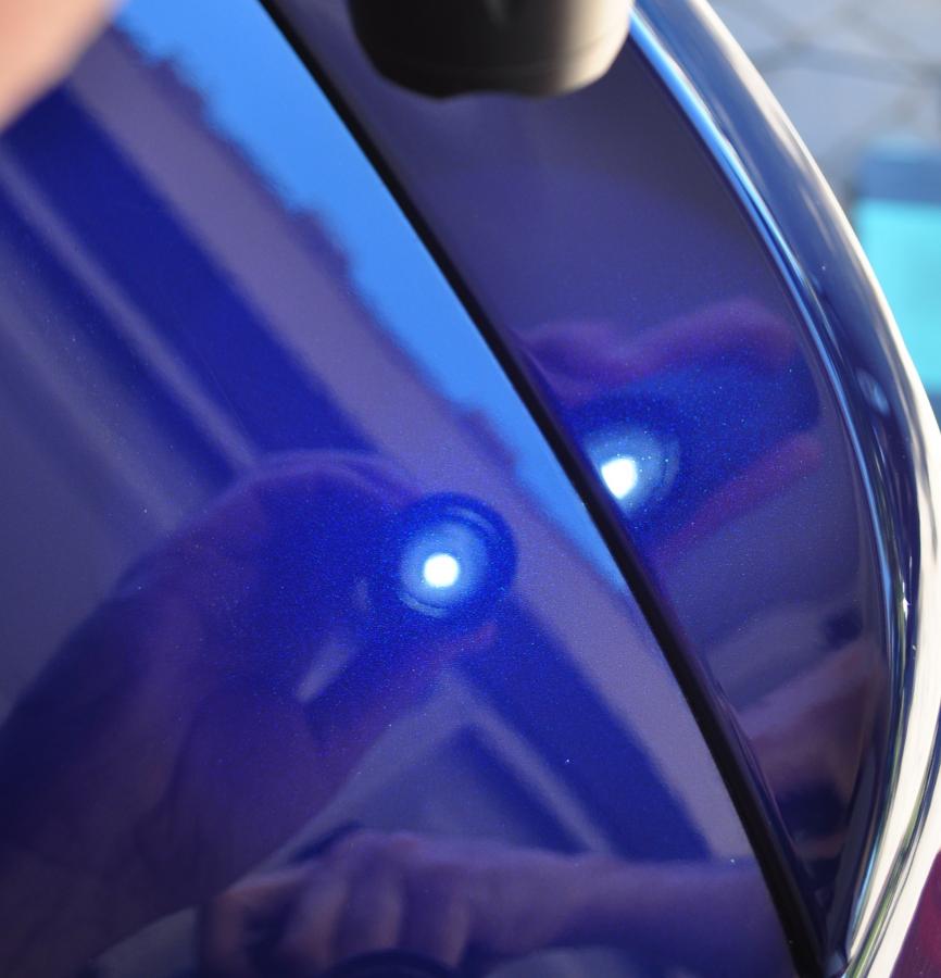

    AFTER
    Click image for larger version  Name:	E60IBday327.jpg Views:	11 Size:	51.2 KB ID:	196837

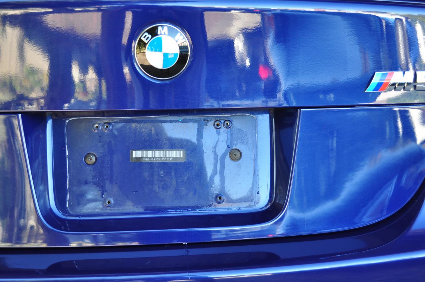

    I took the plate off, but no other body parts.
    Click image for larger version  Name:	E60M5day116.jpg Views:	0 Size:	146.9 KB ID:	196833

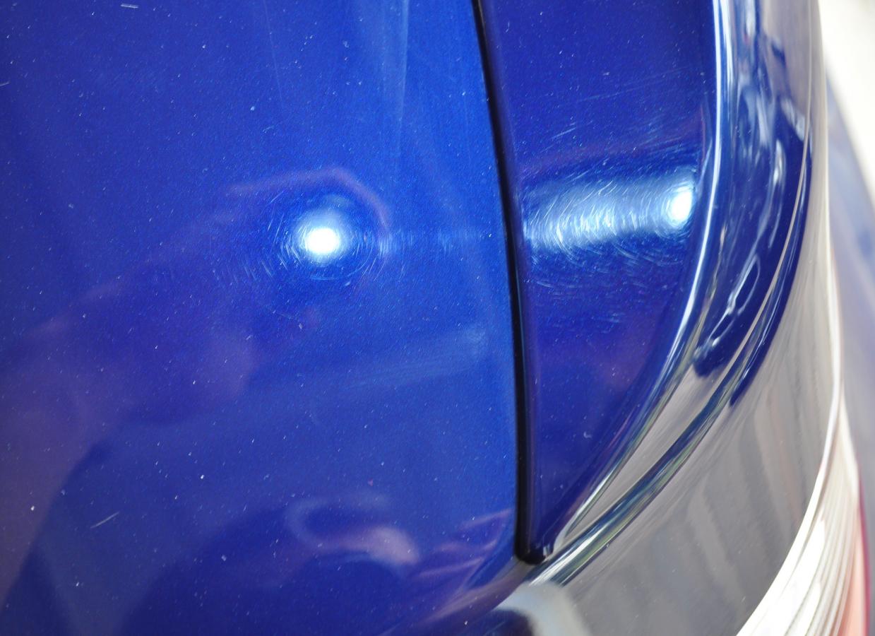

    The back was the worst. Here's a pretty bad scuff:
    Click image for larger version  Name:	20221027_171905.jpg Views:	0 Size:	41.0 KB ID:	196828
    Click image for larger version  Name:	E60M5Day238.jpg Views:	0 Size:	72.6 KB ID:	196829
    Click image for larger version  Name:	E60IBday314.jpg Views:	0 Size:	87.4 KB ID:	196880 Click image for larger version  Name:	E60IBday315.jpg Views:	0 Size:	103.3 KB ID:	196879

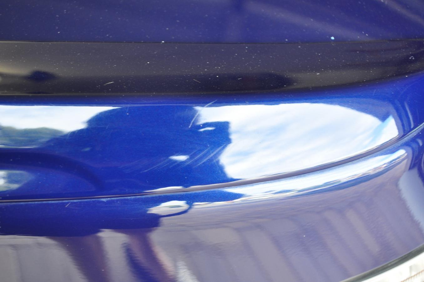

    Trunk Lid
    Click image for larger version  Name:	E60M5Day236.jpg Views:	3 Size:	112.4 KB ID:	196831
    Click image for larger version  Name:	E60IBday313.jpg Views:	0 Size:	61.5 KB ID:	196878

    All done cutting her down. I wasn't disappointed by the foam in any arears, though I did have to put more heat into a few spots to clean it up satisfactorily.
    Click image for larger version  Name:	E60M5IBPolish05.jpg Views:	0 Size:	149.8 KB ID:	196883

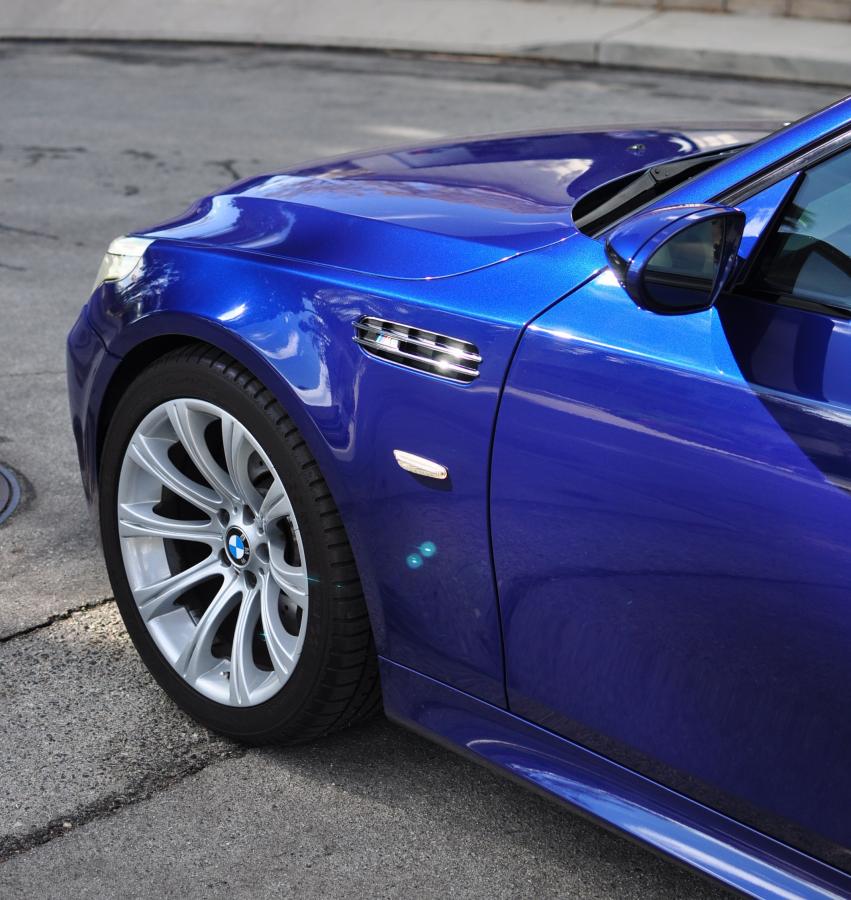

    Next I'll polish it and seal it. The following post's pics will be after a 24 hour cure of the CMX.

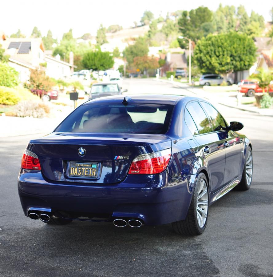

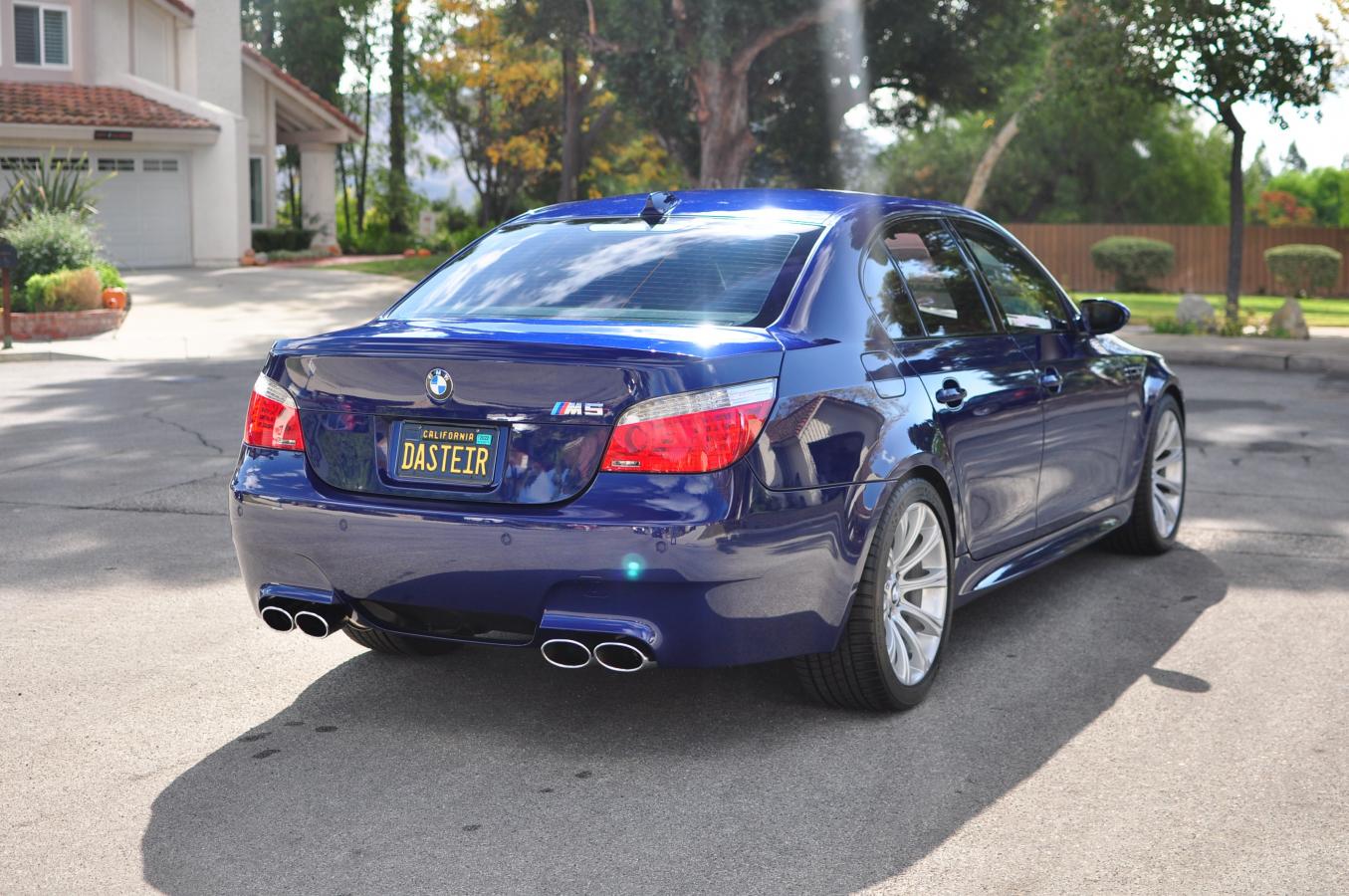

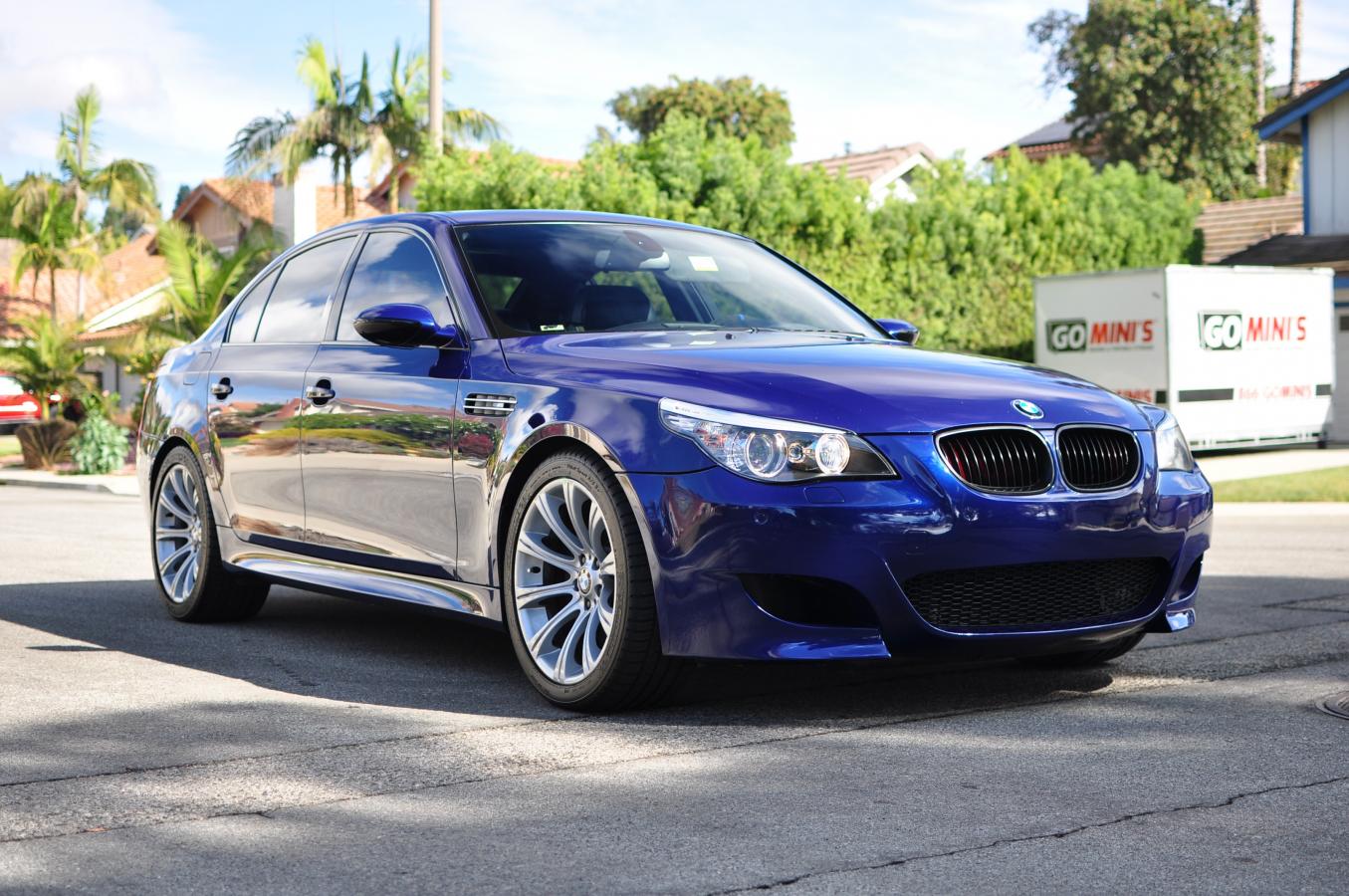

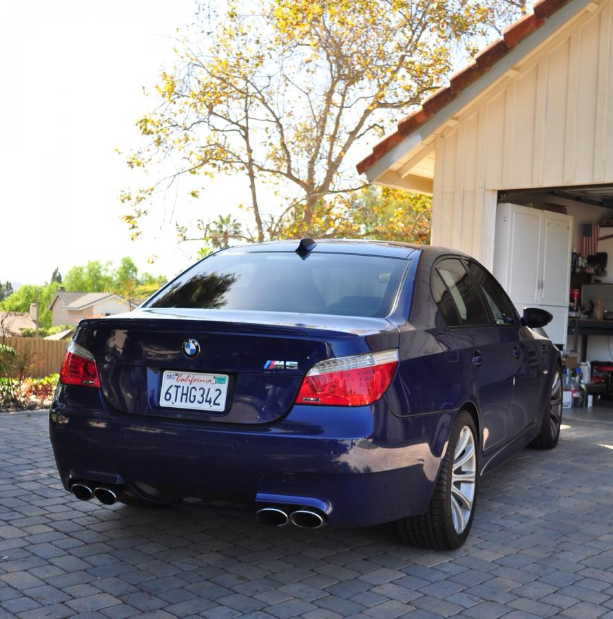

      Click image for larger version  Name:	E60M5IBShoot (44).jpg Views:	0 Size:	109.3 KB ID:	196926
      Click image for larger version  Name:	E60M5IBShoot (8).jpg Views:	0 Size:	136.5 KB ID:	196930 Click image for larger version  Name:	E60M5IBShoot (15).jpg Views:	0 Size:	60.3 KB ID:	196929
      Click image for larger version  Name:	E60M5IBShoot (1).jpg Views:	0 Size:	126.4 KB ID:	196932
      Click image for larger version  Name:	E60M5IBShoot (3).jpg Views:	0 Size:	193.3 KB ID:	196933 Click image for larger version  Name:	E60M5IBShoot (29).jpg Views:	0 Size:	117.2 KB ID:	196925
      Click image for larger version  Name:	E60M5IBShoot (39).jpg Views:	0 Size:	198.9 KB ID:	196927 Click image for larger version  Name:	E60M5IBShoot (11).jpg Views:	0 Size:	177.0 KB ID:	196931 Click image for larger version  Name:	E60M5IBShoot (48).jpg Views:	0 Size:	194.1 KB ID:	196928
      I love this ^ last one. Look at IB in the sun! Never seen it so strong of a royal blue.
      I really enjoyed this one. Always nice to work a new paint color, esp the pretty IB.
      If anyone in Socal wants this done to their car for a very reasonable price, PM me.
