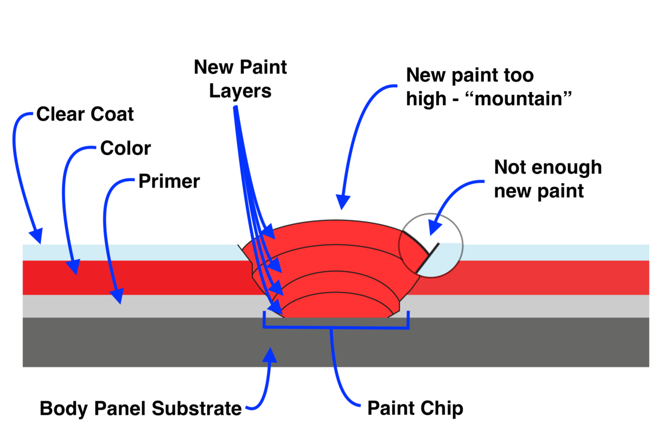

                      i've corrected chips like this before as mentioned above. You have to pile/glob up the touch up paint past & over the edges of the chip. From there you have to carefully wetsand down to where the touchup is level with the original paint......compound, polish. You can get an almost flawless result if done properly. Trick is when wetsanding to completely sand flat (i usually use an old rectangle eraser) as my 'sanding block'.
