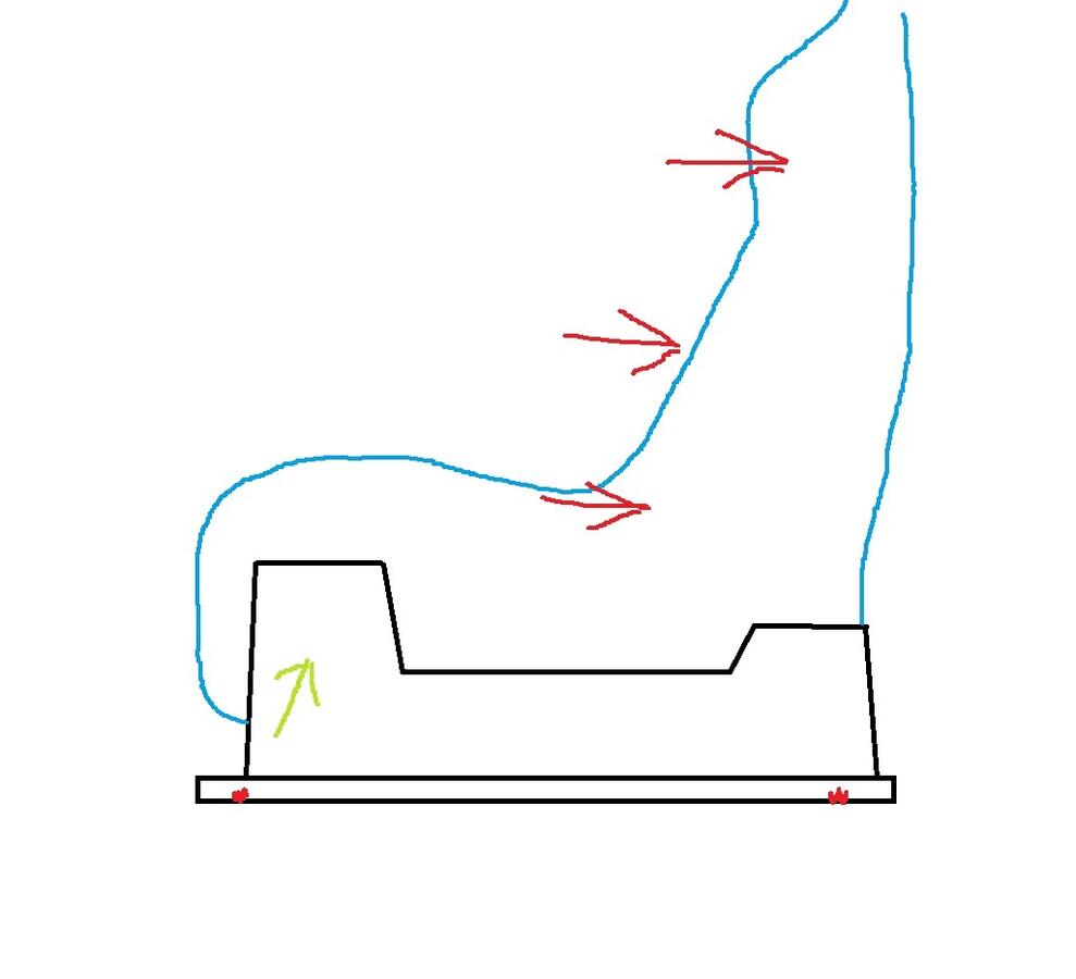

                    hello paint ahahahah
                    possible applying load during crash on the seat could be like this. and driver weight will make force much higher, that your floor mounts level. so, to the floor mounts, load would come with different direction.
                    i will not draw side impact load, cause it will looks similar to the back impact, with changed direction only.
