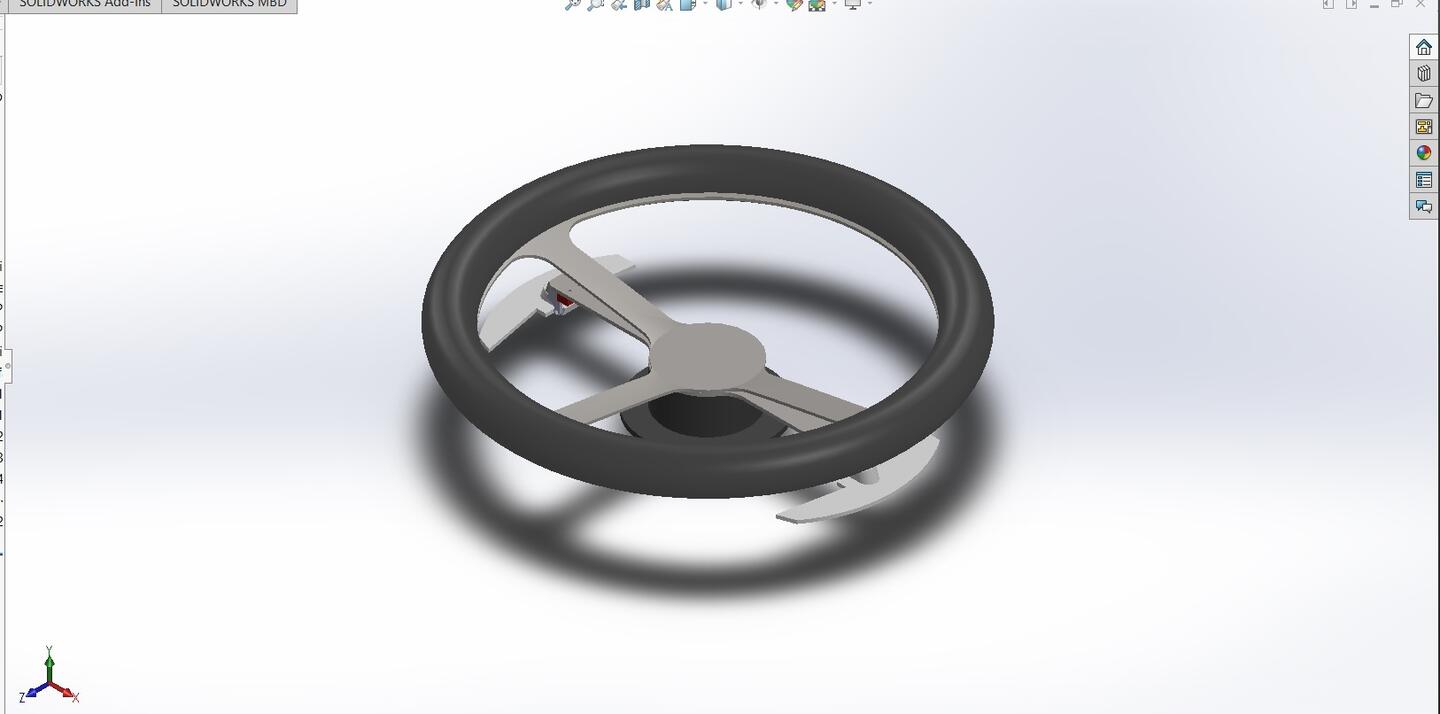

        Does anyone want to guess what I'm up to?

          Steering wheel quick disconnect for smg/paddles.
            Yup.

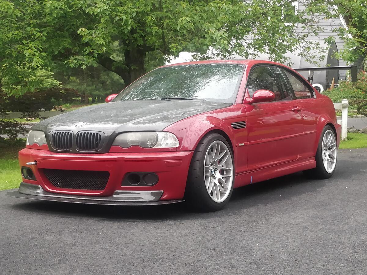

                Now the set back I mentioned. I am a blithering idiot. After cutting the pieces for the paddles at MT Fab, I forgot to latch my hood. Yes, yes, I'm still kicking myself. Rookie move. I felt pretty stupid about it but luckily my brand new windshield didn't crack. The hood that I have countless hours into getting just right, is toast 😥. The sunroof panel was hit hard enough that it started leaking water (flex seal tape to the rescue!). That same week I found a "carbon" hood. Why the quotes, because 1, I hate carbon hoods, 2, bullshit on them being carbon, almost all of them are fiberglass with one layer of carbon on top. It looks great if you are into that sort of thing. I am not into that sort of thing, but here it is on my car anyway. I don't know if I'll keep this hood. I put the stock hood latch setup back on the car so I didn't make any holes in this hood bc frankly I'd prefer to find a stock Imola hood at some point and put that on the car with some cut outs. And before anyone says "aerocatch latches bro"... I don't like them. But I ordered them anyway and have them already lol. So whenever I decide to put latches back on whatever hood I decide to keep, I'll figure out if I want to use the latches I had on the old hood or go ahead with the aerocatch version. For now, whatever, I just want to get on track.
                Click image for larger version  Name:	IMG_20200603_123757.jpg Views:	0 Size:	216.5 KB ID:	32185
                The fitment is actually really good, but I mounted it with the back end of the hood lifted a bit (kinda like civics and the ricers do) so more air can be extracted from underhood.

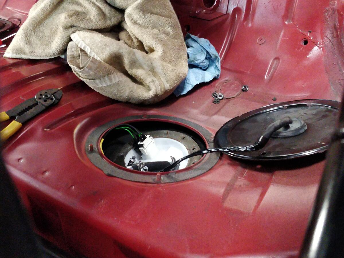

                              Updates: The first track day pointed out a few weak points. First, I didn't even get close to half tank before hitting fuel starve coming out of right hand corners. Being that I'd burn 1/4 tank of gas in one session and I hit fuel starve at the beginning of the second session, I definitely needed to fix this one. In goes the bimmerworld e36 pump to feed the bucket on the stock pump.

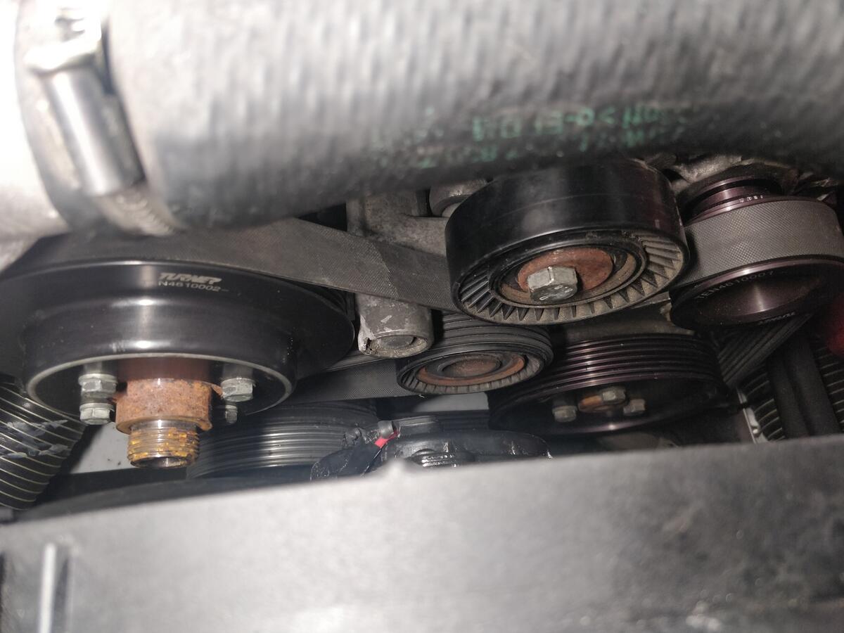

                              Next issue is cooling. The water temp didn't get too hot, but the oil temp, yeeaahh. I was shifting at 7k all day long and holding higher gears just to keep the oil temps in check. The second I ran the gear I wanted to run, oil temp quickly climbed to around 275* before I took measures to cool it again.
                              So, If oil temps are that hot, we need to cool everything down, including water temp. I've had these turner underdrive pulleys sitting around for a while, so I toss them on. Should keep PS and alternator temps a few degrees cooler by not spinning them as fast and allow the water pump to work in a more efficient range.
