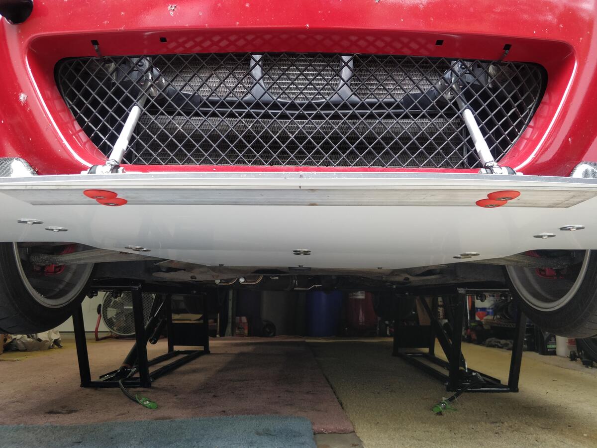

              Did a few events. Been having fun but also breaking shit. I'm highly not impressed with the Hard Motorsports splitter setup. It is shown over and over again with no splitter rods. Welp, at 140mph that wasn't happening. I heard it flapping away, pulled off. Damn thing was smiling at me. LOL
              Okay okay, I really should have known better. So I pulled the splitter off and ran the rest of the day with out. It definitely affected handling but meh, still fun:
              Best of the day was a 1:11x or 1:12x or something. Not too bad. That is on the AR1s.

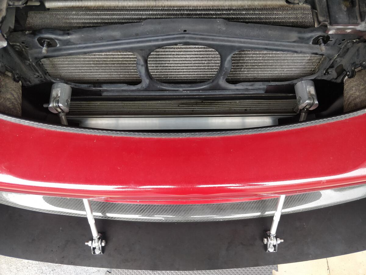

              Anyway, made my own splitter rods and attachments and whatnot:

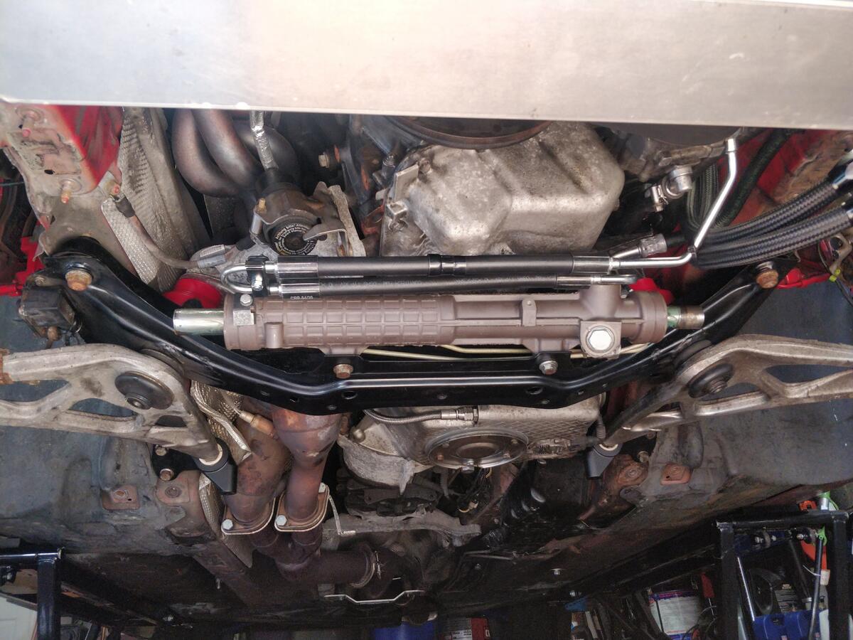

                "while i'm in there"....
                New rack, new lines, new PS reservoir, new inners, outers and boots. 80a engine and trans mounts. Clean and paint the subframe, etc

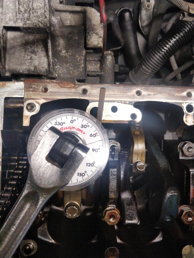

                Also did some of these

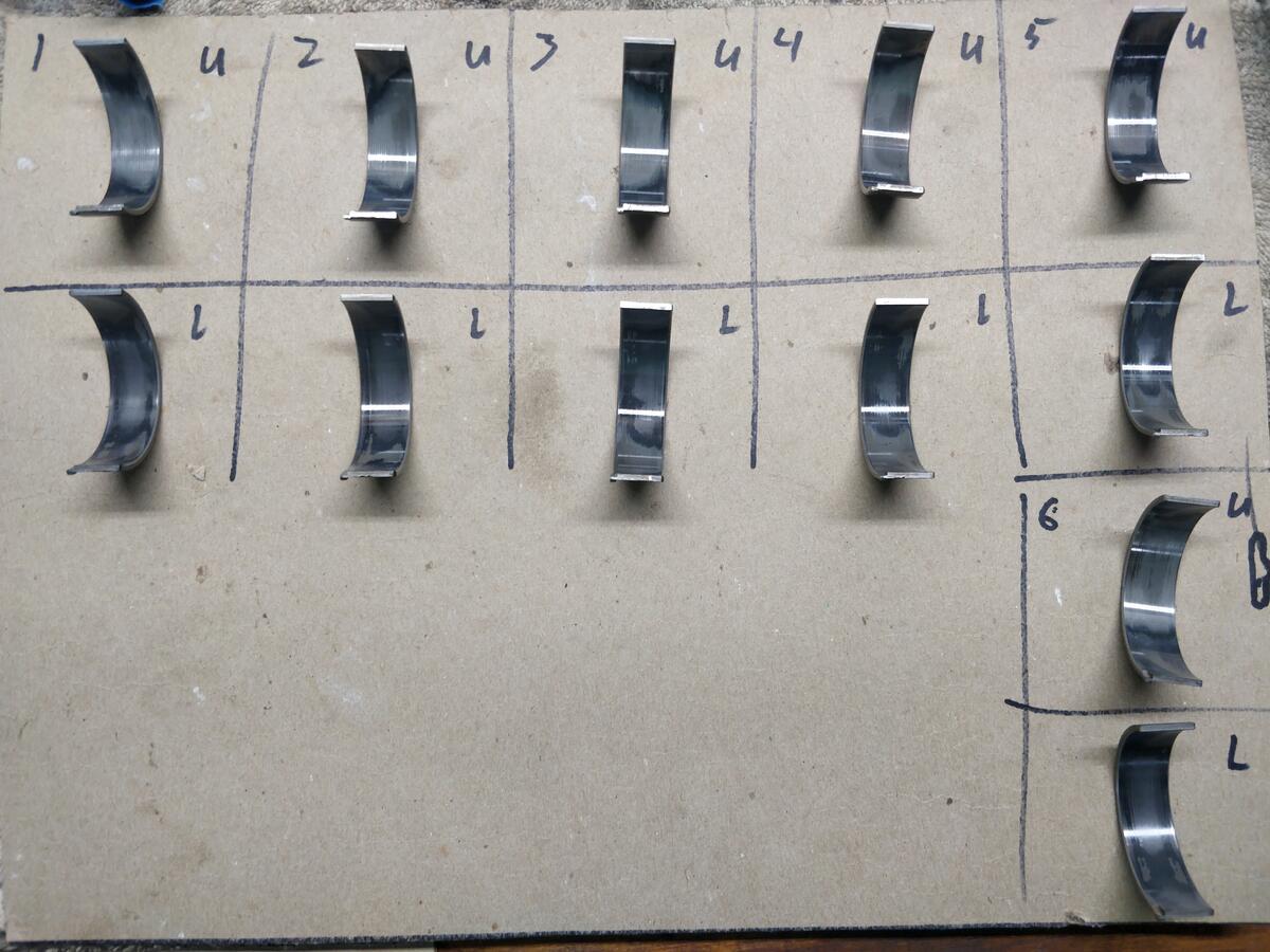

                I don't know at what mileage, because I never cared to look it up, but this car definitely had the bearing recall done at some point. At 116k miles now, 3 of the uppers were showing a tiny bit of copper. Luckily for me this engine has clearly been well maintained all it's life and had proper oil changes, evident by the color of the oil 'stains' in the pan and other key areas.

                  Yeah...there is a learning curve with the splitter. I've finally stopped raping the splitter in the paddock over bumps and getting it on the trailer. My last plywood splitter has been holding up!
                  I mounted the splitter rods to the same location as yours. I've found that the reinforcement will flex quite a bit so I'm moving the rods to mount to the bottom of the kevlar bumper support. If you mount close to where the reinforcement bolts to the frame...it seems like there's less movement.
                    #39
                    I've noticed this as well. Not overly concerned for now but figure I'll mount a camera at some point to see just how much deflection there is.

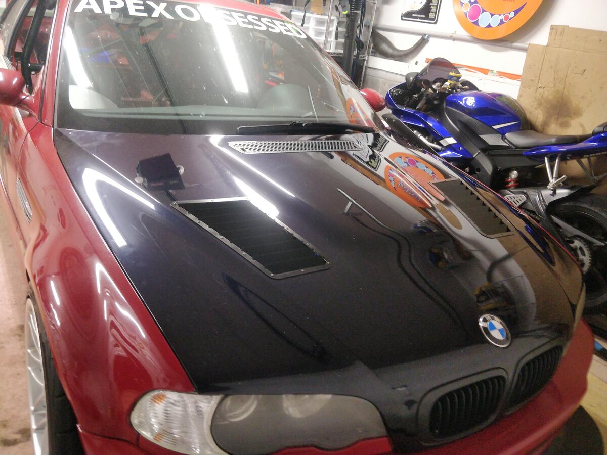

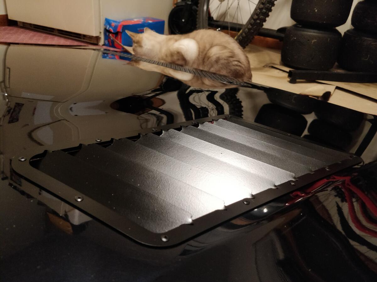

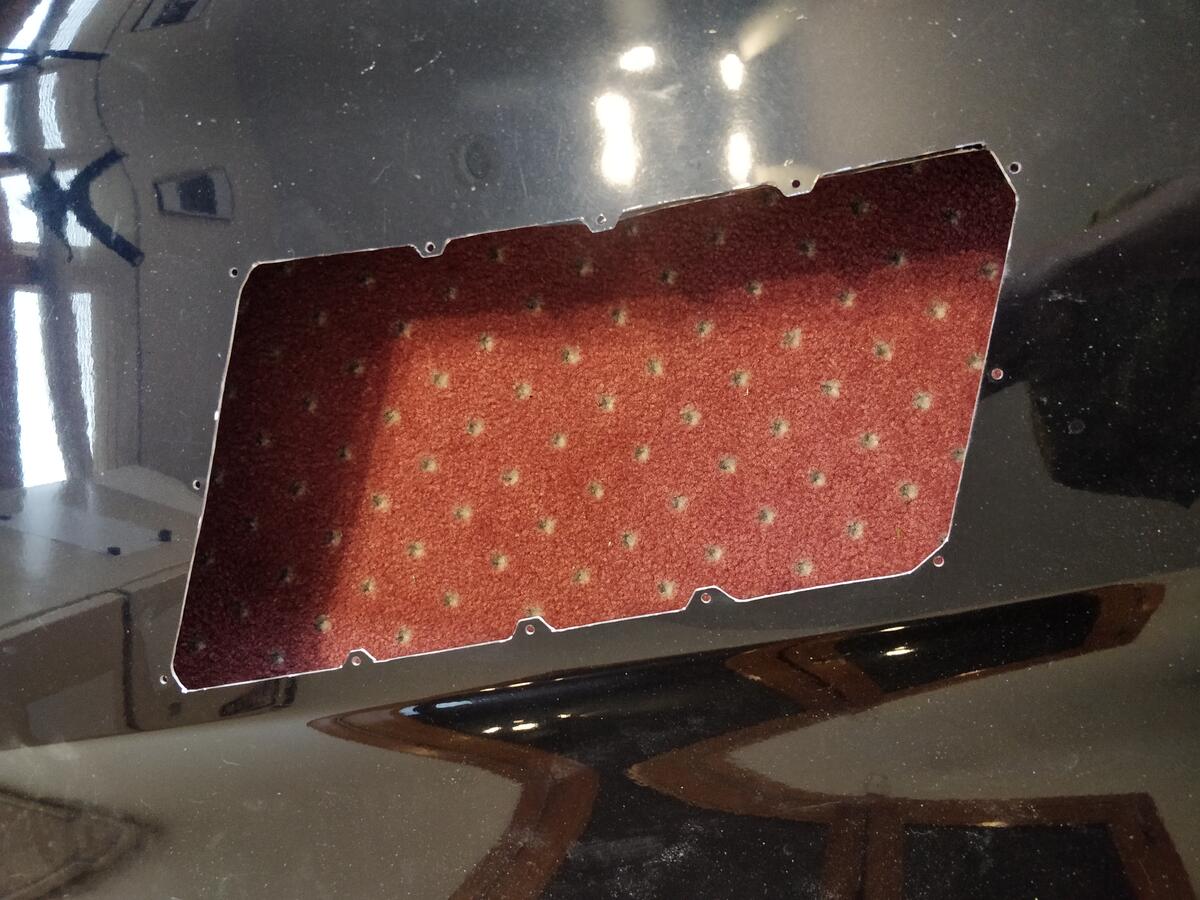

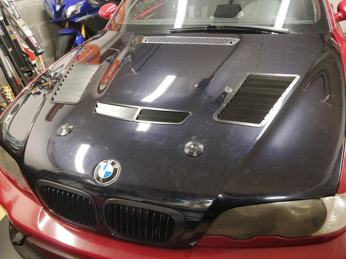

                      Small update. I picked up a stock faded black hood, got the N15 vents from Lawrence who is an awesome dude and installed. I liked the side vents so much I ordered the front vent as well, but haven't installed it as the car is buried in snow right now.

                        The N15 vents are great! A plus when you support of fellow long time forum contributor while getting some value in return.

                          I owe this thread a small update. I've finished the hood with the addition of the front vent and some hood latches, with retaining the stock latches too. Click image for larger version  Name:	IMG_20210324_201120.jpg Views:	0 Size:	137.4 KB ID:	112257

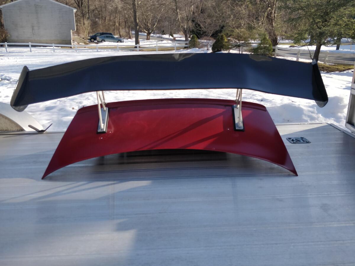

                          I've also switch to a smaller rear wing. I had the Snead Speed wing sitting on my shelf already. The 9lives wang is great, but man it is huge. Since the car had a hint of mid corner push at high speed corners, I decided to try the smaller SS wing. So far, I'm liking it. Picked up a few MPH and the balance is better.
                          Click image for larger version  Name:	IMG_20210309_155833.jpg Views:	0 Size:	102.1 KB ID:	112258

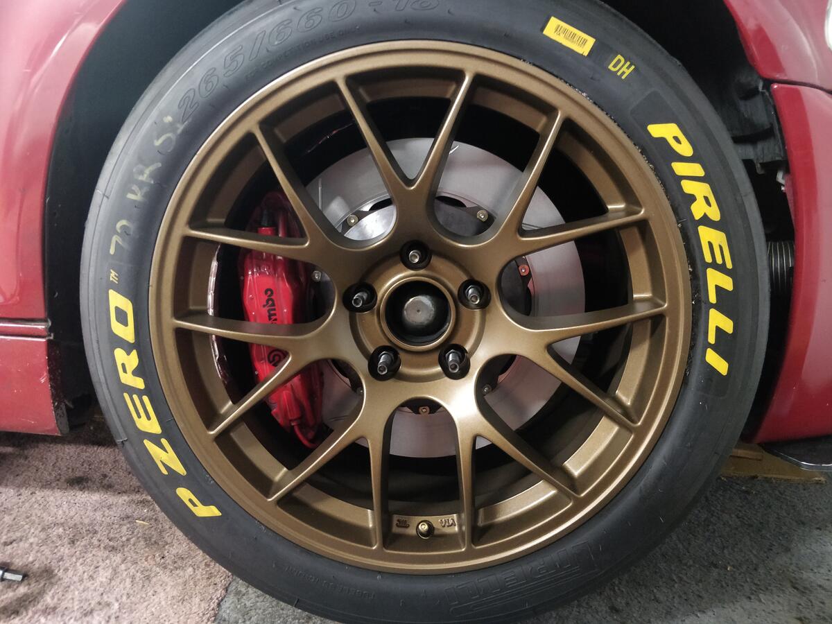

                                Not too much new stuff going on with the car but I have been tracking it as much as I can during this very busy summer. I noticed some cracks forming on the original brembo front rotors so I replaced them with some girodisc rings. Mounted up some pirelli DH take offs I got for cheap. The sidewall height was a little higher than stock/ideal but meh, they worked amazingly well. Dropped my time vs the AR-1s by about 3% and there is more left in them as I figured out what pressures to run and how they liked to be driven.

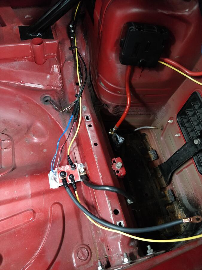

                                There is another thread floating around about these that I posted in with more detail but I installed a CarTek GT battery isolator.

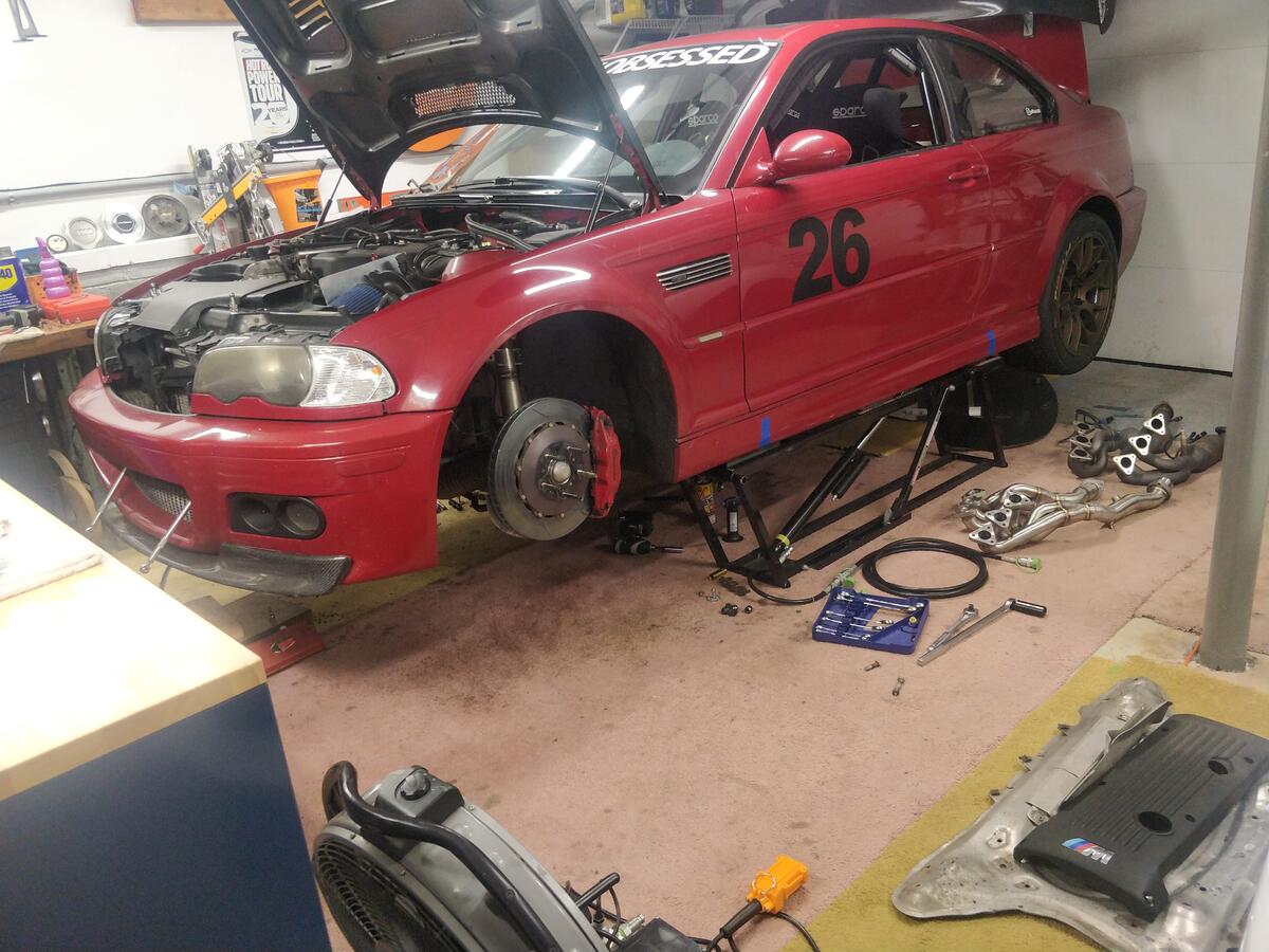

                                And literally how the car sits right now as I wait for some exhaust studs to show up:
