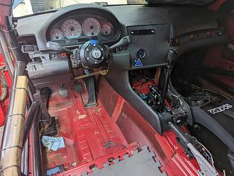

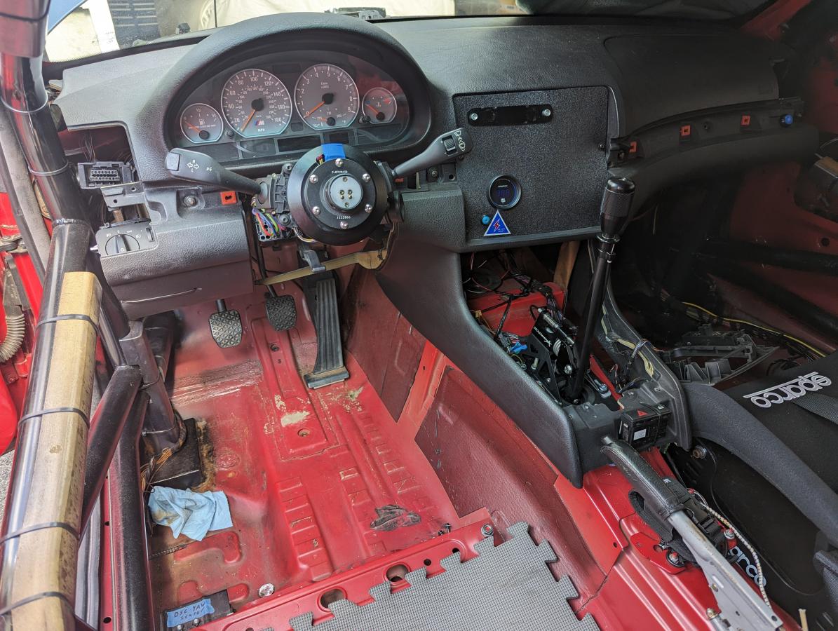

                  The car has 3 pedals and a stick thingy in the middle now. I really didn't take shit for pics while doing this. Honestly I just knuckled up and enjoyed doing the work, not focus on documenting super well. It was really nice.

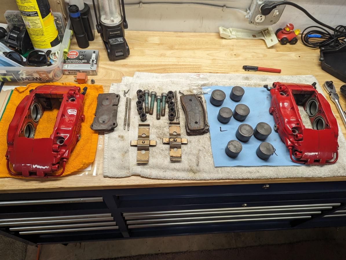

                  I also rebuilt the front brakes.

                    I don't think anyone reads this thread anymore but I'll still toss an update in every now and then. I used the coolerworx shifter and it's damn good. I had a buddy drive the car and he loved it as well. He has a sequential in his e46m now but yeah, he loved the feel of my setup.
