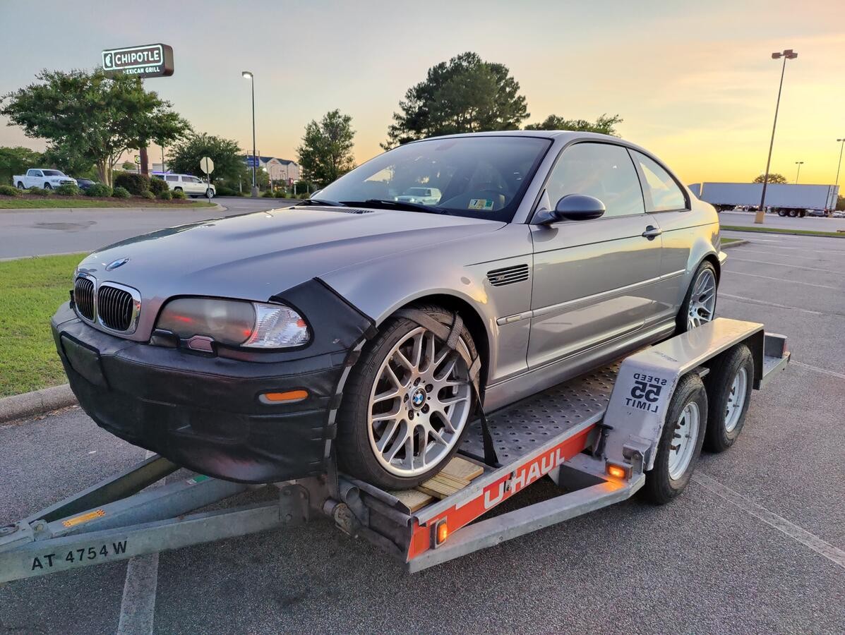

      I used a Uhaul trailer for when I bought my car in NC and drove it back to GA. I used some wood to clear the front lip of the trailer and it does come with straps that go around the front wheels.
      The car was also stock height at the time.
      Click image for larger version  Name:	image_25751.jpg Views:	0 Size:	269.7 KB ID:	166541
        How was the clearance with the trailer ramps when loading up the car?
        That picture helped a lot, thank you! The front mask/bra is a good idea.

              It was pretty tight, I used the slope of a driveway to reduce the angle of the ramps which drastically helped.

                    I have used uhaul several times to haul my M and my lowered e46 race car. They work fine of you follow their instructions for hauling low cars:
                    Stack a 5 foot and a 3 foot board under the ramps driving onto the trailer so you don't rip off the bottom of your car and place an 18 inch board under the front tires on the trailer to avoid destroying your front bumper.
                    Easy breezy. Their inexpensive well maintained, and you don't need a place to park them.
                      I had to do the same as Sid. Measure some wood out to for the front tires to sit in nicely.

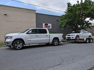

                        I thought I'd update this thread. I used these U-haul trailers three times last year, with mixed results.
                        You will definitely need some pieces of wood.
                        - For the front wheels, you will likely need 6 pieces. Most trailers will have front tire stops, which my front bumper would not clear without being lifted up.
                        For each side, two will go under the front wheel, and one to clear the wheel net mount.
                        The two pieces under the front tire should be 2x12's, 18" long. One of those should have a bevel on edge to make it easier to drive up.
                        The third piece is also 2x12, length can vary. Also should have a bevel.
                        - For the rear, you can use Race Ramps. Another option is two 2x10 or 2x12 per side, which will go under the ramps.
                        As mentioned in an earlier post, there is a raised spine on both sides of the open area. It is high enough to catch the bottom of the car. Sometimes this spine will be squished down by someone else, but not always.
                        My experiences:
                        1. First trailer was by far in the best condition. No complaints with this one.
                        2. Second trailer had a front tire strap ratchet that kept skipping. Glad I didn't bash my hand or head when it happened.
                        It also had a crappy tongue jack that took a lot of effort to drop down once it was carrying any weight. Of course we had 98 deg blazing hot weather that weekend.
                        3. Third trailer was the worst. The ball coupler was a total POS.
                        The ball coupler is threaded (not a latch like most trailers), so to tighten it on the ball, you need to spin a knob down. Well, on this last trailer, the threads were damaged, so the coupler seemed it was fully tightened, but it really wasn't.
                        When I was loading the car, the coupler popped off and it banged into my tailgate. Fortunately Ram puts an obnoxiously large logo on the tailgate, so it got a small mark, rather than a large dent in sheetmetal.
                        I think the newest Uhaul trailers now have Demco couplers, but I haven't seen one in person yet.
                        Also one of the tires had a slow leak, which might not be their fault, but I'm going to blame them anyway because I'm still pissed about this trailer.
                        And to top it all off, I had to wait 45 minutes in line to pick up the trailer (even with a reservation), as it was the end of the month and a lot of people were moving.

                        I bought a spare 4 way trailer harness. If it was missing, I had been able to grab one from another trailer at the yard, but I didn't want to depend on this. The U-Hauls around here are always short staffed, and I hate waiting around.
                        One fairly big downside with these trailers is tongue weight. Because of how the car is strapped down, you cannot reposition of the car to adjust the tongue weight, and it ends up putting too much weight on the tongue.
                        Ram trucks can't tolerate much payload (coil springs rather than leaf), but the rear would sag because the tongue weight is way too high, especially considering how light this load is.
                        I had to put as much weight (tools, jack, popup, etc) as possible in the trunk of the car to help reduce the sagging.
                        I said I didn't want to, but I ended up buying my own trailer. That last experience was a deal breaker.
                        I found a storage place about a hour away with a tolerable but still (IMO) unreasonable rental rate where I'll leave it.​
                        These trailers may have been better in the past, but with recent staffing shortages, quality and maintenance has definitely slipped.
                        I would say U-Haul trailers are ok no more than twice in your lifetime, but otherwise you are better off bringing your own trailer.

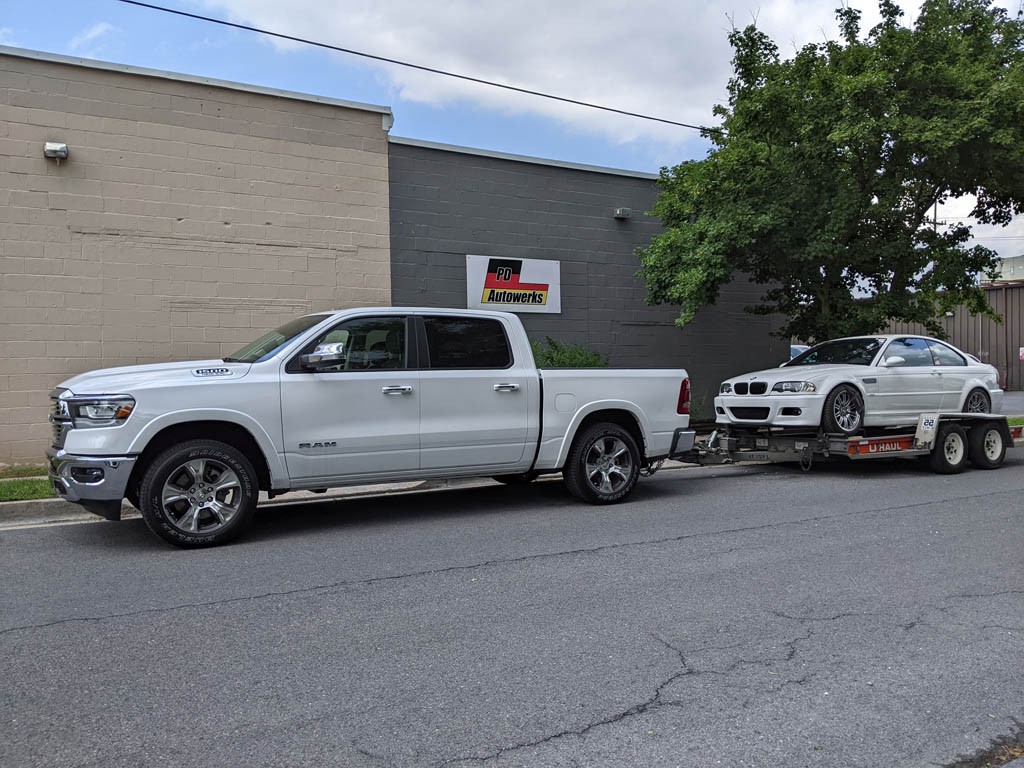

                          My experiences:
                          Comments:

                          The best strategy to make loading easier is to put the trailer tires in a low spot.
                            U-haul trailers are super heavy and if you strap the car with front wheels against the stopper, it shift a lot of weight on the tongue.
                            Last time I rent one, the car was so low that I wasn’t able to get the wheels to the stoppers even with 2x10 under the wheels. So I strap it a bit readward. Honestly, it distributed the weight way better and towing with my X3 M40i was a like a walk in the park! The X3 M40i towed way better than my wife 2019 Toyota Highlander that has a higher toying capacity.
                              Putting the car rearward would definitely help with tongue weight. I just assumed the car had to be all the way forward because of their tire nets.
                              You should post some close up photos of how you attached the straps (if you have them). Too late for me but It would help others.
