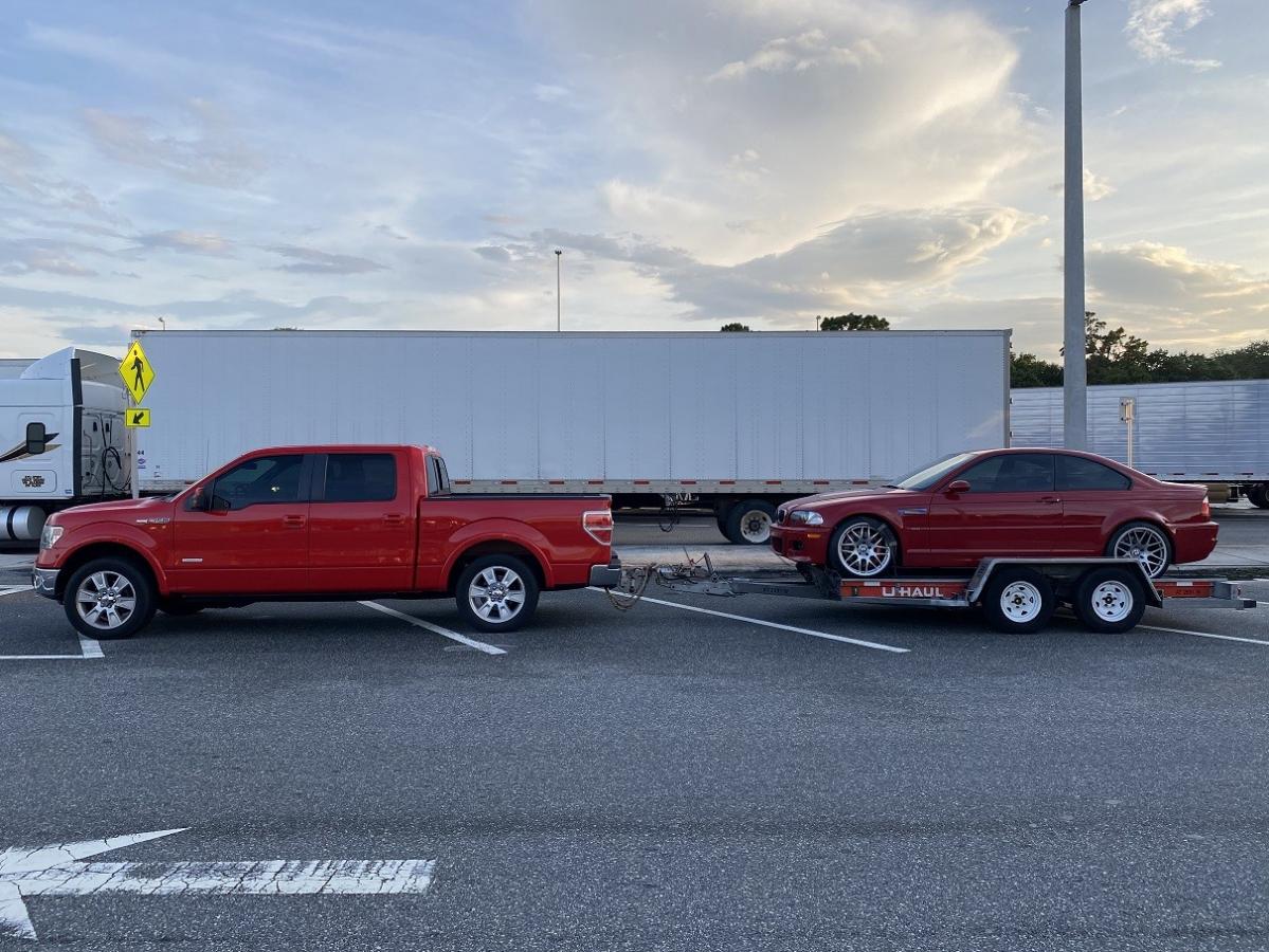

    I was using my own 10000lbs tow straps, you can’t use the one on the trailer if wheels aren’t against the wheels stoppers.

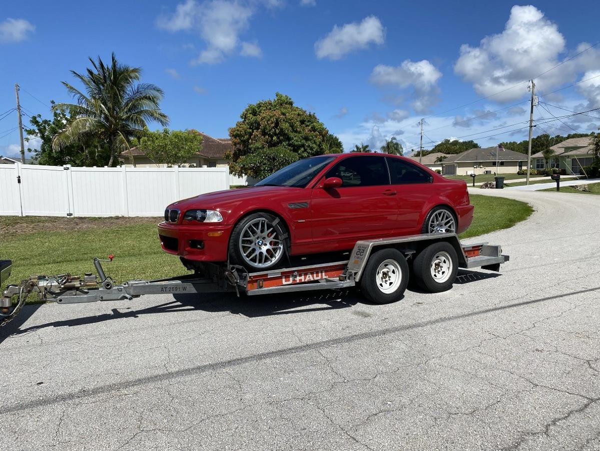

          I used a U-Haul Auto Transport twice last year. I had to put some wood blocks under the front tires to clear the front lip, but didn't have any issues otherwise. Click image for larger version

            I throw in another vote of 'YES' for using these trailers. I towed with a 5.7 Tundra, 500 mile round trip to VIR. Recommendations:
            1) inspect the trailer at pickup for tire pressure and functional tie-down strap ratchets.
            2) cut some 2x10 wood blocks to lift the front tires over the front lip. I needed about 2.5" of lift up, which required a plywood layer on top of the 2x10
            3) if your car is lowered or has aero, you may need a solution like Race Ramps. I bought the BTI-RR-TR-6​ because I plan to purchase a trailer eventually and will likely need them. If you need race ramps - you will also need wheel chocks for the trailer to keep it from shifting forward/backward when loading the car.
            These trailers handle typical highway speeds and have supplemental brakes.
