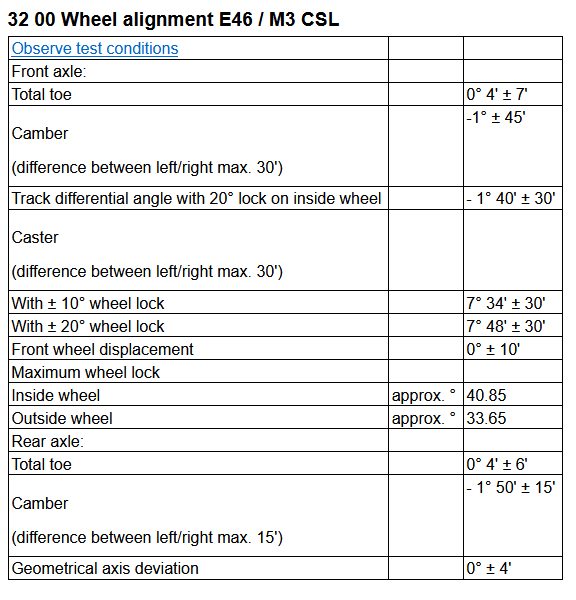

          The street alignment I’ve settled on after a few iterations, starting from CSL settings and modeling my car’s roll to achieve ~ even camber F/R is the following:
          Alignment, use CSL specs-ish:
          Front camber: 2.3 deg
          Front total toe: .06 deg, 3.5’
          Front Caster: 7.6 deg
          Rear camber: 1.5 deg
          Rear total toe: .16 deg, 9.3’
          CSL VIN: WBSBL95000JB98713 (for the alignment machine to be more green)
          CSL factory spec:

              heinzboehmer that camber tool is cool.
              I second Heinz’s suggestion to set & mark either street or track alignment (whatever your preference) and then move the camber plates over and re-measure toe on the rack. That’s less work than modeling the suspension in 3D honestly.

              Thanks. I’ll have a look at the CSL specs, as well as what you run, to come up with a nice spec for my needs. I didn’t realize the CSL uses less toe in the rear compared to standard M3. I always thought more toe in was better for the track.

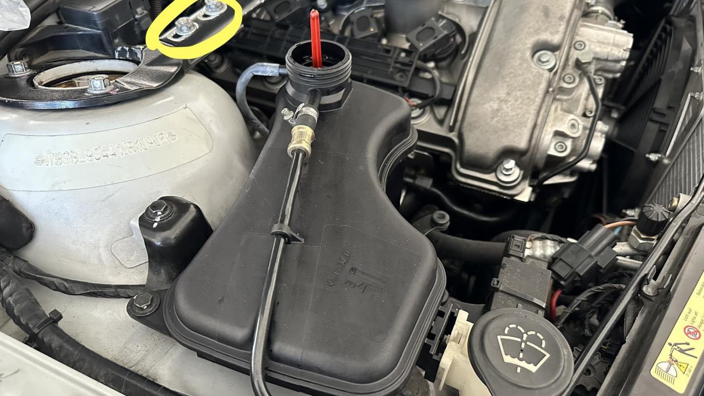

                  1. Push studs all the way in, then exclusively use the movement in the camber plate to adjust.
                  So it looks like if I push the studs all the way in while the car is in the air, the strut bar gets locked in place. I can’t remove the bar while the car is on the ground due to the four bracket studs pushing in on the bar’s slots. Should I push them in all the way while the car is on the ground instead? Or push out all the way?
                  997.1 GT3 Carrara White/“Special Leather Black”
                  C43 AMG Diamond Silver/Red​
                    Weird. Stock strut bar? If so, loosen the nuts from the shock tower mounts to the bar. That should give you enough clearance.
                      Yup, stock bar. I meant that the studs on the mounts are pushing in against the bar itself (yellow circle). The bar is actually stuck to the mounts due to the force against the studs, while the car is on the ground.
                      Click image for larger version  Name:	B6DC4BF0-C928-44FC-B782-405C844876F7.jpg Views:	0 Size:	159.3 KB ID:	218208
                      I think just keeping the brackets in the middle and using a camber gauge to set camber is prob going to be the better option. Obioban How do you go about switching between street and track camber?
