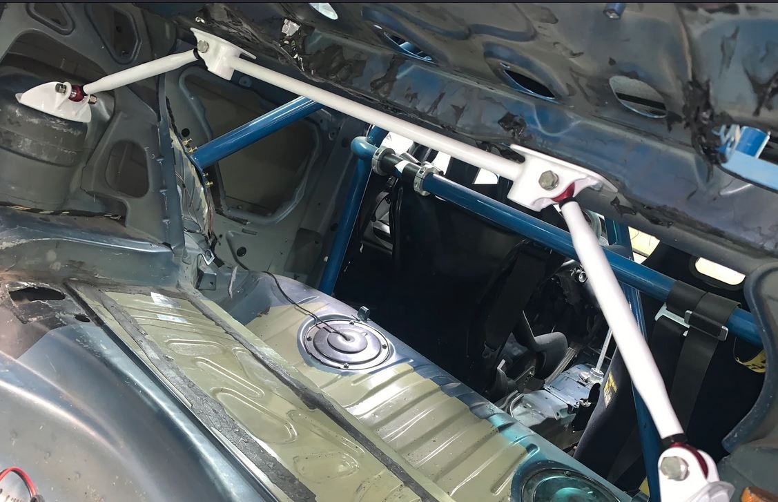

          I am also running the DMG CO+OP bar that mounts under the rear deck and ties to the shock towers, I have to consider if that could interfere with the rear deck mount installation.
          (not my car but just to give an idea)
