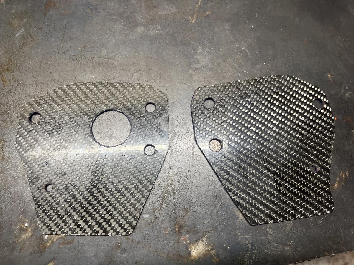

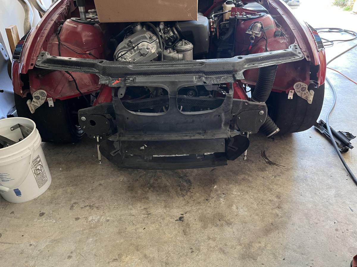

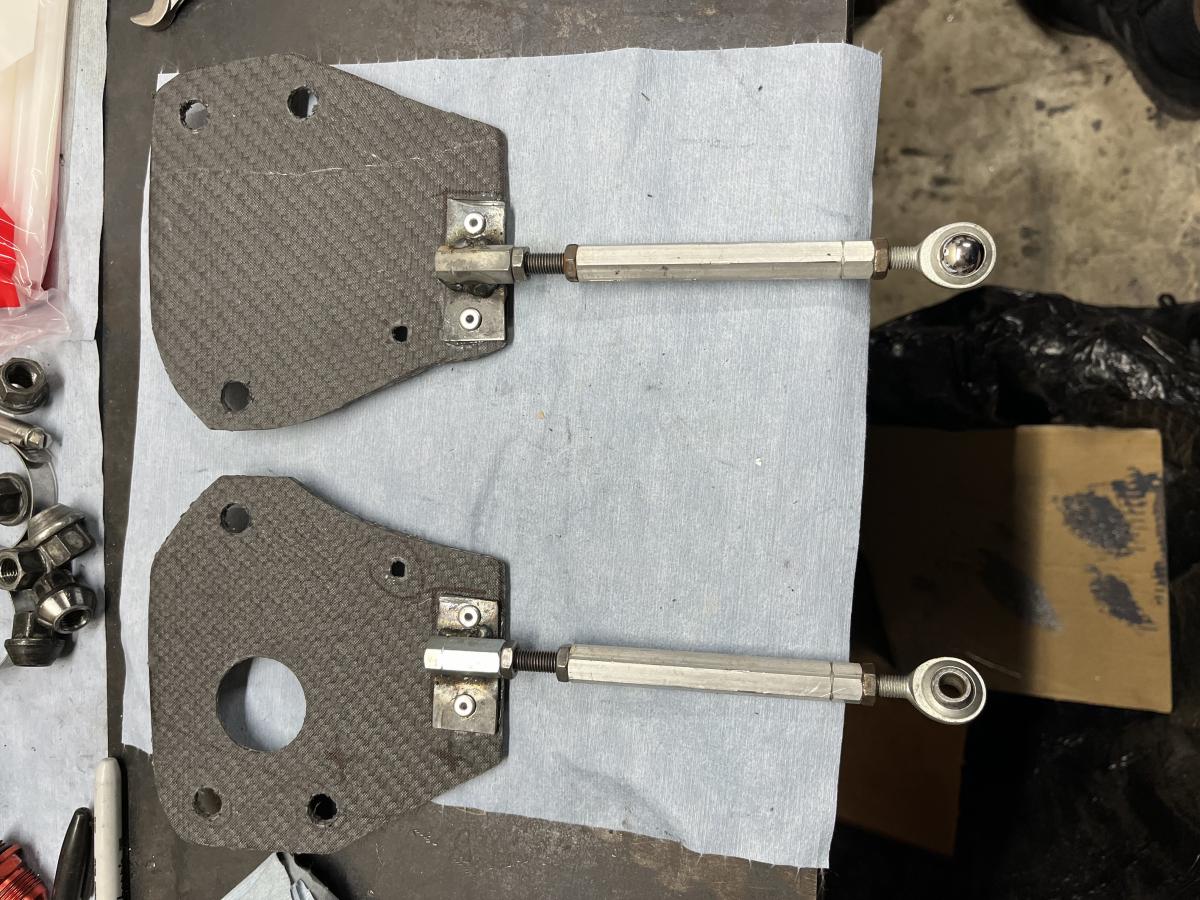

    I cut out some splitter mounts from scraps of carbon. The holes will be drilled. Does not include hardware and may need a little trimming. They fit between the front crash bar and frame rail.
    I welded a coupler nut to a steel tab which was riveted and bonded. I can provide the coupler nut and do the welding for an additional charge.
    $45 shipped for a pair.

    this is the finished part that I use.

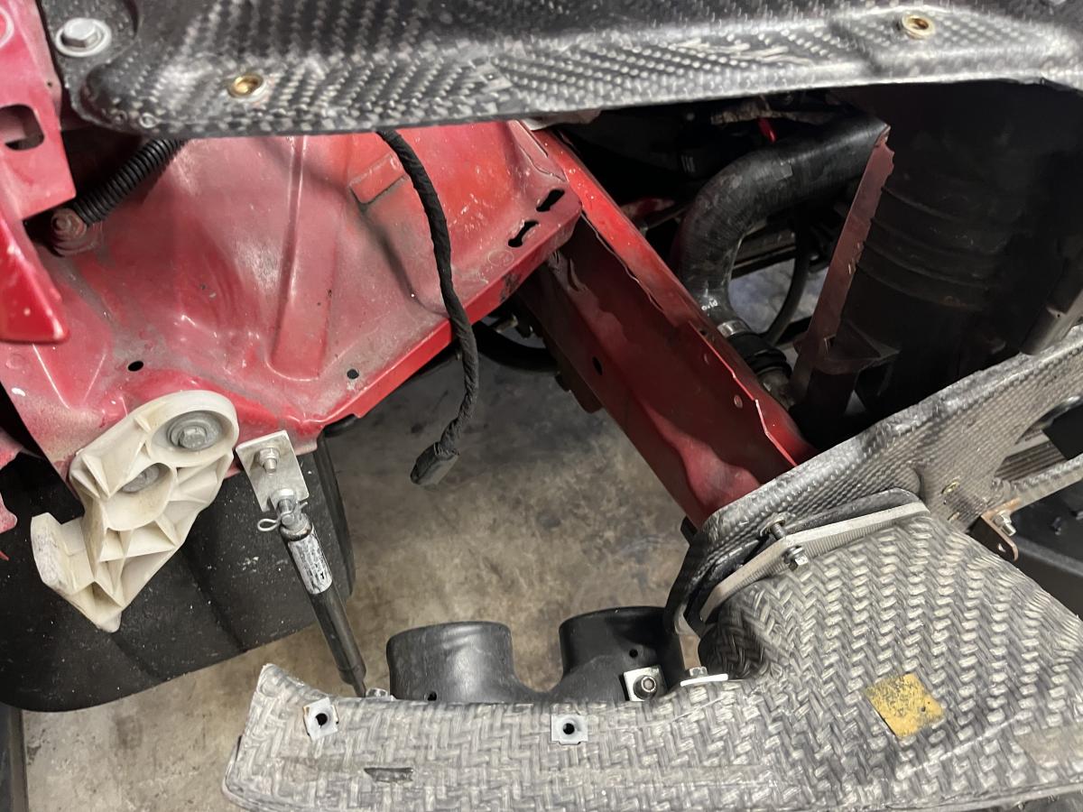

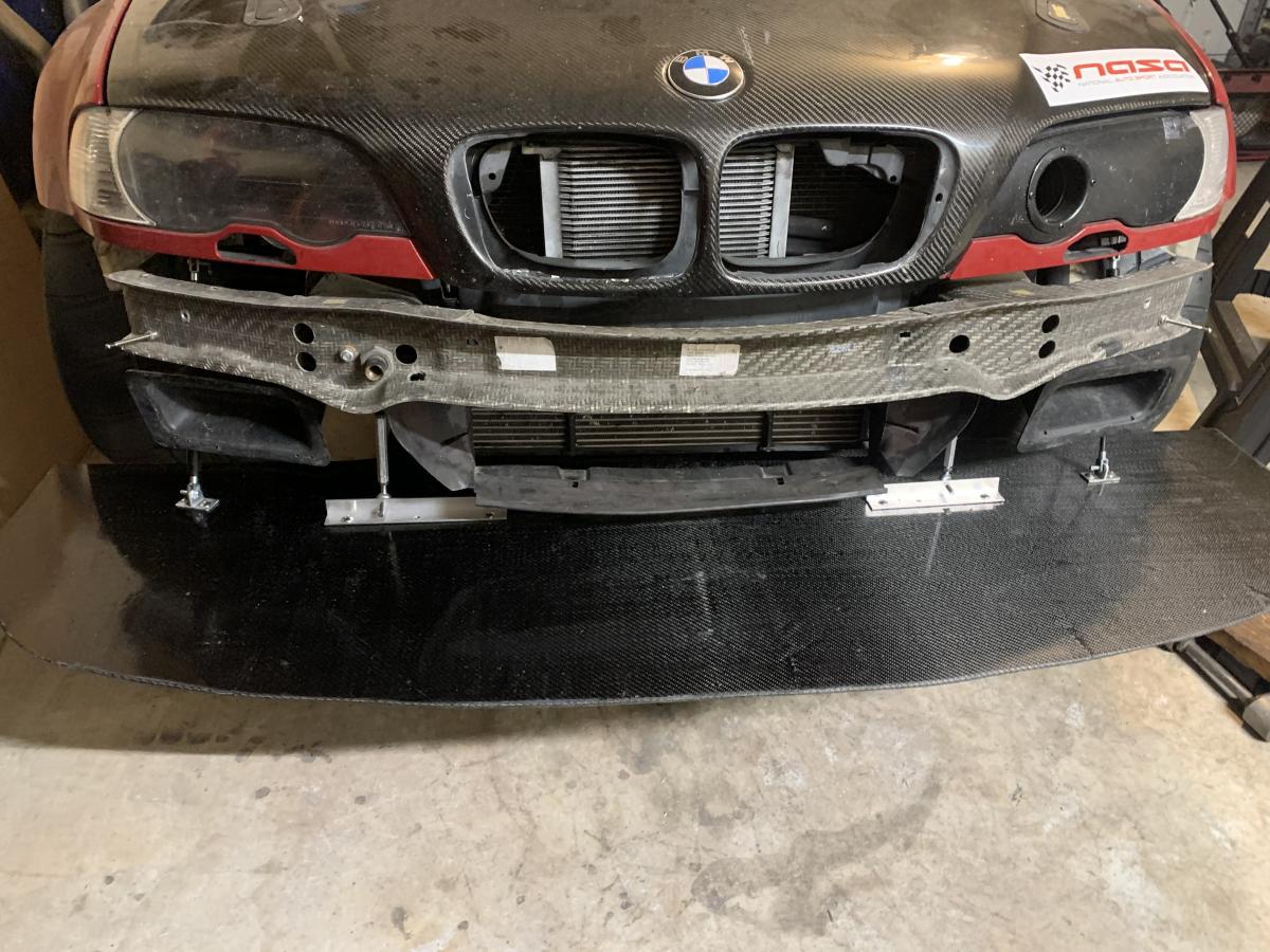

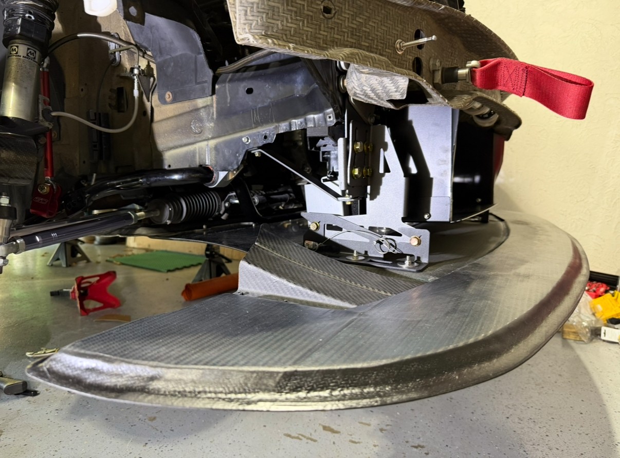

        Here is the splitter and mounting
        This is the two outer mounts. Ebay shock and clevis joint ($40) and pins/clips from McMaster Carr

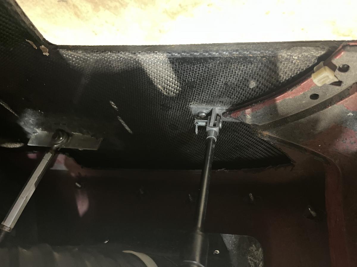

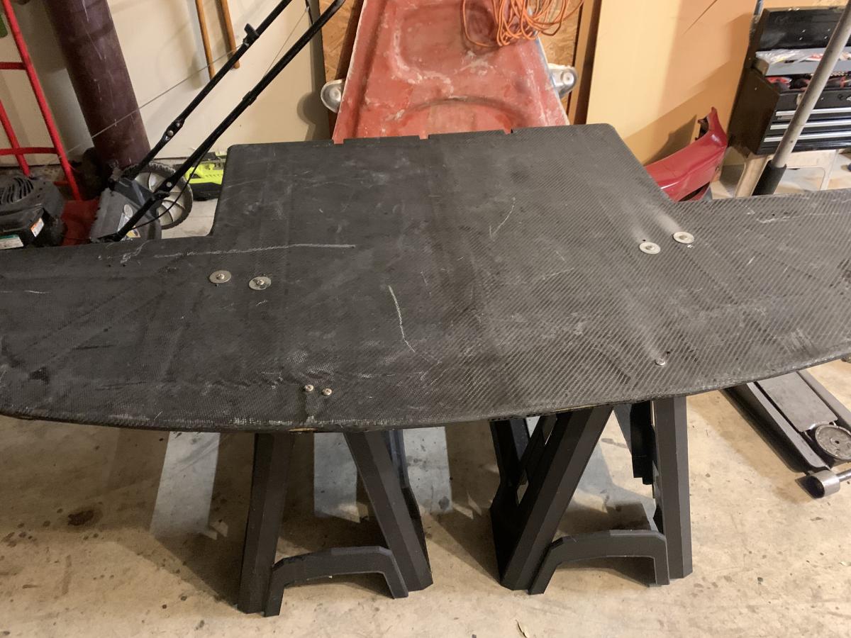

        Here are the primary mounts. There is a coupler nut welded to a tab which is riveted and bonded to the carbon plate. Then there is an aluminum turnbuckle with a spherical eye at the bottom. Attaches to the splitter using a pin and clip. Might be hard to see but I installed rivet nuts for the M6 bolts.
        Click image for larger version  Name:	97887959-2C8C-48FB-BAEB-8CF2539E3627.jpg Views:	4 Size:	180.9 KB ID:	252868
        I bonded aluminum T channel to the splitter. Also used a two piece sleeved screw thingie...forget the name. Have to have the thickness spot on though - WITH LOCTITE!!! All of this stuff vibrates a lot so things come loose.
        The pin goes through and voila - splitter is secured!
        Click image for larger version  Name:	762C416D-B8BC-4C1D-8717-0F7C9BCE96BE.jpg Views:	4 Size:	170.1 KB ID:	252869

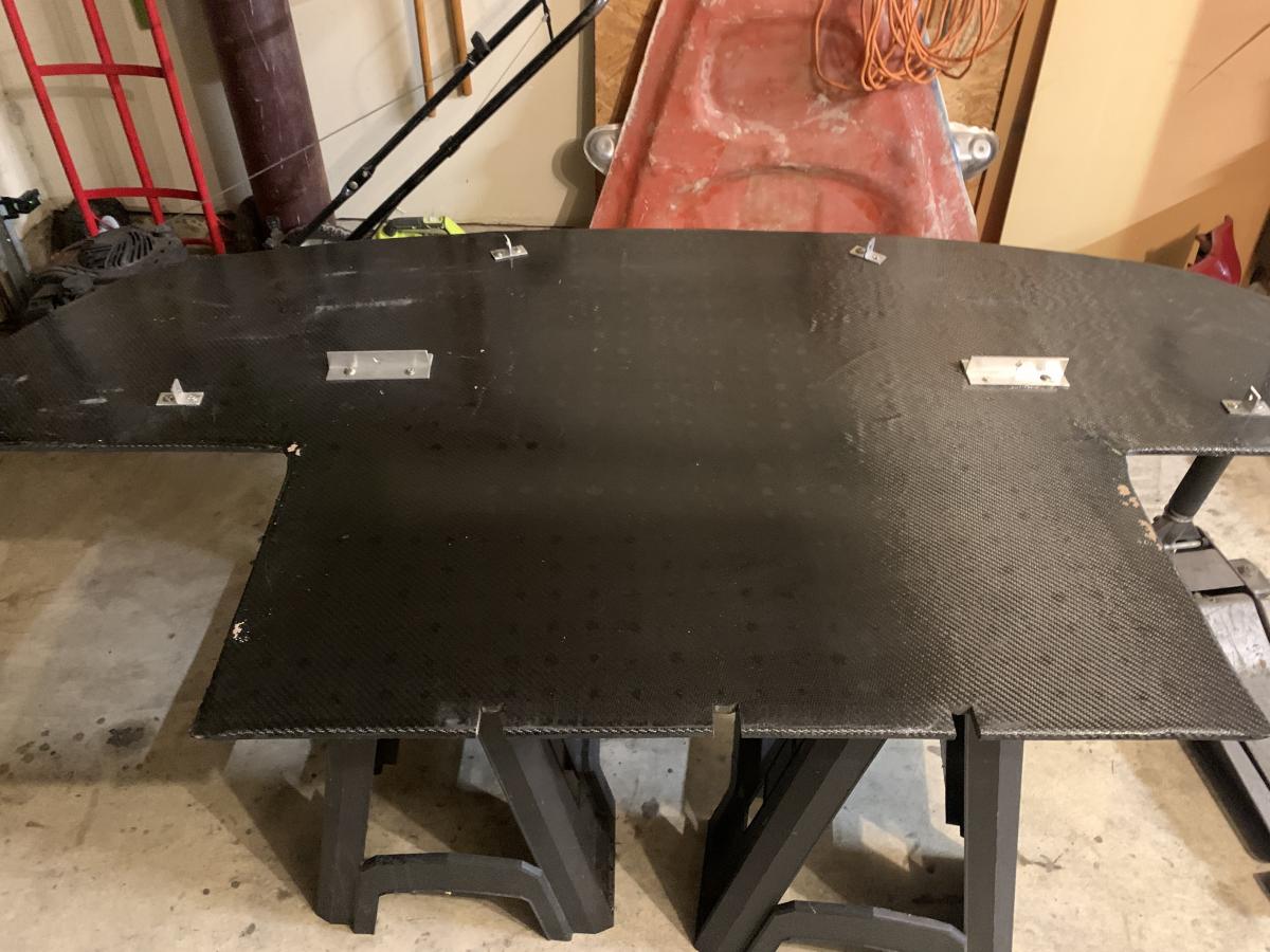

        Here's splitter...
        Click image for larger version  Name:	0176BA17-4BFD-4A46-A4F4-18A3C35C50E0.jpg Views:	4 Size:	126.7 KB ID:	252866 Click image for larger version  Name:	CFC744AA-BC45-456D-A38D-FFA52C2E58D0.jpg Views:	4 Size:	144.3 KB ID:	252867

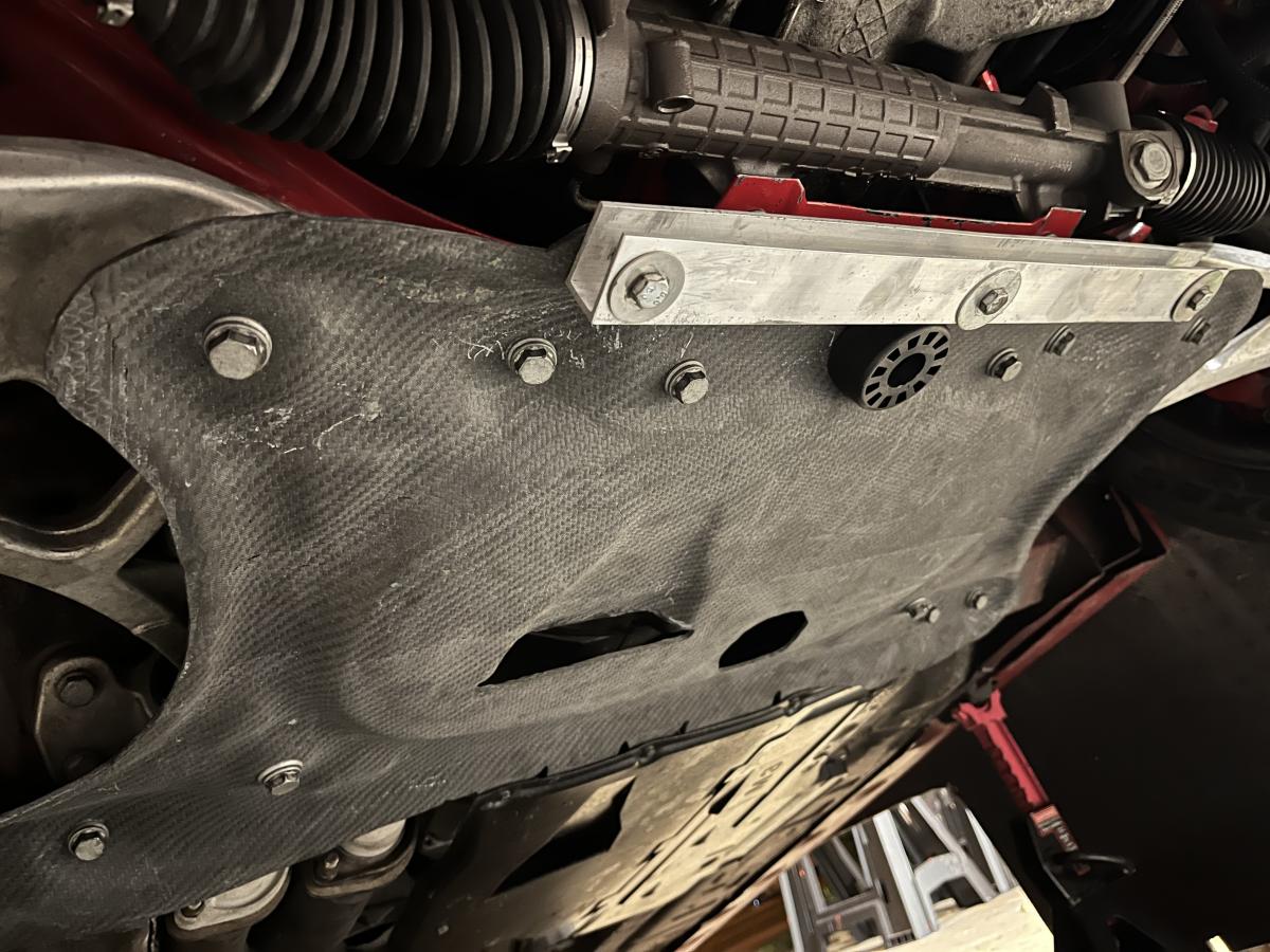

          Here is the back mount. It is c-channel aluminum. I replaced the OE hardware and bonded an M8 nutset to the backside. The reinforcement plate is carbon so this works really well. While there is load on this point, the splitter is being pushed upwards - the level effect on the front half of the splitter. The OE aluminum plate will also be fine.

          All of the parts were bought from McMaster Carr or eBay - Spent about $100 on everything.

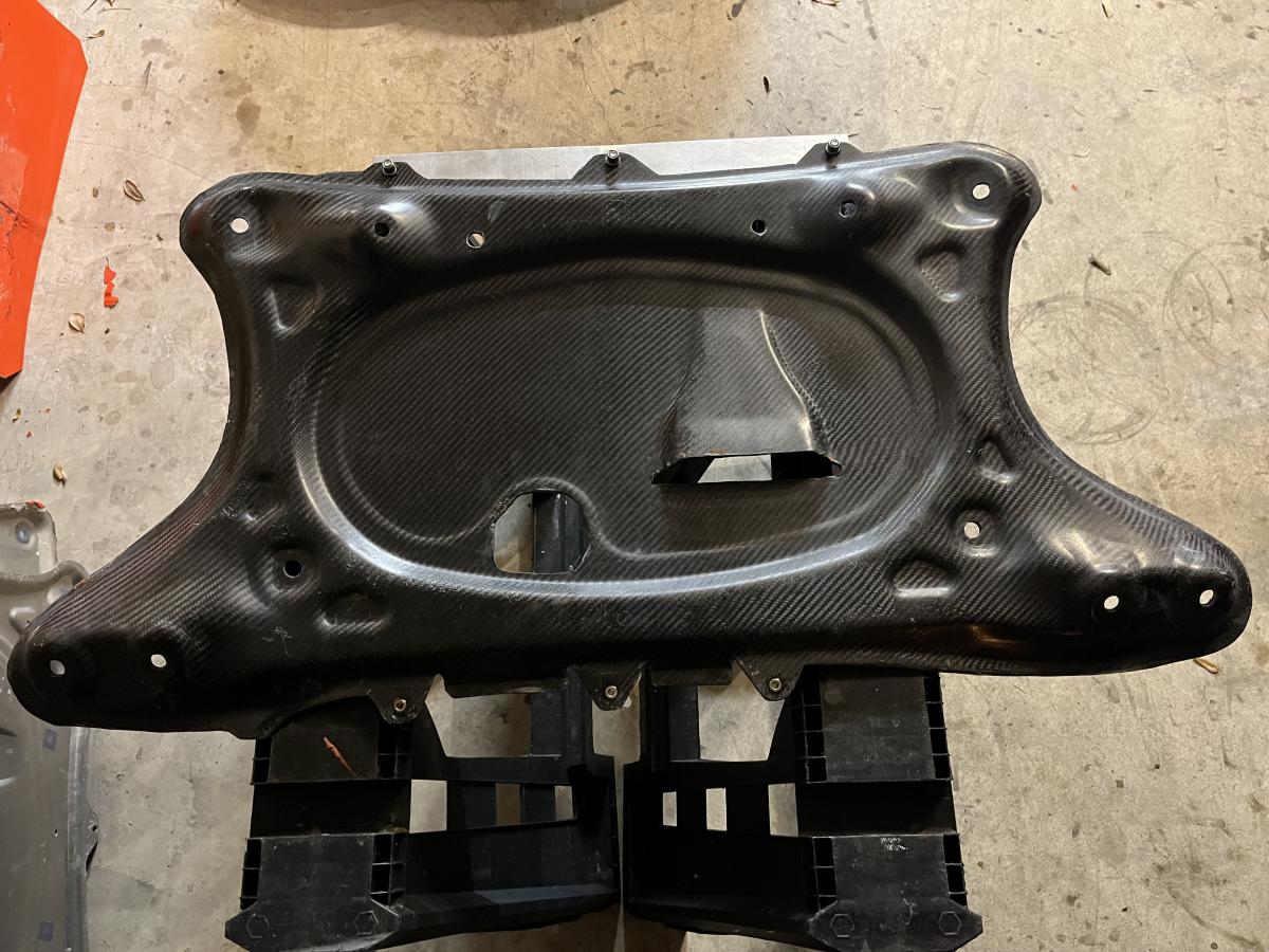

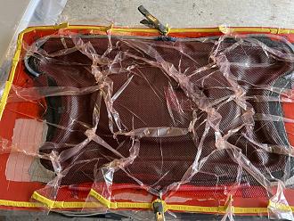

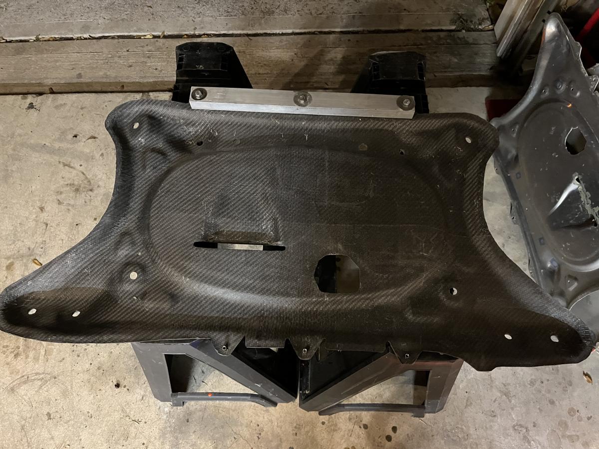

                Originally posted by SandeepM3 View Post
                This is very cool! Did you make that yourself? What's the weight saving?
                Made it myself. Saves about 4 lbs but it’s stiffer. That is a lot of layers of carbon. I think I could make it even lighter with added stiffness by using a core material, just haven’t tried yet. I'd also leave more material on the front edge so I could bond the c-channel.

                        The supports are adjustable so the splitter is flush against the bumper. I can't be 100% sure if the splitter isn't flexing downward but I've never scraped the front of the splitter under braking from high speeds. I highly doubt it because I'd have a ton of pebbles and rubber to clear out from the reinforcement plate if it was creating a gap.
