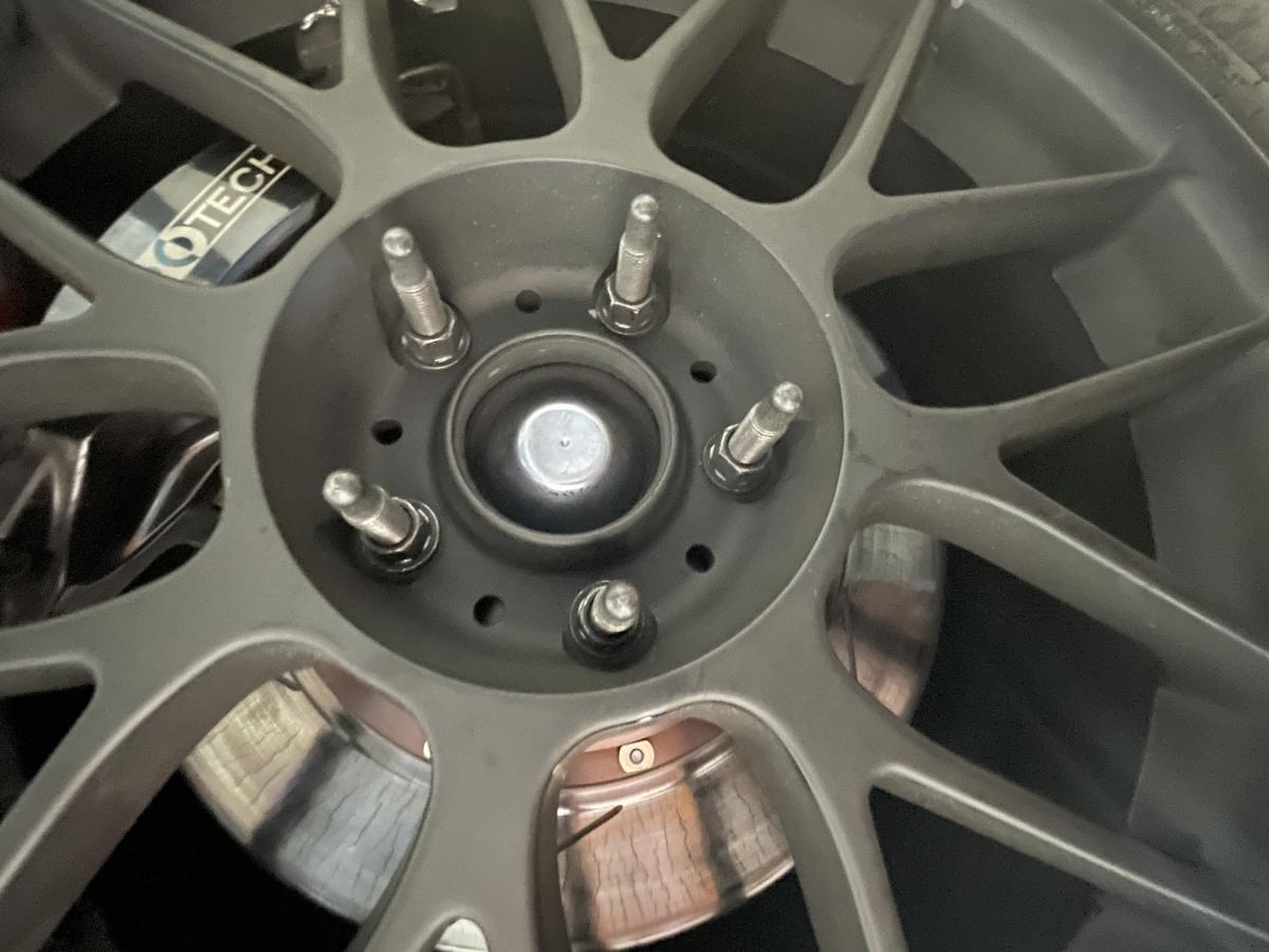

The cracking the rotors have in your pics looks fine and is normal to do that. Unless the rotor is at minimum wear thickness or is cracked all the way thru, they appear to still have life left. Here is a pic of my race car front rotor. These are not being replaced yet.
