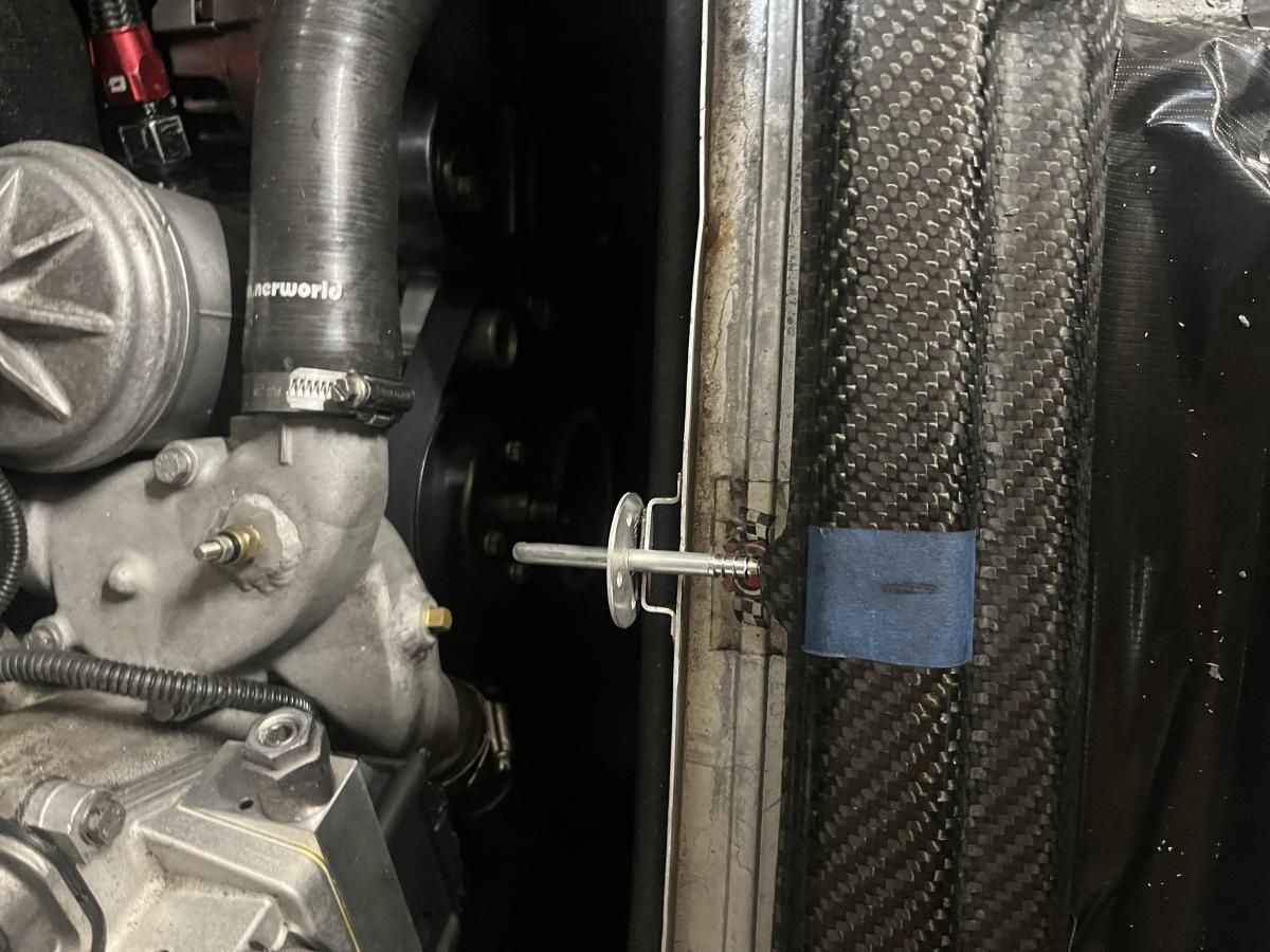

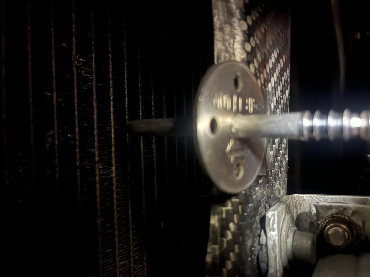

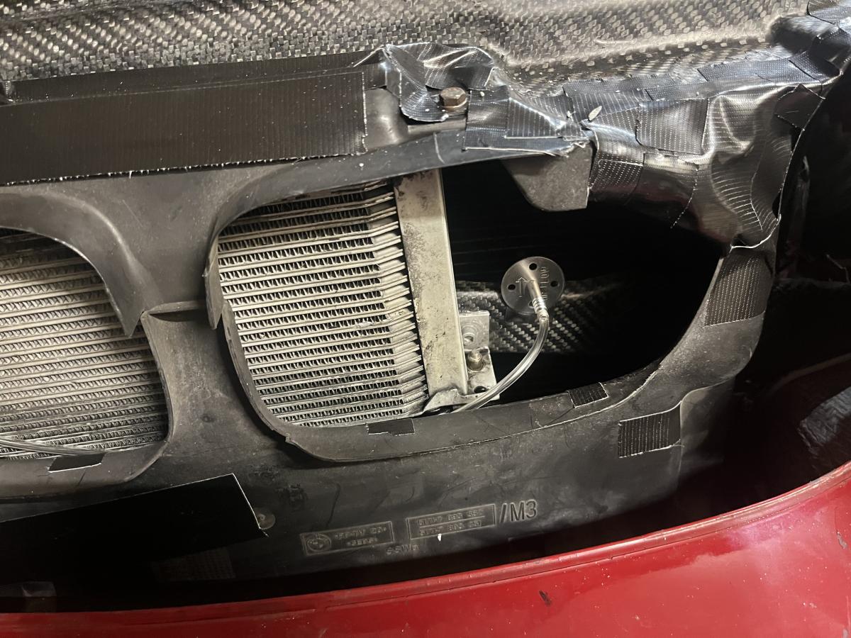

    First, I want to take a pressure differential across the radiator. I installed an air probe before and after the radiator connected to a meter mounted on the dash.

      Third picture has me convinced this car is held together by gaffer tape lol
      Jae is doing some race team aero sh!t by himself. Very impressive, looking forward to updates.
        Some learnings - if you delete the cabin air filter housing, you need to seal up the hole. You get a lot of air being sucked through the opening into the engine bay. I think this reduced the differential pressure across the radiator, I have to watch the in-car which has the manometer readings.
        Had some issues with the pressure probe tubes - need to secure them better. They would move and get jammed between the hood and fender which caused a pinch point.

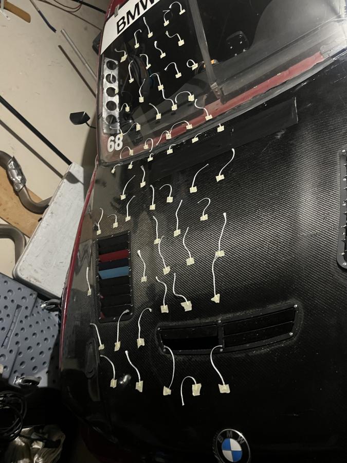

        When I towing the car to the track, all of the tufts were straight. On track, the tufts behind the side vent showed some turbulent air so there is some air extraction from the vent.
        Lol...thanks! Had to seal all of the gaps in the ducting. We'll see what comes of this.

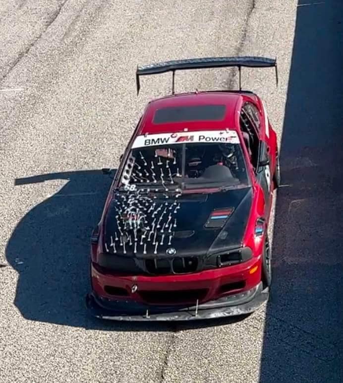

                  First, my biggest issue. Any ideas on how to better capture views of the strings on the car? Although my roof go pro flew off...I still need to find a better way. I definitely want to do some testing on splitter and down the sides of the car. Eventually, I want to put strings on the entire right side of the car. Might have to enlist photographer buddy?
                  A week ago, I closed off the kidney grills and cabin air opening. Added a gurney in front of the right hood vent. I also smoothed the transition from the hood to the windshield.
                  Top speed in Nov was 125mph, I was able to get to 130mph. The intake air temps were about 10 degrees lower than in Nov.
                  I uncovered the kidney grills in two afternoon sessions, I got worse water cooling but better oil cooling - mostly because the 2nd oil cooler was uncovered. Also, the strings on the right hood vent with the kidney grill open were standing up and the ends were bent over. It was wicked to see! But there is a longer area of turbulent flow behind the vent.
                  I noticed there was better flow attachment at the base of the windshield.

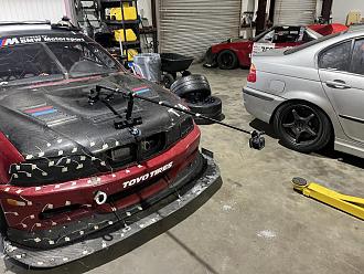

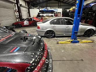

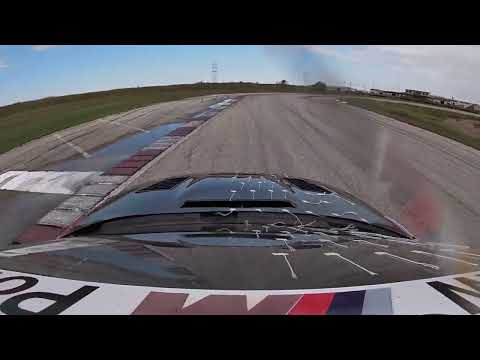

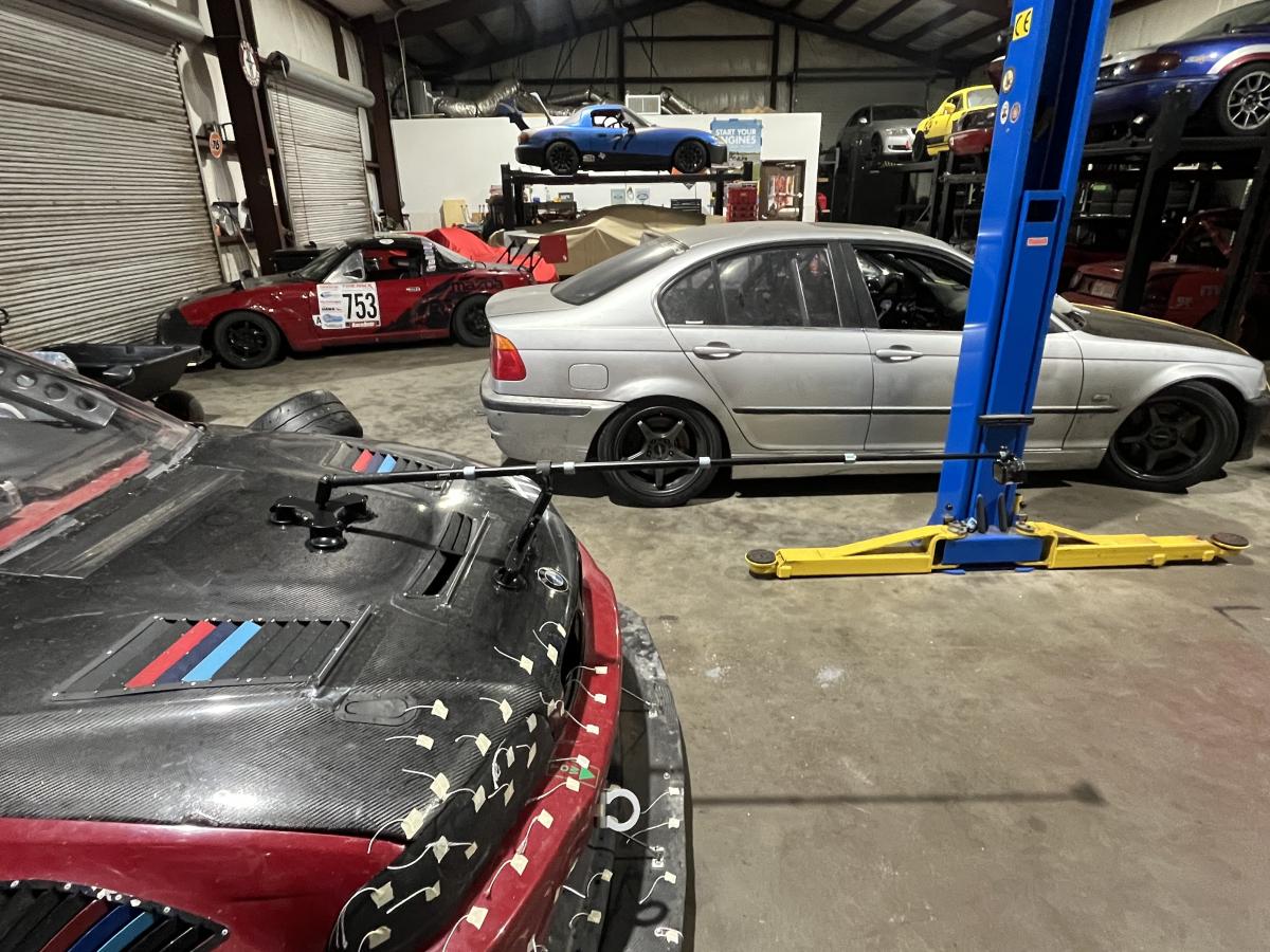

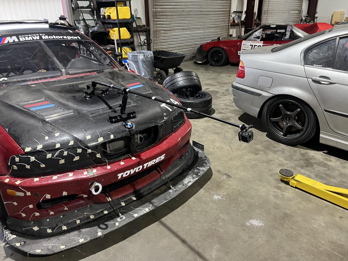

                    In an attempt to get some data of flows on the front bumper, I bought what I call a "cock stick". It's the long suction cup arm that street racers use to record their street racing. I used a GoPro Session4 in a waterproof case.
                    Click image for larger version  Name:	IMG_4435.jpg Views:	0 Size:	208.2 KB ID:	300845
                    It gets a lot of looks driving around the paddock and you have to be careful not to spear a wall or a pedestrian.
                    It worked great! My hood flutters at speed so the stabilization was working overtime. The video is usable and I can get the front corner and even the sides of the car. It is super distracting. I just did 2 laps and came in.
