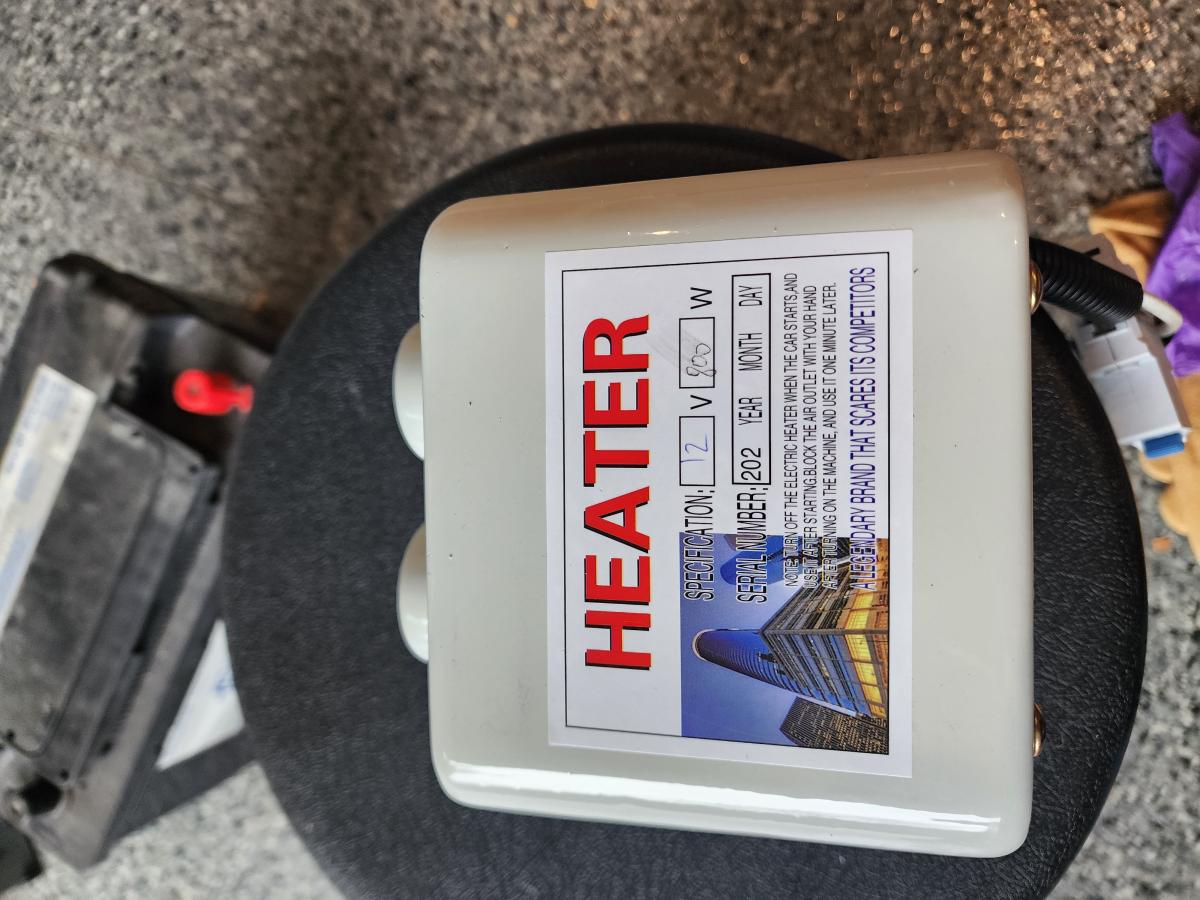

      I am also pursuing this mission. Recently purchased this:
      Not really "elegant." Shipping package states 2.4 lbs., so it is light. I am thinking remove when weather is good.

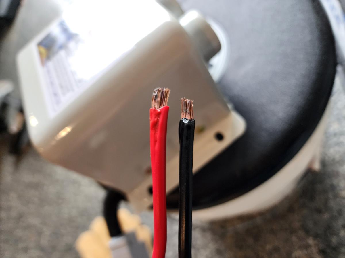

      Item says 800W, so ...65 amps? I believe the alternator makes 130 amps, so doable? The wires feeding it are 3mm diameter (copper part). I tested it with a spare car battery. Blows good CFM, very good heat. But after about 60 seconds the wires started to smoke and insulation started to melt.
      I think the wires are undersized. Next step is open unit and rewire. 8 gauge?

        OK. So I'm stupid! Loose wire connections -> heat.
        Wired it up properly and ran it for 10 minutes without a problem. Wires a bit warm to touch after 10 minutes. Next task is to figure out current load.

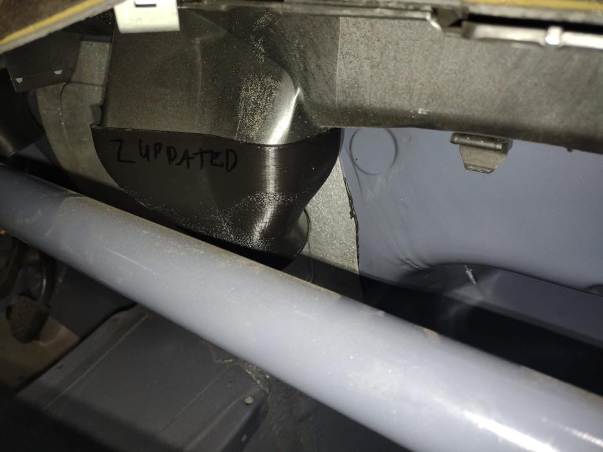

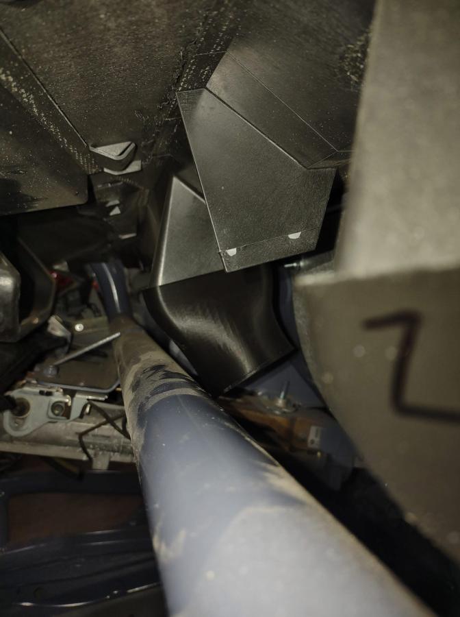

                      Browsing the spec e46 group on Facebook I also came across an AAF post that they were developing an adapter that will connect a 3" to the stock dashboard vents but I didn't see it on their website.
