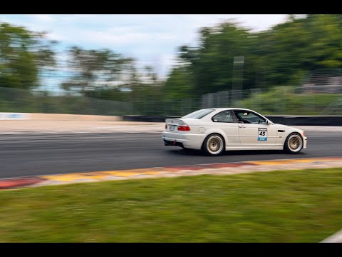

Hey guys, somehow I didn't know this thread existed until now, but I've spent the last hour+ reading and watching videos! Great to see so many folks out there tracking these cars. Somehow, I always seem to be the only E46 at the events I attend, but now I'm encouraged to see there are like a dozen of us 😂
I'll post a couple videos from the last year or so of my time attack events. I really should stop being lazy and update my build thread as well.
Here's a 1:34.5 from last year at Autobahn South:Last edited by bojangles; 08-17-2025, 05:35 PM.2003 Alpine White M3
MCS 2-ways, 750 & 850lb, ML10RT 18x10.5 w/ 285 RE71RS, Hotchkis front & no rear, monoballs | Turner CSL, MAP conversion, Schrick 288/280, SS headers, BW sec2&3 | ATS 1.5way carbon hybrid, 4.10 FD | Brembo GT BBK, Cobalt XR1/3 | no aero

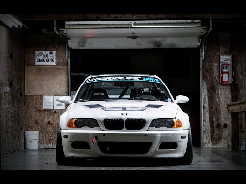

Another video from this past weekend at one of my favorite tracks in the Midwest, Grattan raceway.
Still loving the 4.10 and ATS diff. Felt extremely confident getting on power much earlier than in years past.2003 Alpine White M3
