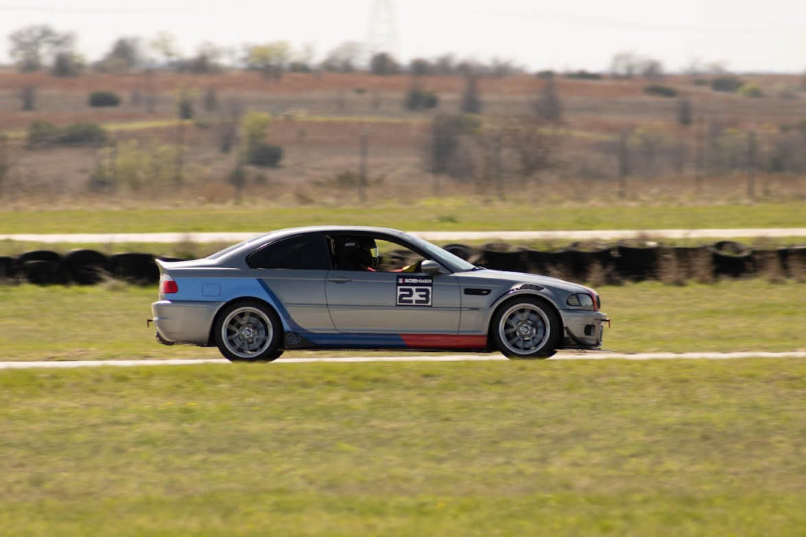

                  My buddy's wife was taking pics, I think this is your car Wernd ?

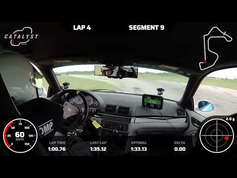

                              Finally getting around to uploading a few videos from last year - here's my latest attempt at Autobahn Country Club - South Circuit.
                              Pretty happy with getting into the 33s, but there's definitely more time in it.
                              Car was like skipping and bouncing the whole weekend, and i just couldn't solve it with damping and compression changes....you can see it very clearly in Turn 8, completely upsets the car at the apex and on exit. Also meant that i couldn't hit the curbs like normal.
                              Turns out that one of my rear shocks had lost all gas pressure....
