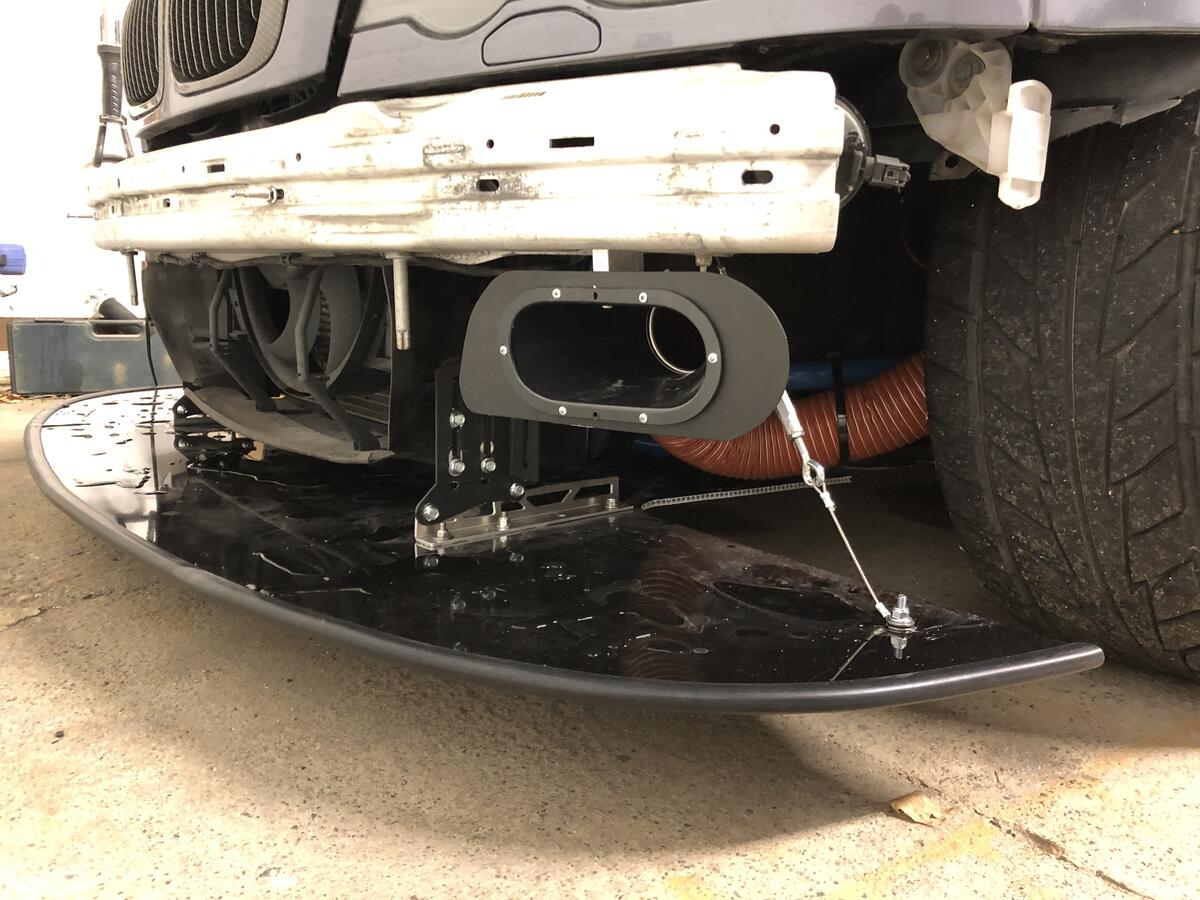

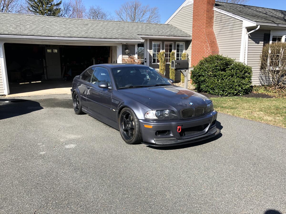

                I am using the buildjournal mounts on my front splitter. Along with their quick disconnect front bumper mounts it makes for a really nice setup that allows very good access to that area of the car if needed. For the splitter I used alumalite which isnt ($200 for a 4x8 sheet) the cheapest material but very light and stiff. ran this car last season with jut the front splitter and no wing. I installed the splitter to combat a n understeer issue I was having. It did help but ultimately I changed suspension setup to fully fix the problem. Buildjournal has been awesome and stands behind their product 100%.
                I placed an order for a ninvelives racing wing last month and will be installing it for next season so I cannot comment yet but as said above it is a very affordable option with some real data behind its design. The two big downfalls are the weight vs carbon and the unfinished surface.

                      Yeah I like the Buildjournal approach and when I do this, I'd like to do the quick disconnect bumper/splitter too for the easy access. I see you entirely removed the finder liners too? Did you remove all that plastic liners even within the wheel well?

                          Only the front portion of the fender liners have been removed. The section inside the fenders themselves are still there although they are mostly worn through at this point from tire rub and will likely get removed this winter for some fender venting if I get that far. which dimension are you looking for exactly? Mine is a very small splitter by most standards and only stick out from the front of the bumper by about 4"
