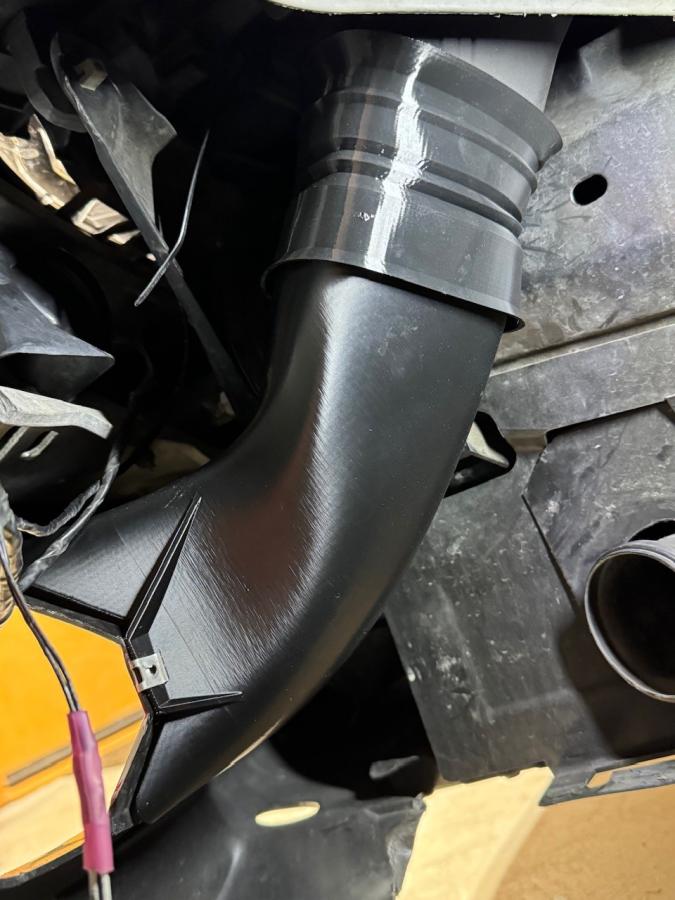

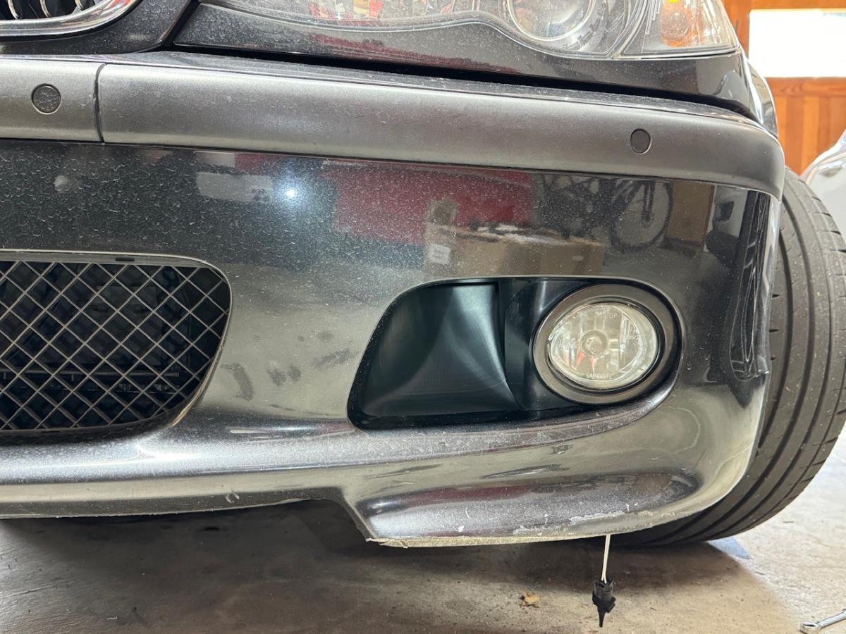

    I’m actually going to fashion a singular snorkel to stock M3 fog light area and the 3D print them… waiting on the Haimus snorkel to arrive and then I’m getting to work.
    I'd be interested in this, I have a Haimus extension for my Karbonius box waiting in the wings.

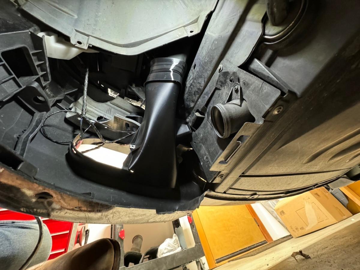

          One of you better get a good cad model of the plastic parts! I’ve had my eyes out for one of these for years now
          For those of you wanting to make a snorkel that goes over to the fog light area, good luck, it will not be easy as the routing will be odd. Here’s what it looks like when you take over the brake duct:
          Click image for larger version  Name:	IMG_1460.jpg Views:	0 Size:	64.2 KB ID:	260248 Click image for larger version  Name:	IMG_1463.jpg Views:	0 Size:	75.4 KB ID:	260249 Click image for larger version  Name:	IMG_1465.jpg Views:	0 Size:	138.0 KB ID:	260250 Click image for larger version  Name:	IMG_1452.jpg Views:	0 Size:	170.0 KB ID:	260251

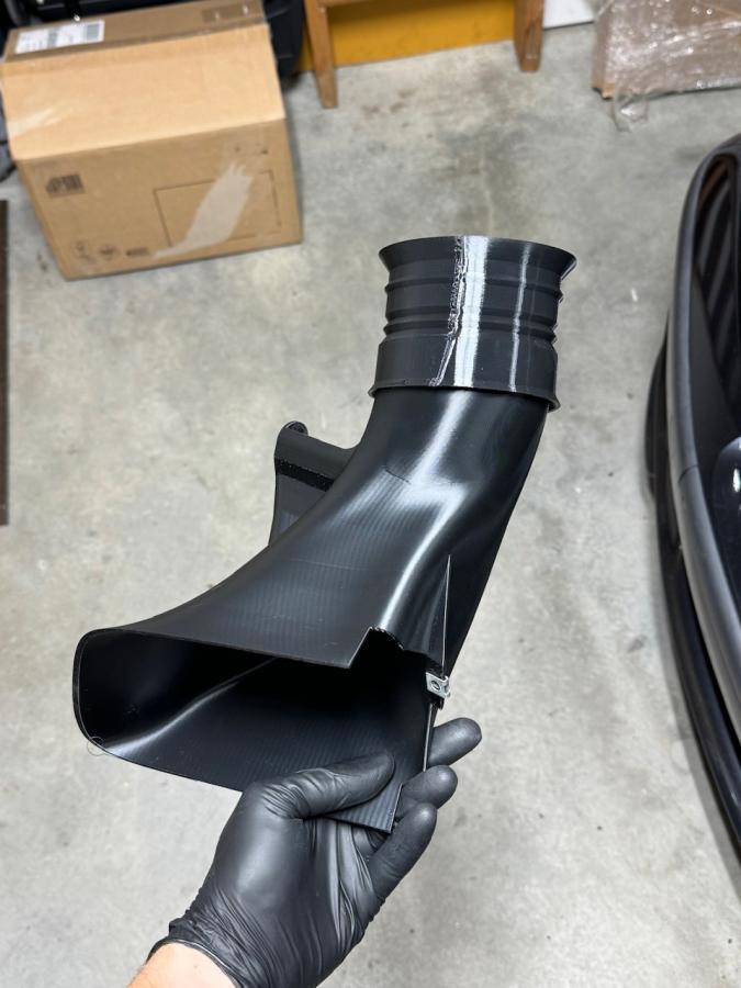

                  I have one of these brand new, old part number 13717896774, send me a message if interested, first come first serve.
                    #39
                    I’ll take it. Will scan the part so it’s 3D printable too.

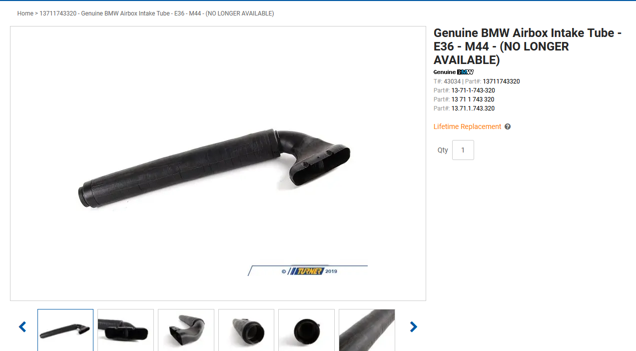

                      Just came across this old thread, but this will help others coming through here.
                      Seems the CSL tubing is the same as M44 E36s intake tract. These are super common to find worldwide.
