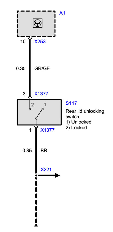

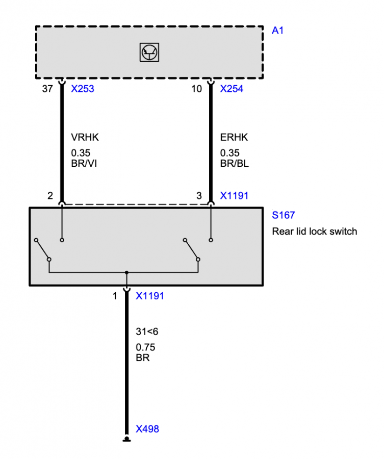

                  Oh nice, that might be easier to install with the pigtail like on the E46.
                  It does look like a slight wiring modification would be needed though (at least according to the wiring diagrams). E39 switch is SPDT and E46 switch is DPDT.
                  E39:
                  Click image for larger version  Name:	Screenshot 2023-09-21 at 11.48.56 AM.png Views:	0 Size:	68.3 KB ID:	234691
                  E46:
                  Click image for larger version  Name:	Screenshot 2023-09-21 at 11.49.16 AM.png Views:	0 Size:	241.8 KB ID:	234692
                  E46 GM5 pinout says that both X253 pin 37 and X254 pin 10 are inputs for the trunk switch. The E39 switch should work fine if pins 2 and 3 are bridged together on the car side of the button harness. Something as simple as a wire tap would do the trick, but a nicer solution would be to add another pin to pin 2 on the E39 switch connector and bridge it to the wire in pin 3.
