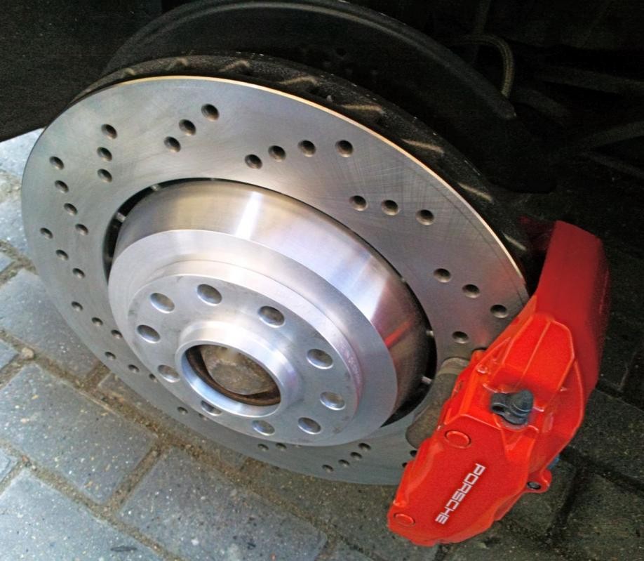

                  I knew you were :hahaha: I aim to please :thumbs:
                  Here's a few obligatory pix :blalalala:

                    Thanks for that, but you have admitted that it's 90% which is exactly what I was saying. It's not as good as a properly designed bbk. What it is, is a good budget option. Nothing wrong with that, but each to their own.
                    BTW What size pistons do those calipers run?

                          Yes, I quite agree with you. If I were in the market for a sub £1k bbk, I would also look into the Porsche caliper/Csl disc route rather than those other three that I mentioned. Do you have the piston sizes for the calipers that you use? It's a very important factor.:beer:
                            Matt do the pads wear evenly as they protrude the calippers somewhat, covering more of the disk? it may have been asked before
                              I did measure them at the time of the upgrade but I don't have the figures to hand, probably better to ask that question to one of the Pork boys My fronts (and soon to arrive rears) are off a 2008 CAYMAN S, Porsche part numbers 996.351.425 and 426 for the fronts, if that helps.
                                Steve, it depends which pads you use. The PAGIDS stuck out by about 1-2 mm beyond the outside edge of the disc but the EBC "Reds" don't. Either way it makes no difference and they do wear evenly :thumbs: and they seem to last longer :thumbs: then they did with the O.E. "wrongness" :banghead:
                                I have absolutely no complaints after 10 000 miles :thumbs: and quite a few of these on Track :whistle:
