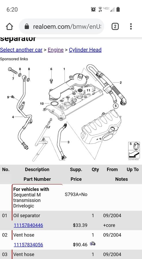

                    Does anyone actually have a hose that attaches from the bottom of the box and goes to the dipstick?
                    My drain line simply goes straight down to the oil pan and every S54 dipstick I have seen listed online does NOT have the connection for the drain line. Doesn't mean much, just an observation.
                      #40
                      My 2002 6mt is like what you described, tube directly into oil pan. But realOEM seems to indicate otherwise, and seems to show what looks like a check valve possibly? Into the dipstick tube
                      Sent from my HD1905 using Tapatalk
                        #41
                        Cubieman brings up a valid point, etk is often wrong in its depictions for whatever reason. Same reason why cdv doesn't show up in there intentionally.
                        Looking at both m3 and csl dipstick tubes there is no other aperture for a line to fit in to.
                          #42
                          Yeah mine goes straight into the pan too
                            #43
                            His posts are sometimes confusing. They all have the drain straight to the oil pan, not the dipstick.
                              #44
                              Simply a reference to a link (in this thread) from realoem with a clear image showing the drain line attaching to the dipstick vs. what I've seen in person and online.
                                #45
                                I was misled by RealOEM part diagram
