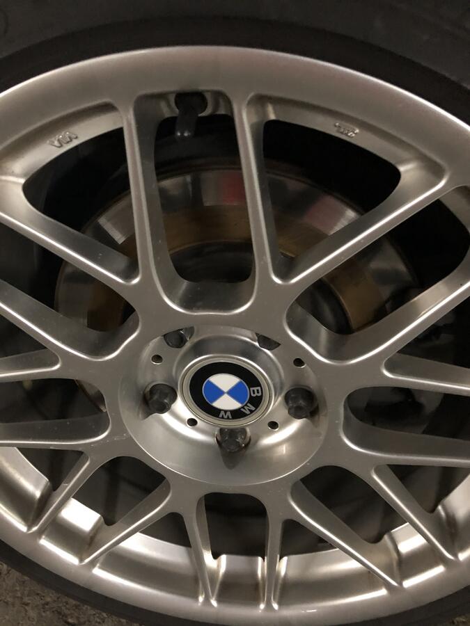

                      Should I be concerned about this?
                      -Replaced rotors with OE ones that had <1,000 miles on them (rusty from sitting in a shed for ~15 years)
                      -Reused my pads (OEM) as they still have good thickness
                      -After 500+ miles, the rear pads are still barely contacting!
                      Fronts after a few miles:
Name:	Front - after a few miles.jpg

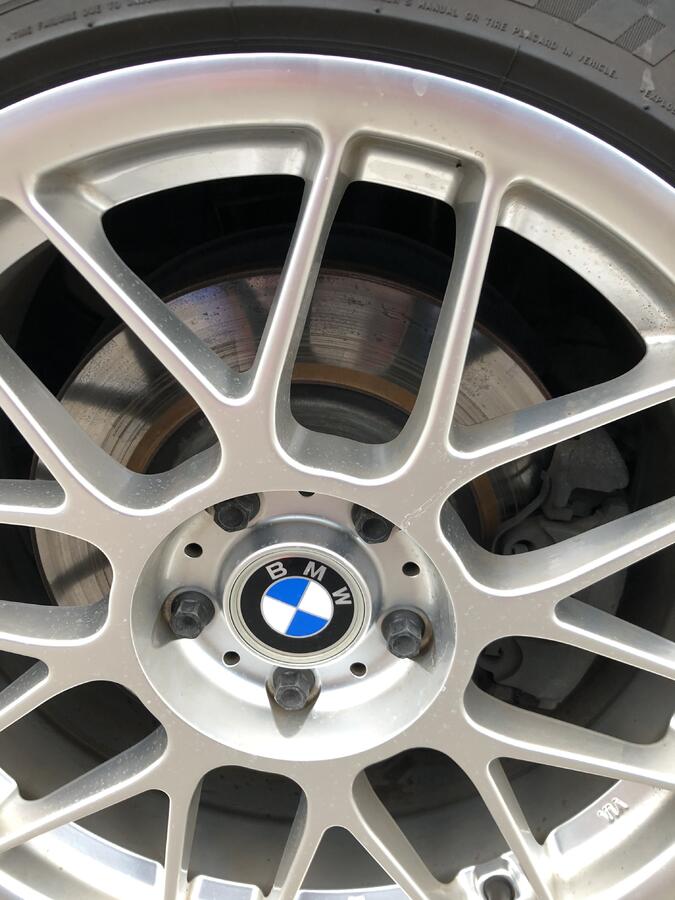

                      Fronts after 500+ miles:
Name:	Front - after 500+ miles.jpg

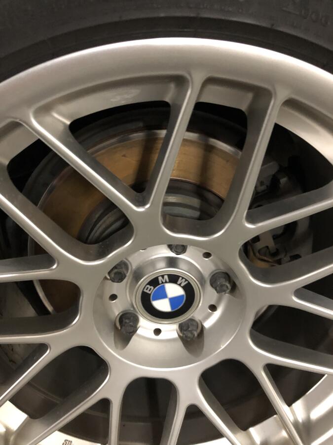

                      Rears after a few miles:
Name:	Rear - after a few miles.jpg

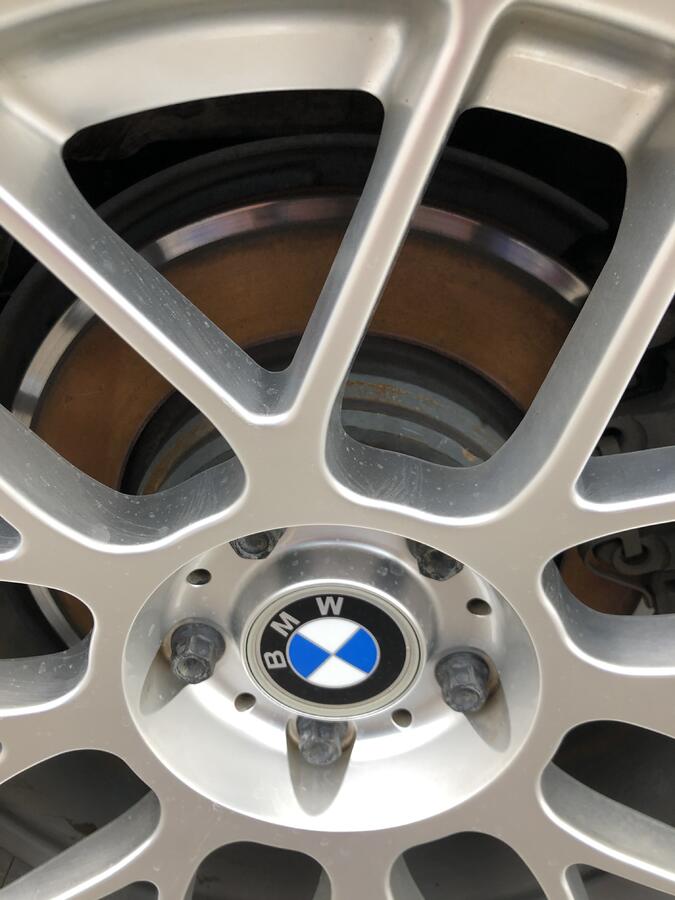

                      Rears after 500+ miles:
Name:	Rear - after 500+ miles.jpg
                      I will note that the brakes feel and perform great under normal driving. I have yet to do any serious panic stops though. Thanks!
                        Did you bed these properly, and repeatedly, as it sometimes takes more tries to get the rears properly bed in. I've had the same issue after caliper rebuilt and new pads on my BBK. I was surprised how hard you actually have to go at the bedding process in order to get the proper results. And I think I still havent done it properly.
                        Obviously it just looks like the pad and rotor surface are not mating correctly. If there are no vibrations from normal braking in normal driving conditions then I think you're ok. When you're doing panic stops things might be different, this would drive me insane though.
                          I did not perform a bedding procedure as I have not had good experiences doing so in the past with street brakes
                            You will have to work the brakes and heat them up. Drive on highway and drag brakes for a while then drive in 4th and ride the brakes. You will have to do it a number of times. I had a new to me car that sat outside for a year or so even with 35,000km brakes were rusty. Eventually got them cleaned up.
                            If you get motion sickness be prepared to do it a few times. Lots of cool BMWs here in Calgary
                              Roger, I'll give it a go - that's easy enough! My biggest concern was that my rear rotors are going to wear unevenly and eventually cause vibration
                                You have my dream spec M3. hopefully this turns into a build thread
