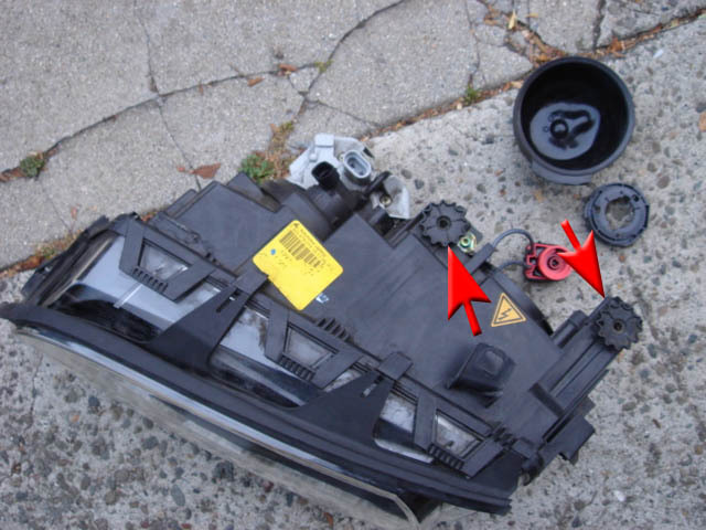

              Can you manually adjust the lights vertically using these knobs? I did it a while back cant remember which knob is the side-to-side and which is the up-and-down adjust.
Name:	Headlight housing.jpg
