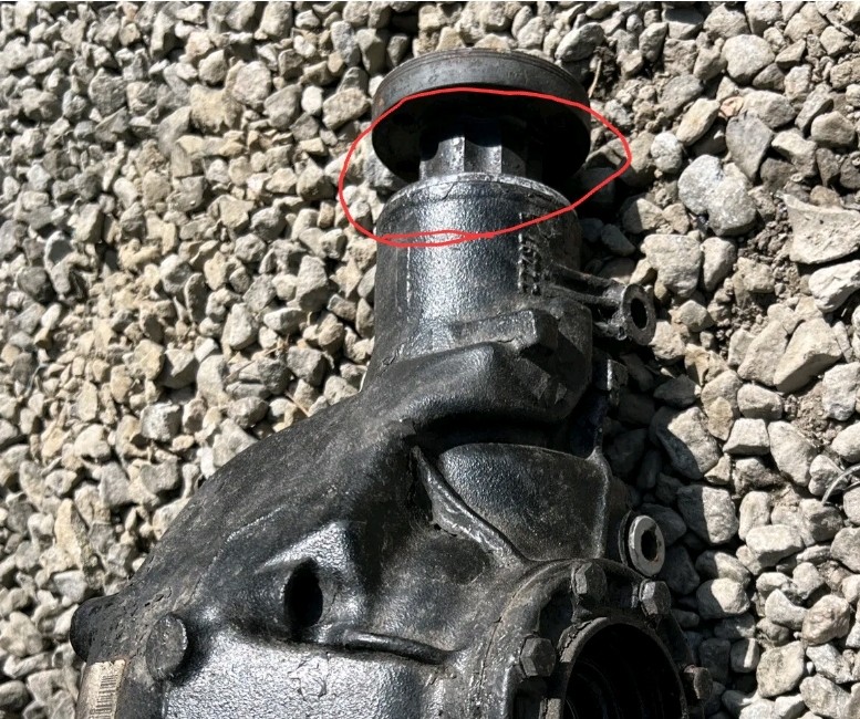

                Can a V1/V2 diff be differentiated by the round vs. "Scalloped" input shaft? I have V1 diff and the input shaft is round.

                  V1 has both round and scalloped neck.
                  The reliable way is v1 has more plays at RH output.
                    V1: the left output flange has 401 number (long splined shaft)
                    V2: the left output flange has 402 (short splined shaft)

                        after removing the CV joint on the output flange then the numbers are on the flange end.
