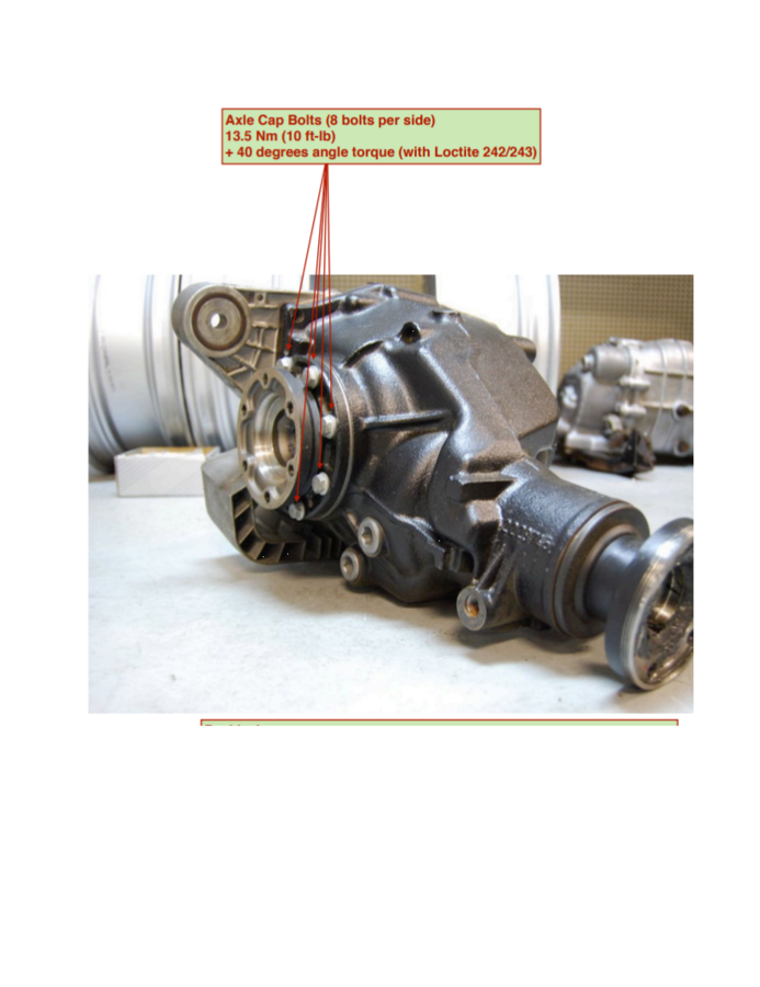

                      I was looking at the E46 M3 Torque Spec in the Tech Section but couldn't find the ring gear bolts torque spec. But I found this pic. interesting: in the back ground is a Porsche 901 dog-leg transaxle that I'm very familiar with -- I have a few spare and had converted one from 4 speed to 5-speeed, and changed a few gears to suite my FWY commuting. Is this from TIS or from a member here?

                          From what I could find the bolts are M14s and the torque is either 162 ftlbs or 177 ftlbs. I think non M bolts are different but I have not had a BMW diff apart yet to confirm. I'm still searching but this is somewhere to start.
