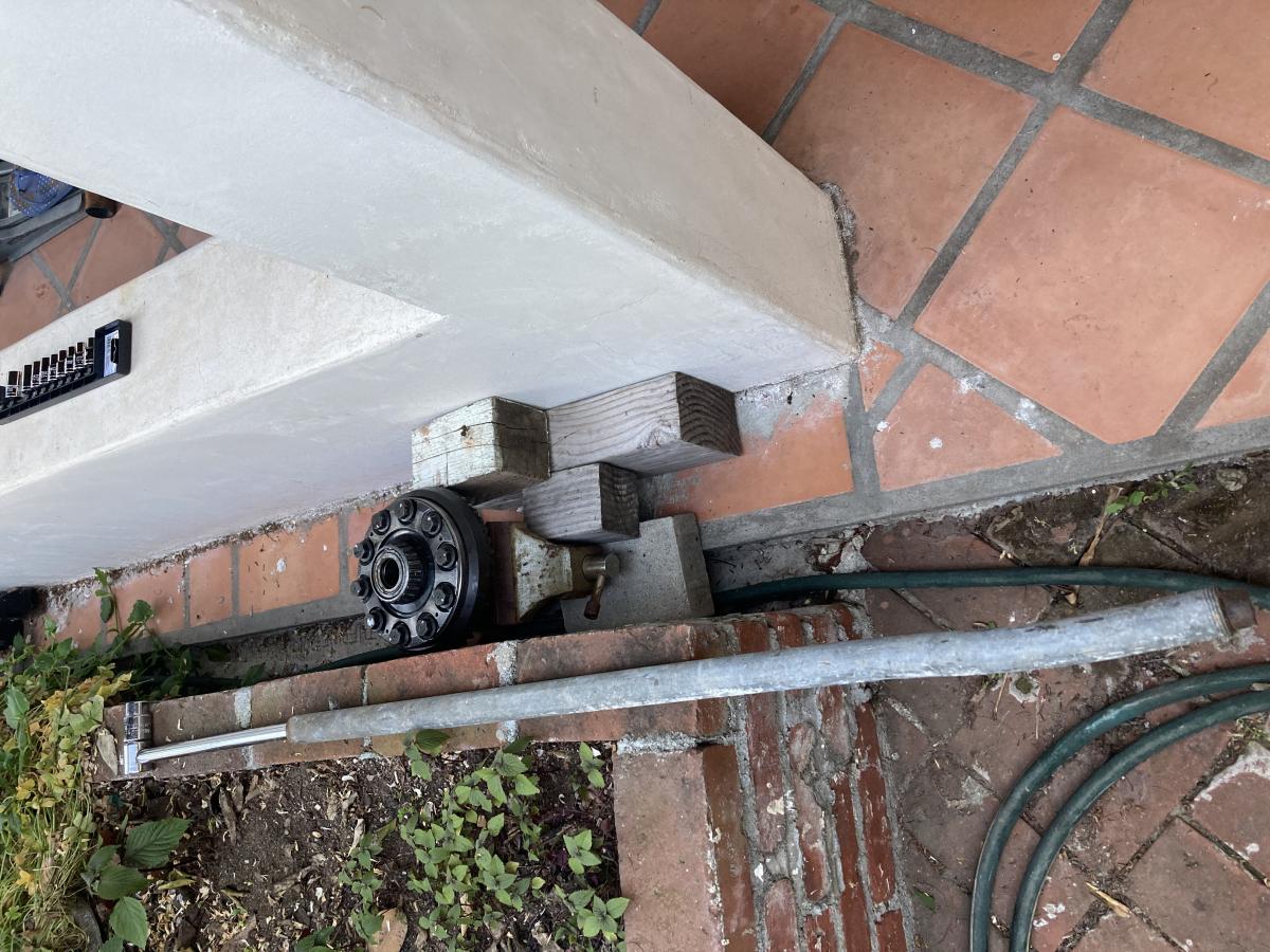

          Well, today I finally have the strength needed to loosen these nasty bolts. I had the clamp holding the carrier but to prevent the round carrier slip in the big vise, I inserted two 19mm sockets into the carrier side holes (there are 4 holes for V1 diff). The factory used Loctite or whatever thread lock on the threads and I used a 5 feet long breaker bar with 3/4" drive. I don't know how people can hold the round carrier in the vise as I'm sure it sill spin if I didn't block it by adding the two 19mm sockets in the side holes. I used the brick walls to block the vise as in picture. Some of the bolts needed over 200 ft lbs to break loose (I pushed very hard on the 5 feet bar, 200 = 40 x 5).

            40lbs of force isn't very much. You sure about your calculation?

                But 200 ft-lbs isn’t small torque either; just being conservative on the calculation as I needed to reach at the socket to press it down with one hand at the end of the 5’ bar, I used the other hand and leg to turn the bar. Yes it easily 250 ft lbs if pushing the bar with 50lbs. It’s important not let the socket jumping off the bolt head.
                    200 is piddly for a 5ft breaker. You can soften the loctite with some heat if needed. Pretty sure the breaker I used was a standard 1/2” and decent vice has no worries on the body it’s like 6 to 8knches in diameter requires about 400 lb resistance at the interface which is like 1200lb clamp
