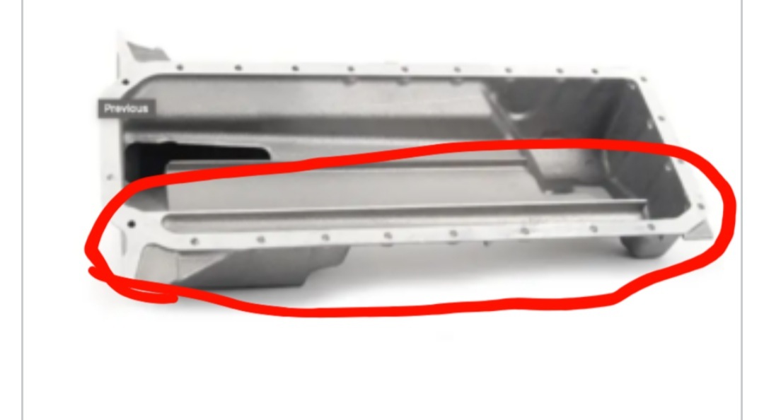

          I dropped something down the head a while back and was able to retrieve it on the 2nd try with a flexible magnet from up top. Pull up a picture of the oil pan for a reference as to where the shim may be. Try the bendy magnet from up top, the telescoping types don't work too well, you may just feel a nice "clink".
          If you dropped it down where the screens are supposed to be there is a "ledge" there in the pan that goes from front to back, if your lucky it is still on this ledge, I think you may be able to get to that area from underneath.
