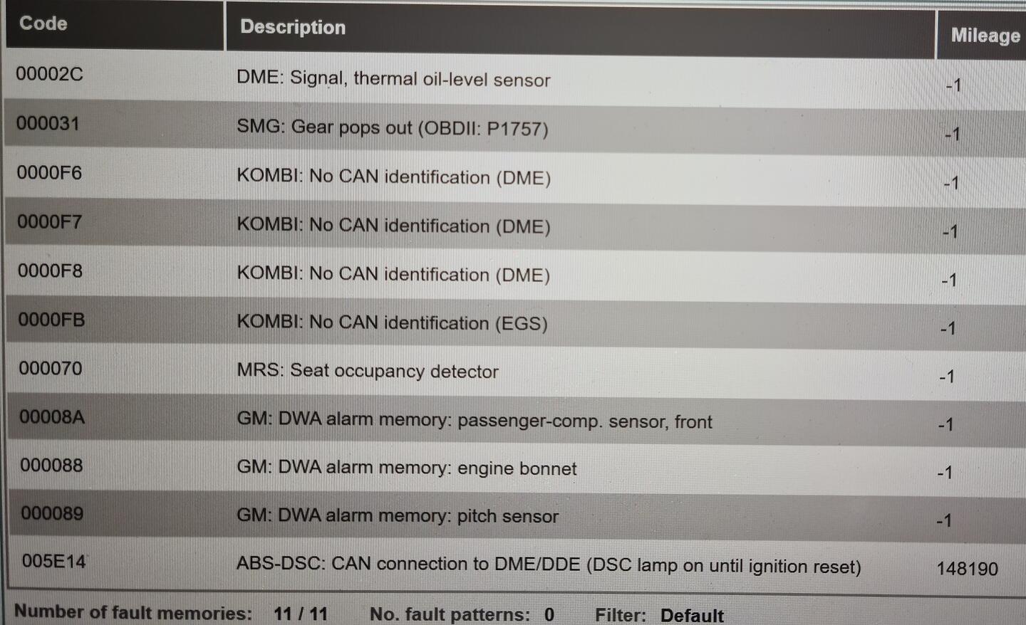

                  I finally got around to pulling codes today, I've attached a picture of the results. From my research thus far, it seems like compression springs / detents are the culprit?
                  Cheers

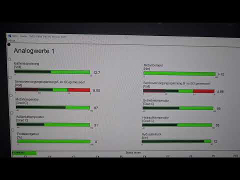

                    And finally got INPA kinda sorted (except for the language) so here's a video of SMG parameters at idle
                      Your hydraulic pump looks to be in good health from the time to first prime to pressure decay when shifting and at idle. The SMG error code hex 31 is decimal 49 which points to the gear position sensor.
                      So in the end it is likely the gear position sensor or springs. Unfortunately I don't know how you can definitively identify which is the root cause. The SMG actuator does fail but it that is more rare.
