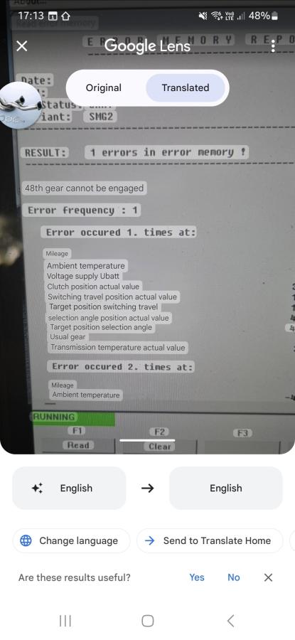

                  I cleared the codes and ran the car today. It will engage 1st and reverse, but when selecting 2nd it flashes and returns to 1st, throwing the cog.
                  Read the codes, 48 - gear cannot be engaged. Cleared them and ran just the complete adaption (F3) again whilst everything was at operating temp and it failed at the same point with the same error.

                    Originally posted by big,JON View Post
                    Thanks oceanside.

                    Unfortunately everything you listed is a possibility. I think it is least likely, but yes possible, that your brand new GPS is faulty. I'm leaning towards the actuator being the problem, see this post.
