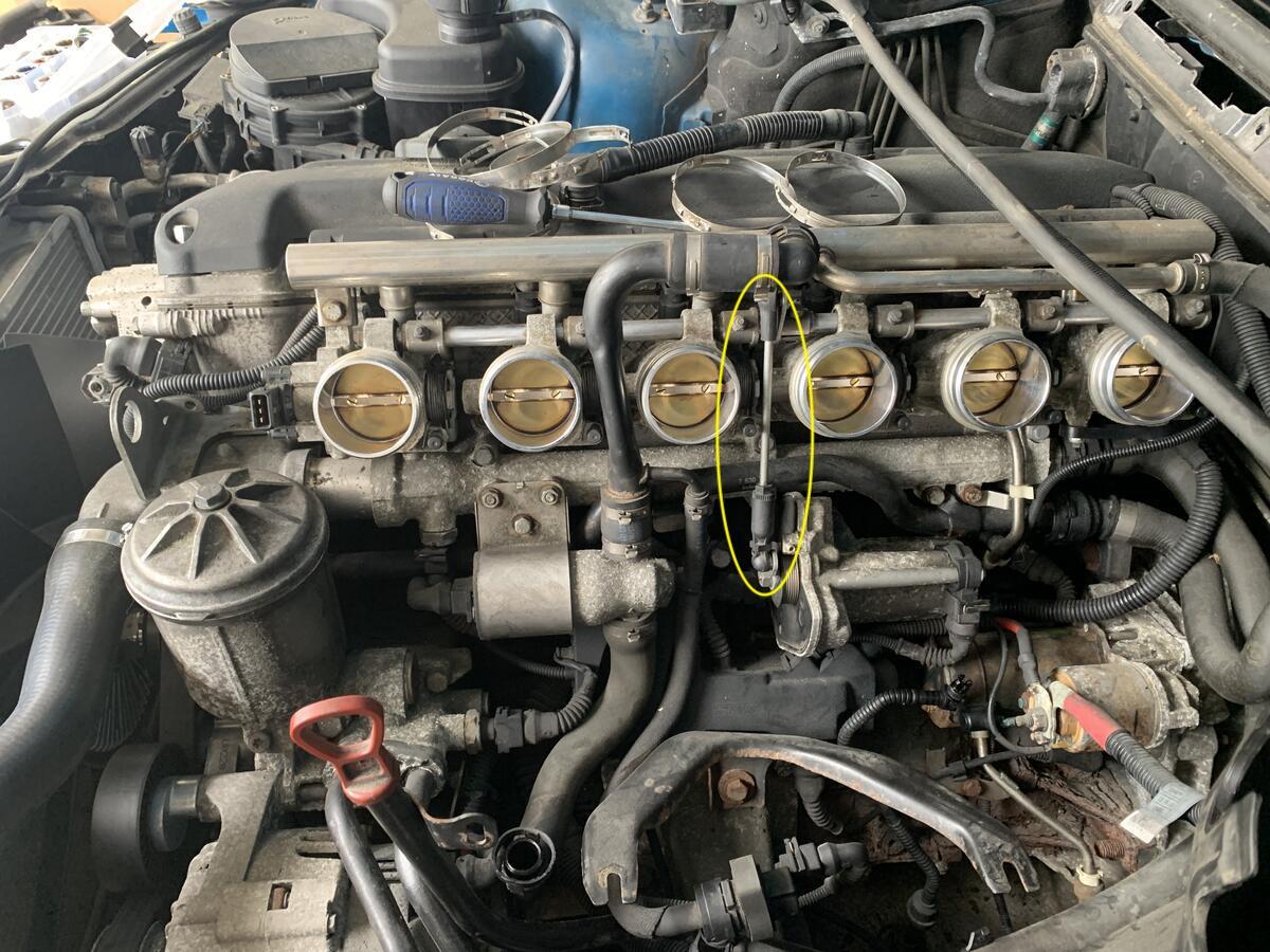

                      had the wife turn the car on while I observed under the hood. She floored it and it did not pass about 3.2k rpm. Two new TPS sensors. I guess I should disconnect the TBA to see if the ITB's themselves are ruined or if its the just the ITB itself. is this the correct route?

                            The lever arm can be manually actuated with the car off. If it does not move, the actuator is bad.

                              I removed the linkage and attempted to move the ITBs with no luck. Where the linkage connects on the ITB, I used a rubber mallet to force and boy was that thing barely moving. I Kept repeating this till it move freely. At the same time I was adding lubricant where I thought it needed and it now moves freely by hand. I will now focus on the actuator it self and the gas pedal to see which one is the culprit. Getting my cable tomorrow so that I can use the INPA on my computer. I will keep you guys posted. Thank you so far
