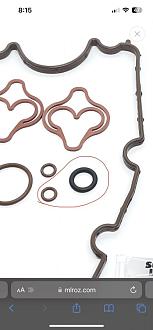

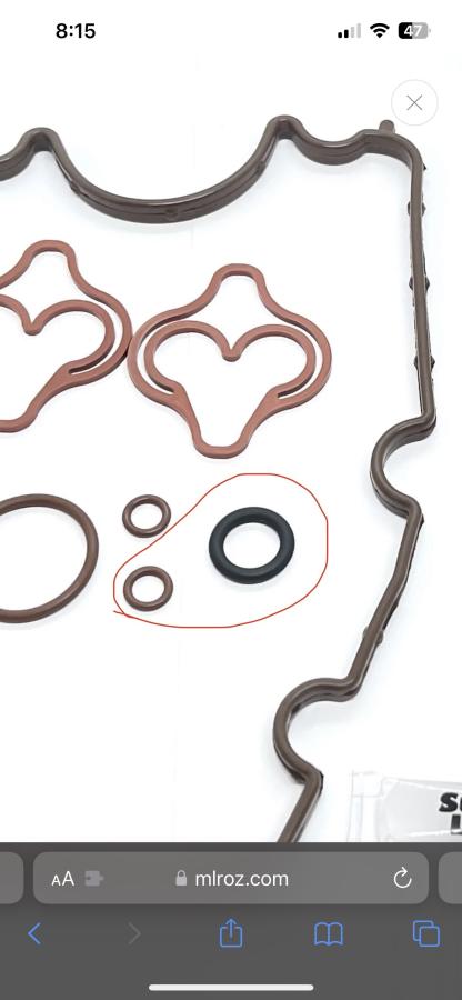

                                Has anyone done a rebuild with a mlr eng seal kit. I've pulled apart my unit and will reassemble it over the next few days but I can't figure out what the two circled orings are for.
                                I'm assuming the larger black one is for the pressure accumulator based on the size?​
