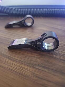

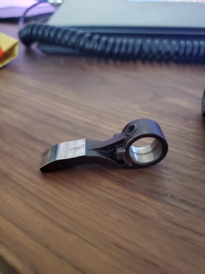

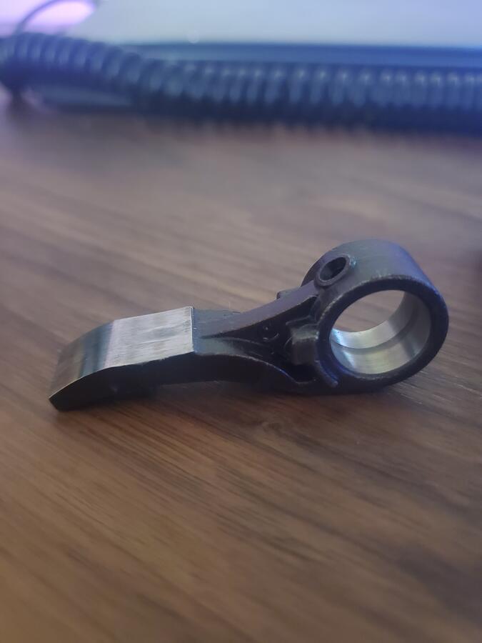

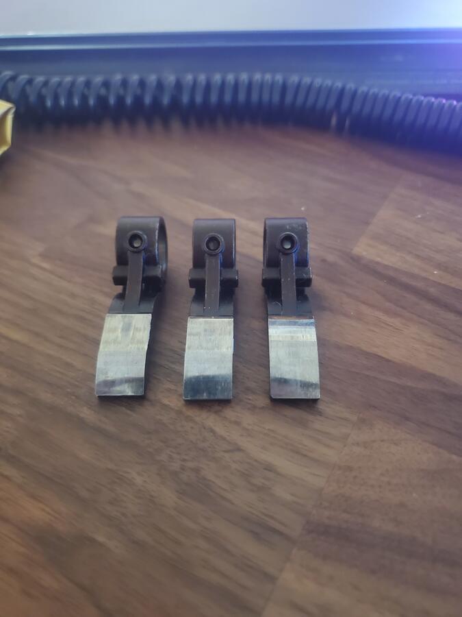

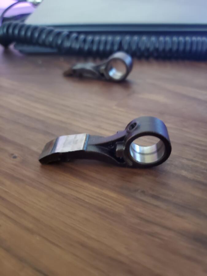

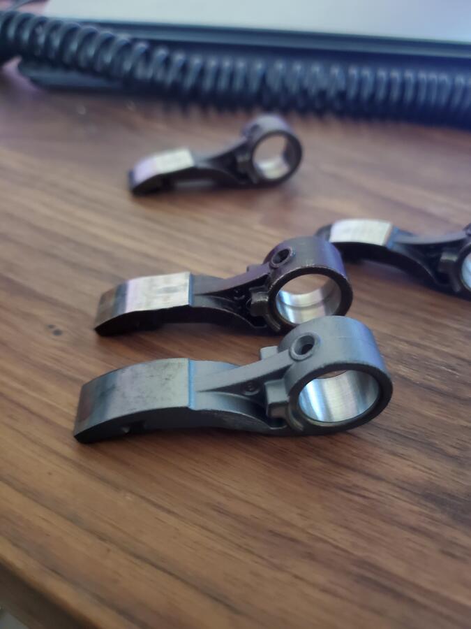

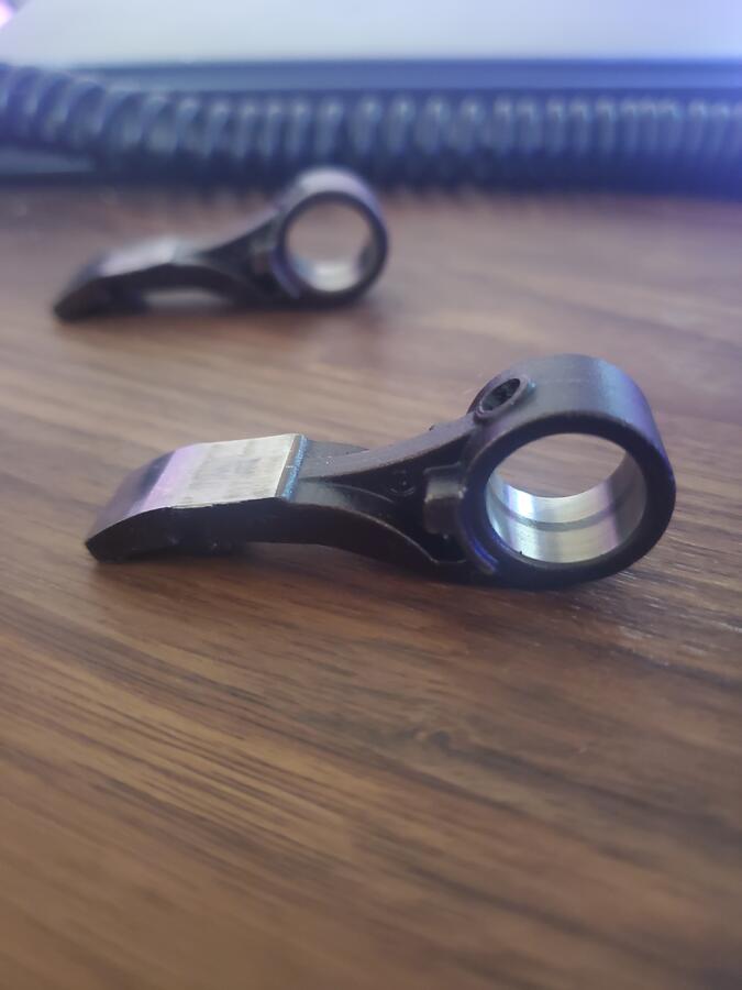

            Any pics showing the flattened ones vs the new ones?
              So I ended up replacing only the damaged ones instead of all 24 as the exhaust cam had a bit of wear on it, and I did not want to pair the worn cam.with new rockers. I started it up yesterday and the car sounds and runs awesome with no weird noises. If I run into issues in the future, I will replace the exhaust cam and all the rockers. I was going to sell the rockers, but I'll hold on to them for a bit as I'm sure they'll get pricier and harder to come by as everything is these days.

                Stop saying rockers!
                  Rockers rockers rockers.
                  ETK - rocker arm
                    Wow. What does the underside look like?
                      rocker arm
                        Maybe you guys have ls1 push rod swaps
                          The term "rocker" isn't exclusive to pushrods.
                            Underside is fine as it only makes contact with the valve shims so it doesn't have an uneven wear pattern.
