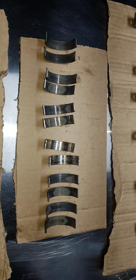

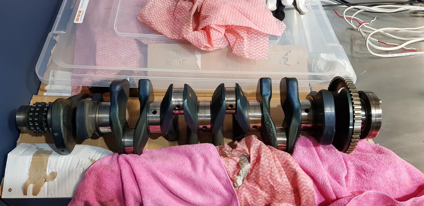

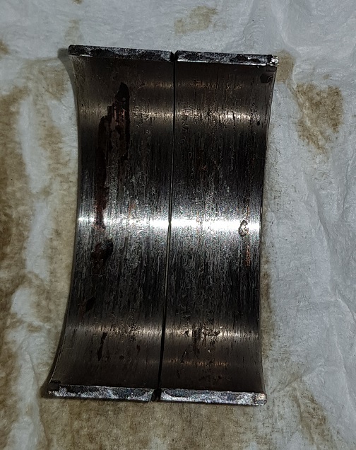

    Cylinder # 3 rod bearing spun quite badly, and the corresponding crank journal was damaged (if I run my fingernail across the journal it does catch!). Main bearing # 4 has chunks taken out of it, the corresponding journal is damaged but still quite smooth.
    I took the crankshaft to a local machine shop; the owner advised me to remove the head and replace rod # 3 as he is unable to machine the rod due to it being of a "cracked" design.

    • Machine crankshaft rod & main journals (machinist also advised the crank will more than likely be bent by 2 or 3 thousandths of an inch)

                      Sounds like you need to grind or turn the crank. VERY important - you have to heat treat it. You’ll be removing the hardened layer on the journals. Need to re-treat.
                      At least in the US, it’s almost cheaper to just buy a BMW reman crank. If Lang Racing is still doing crank repairs...that would be the option I’d go with.

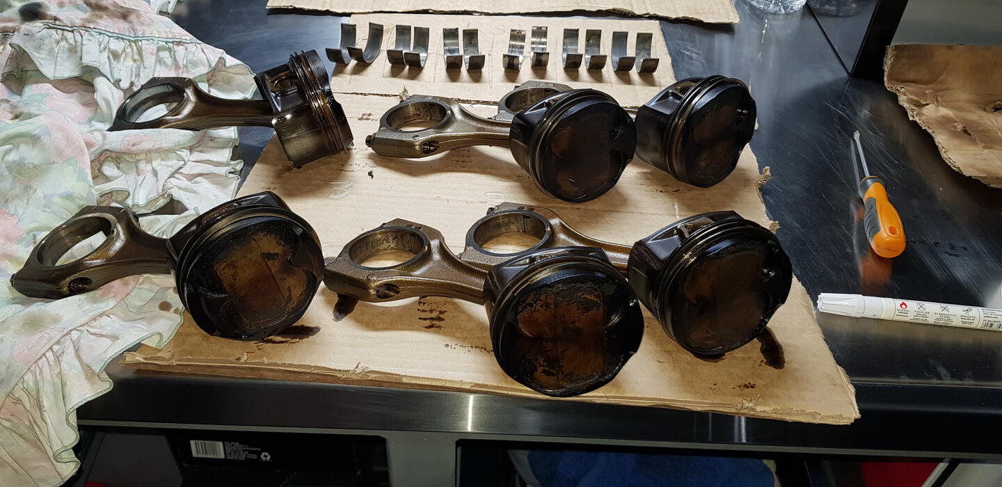

                              So last night I removed the head. No issues at all with the head gasket or anything else for that matter. Bores look perfect, as do pistons.
                              I'll be keeping the stock pistons/rods. Replace rod # 3, have everything balanced, crank machined and get it back together. Just need to piece together a comprehensive list of parts I require.
