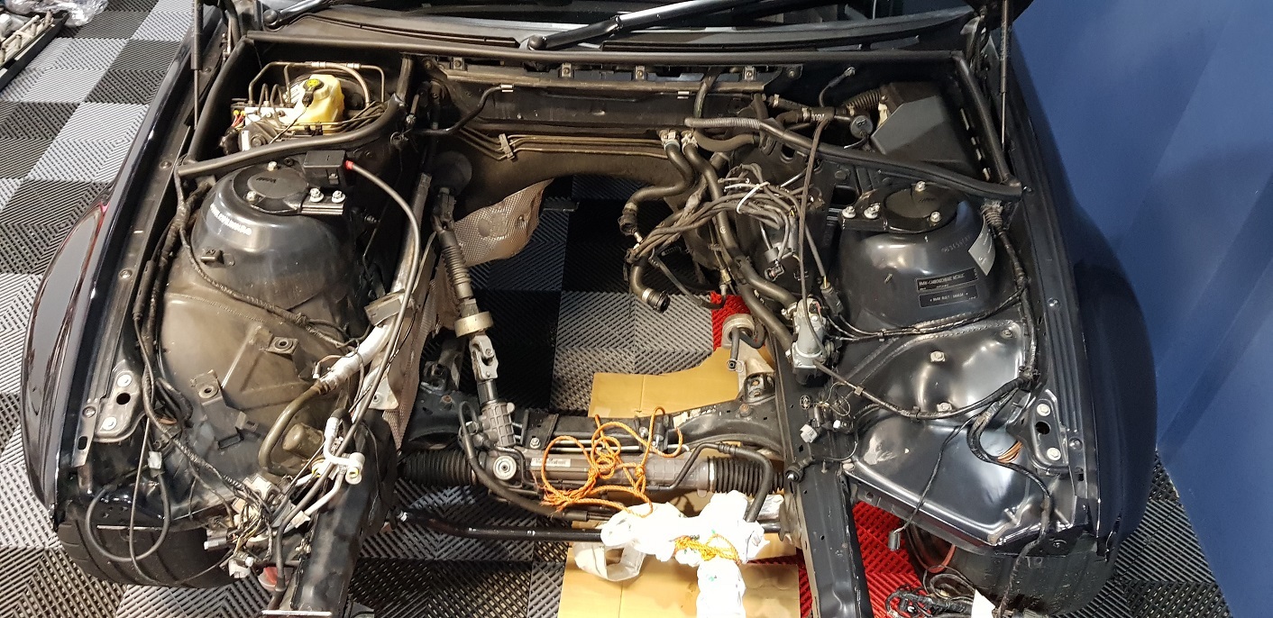

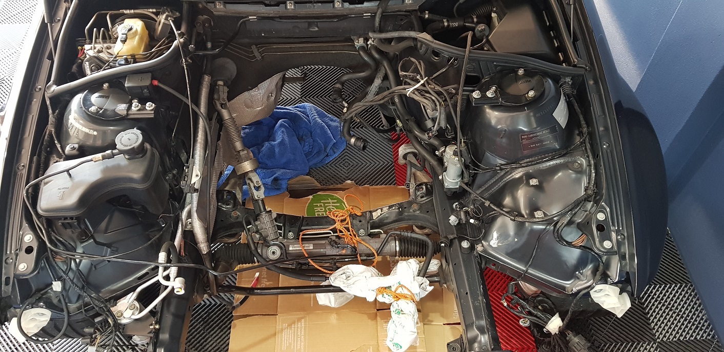

      As the engine/trans is out, I started cleaning the entire engine bay to make it look as new as possible. When I originally purchased the car, it ventured through the north-west of Australia on the back of a truck and was absolutely covered in the fine red desert dust we get here. This dust gets into literally every nook & cranny; it was freaking everywhere in the engine bay. I spent an entire day meticulously cleaning the engine bay! I've also gone through each individual part removed from the front end / engine and cleaned everything of any dirt/dust/grime/oil/etc. Once everything is re-assembled, it'll be sparkling clean
