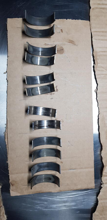

ACL sell over-sized rod & main bearings for the S54.
I'll have the crank machined and go with the relevant oversized bearings.

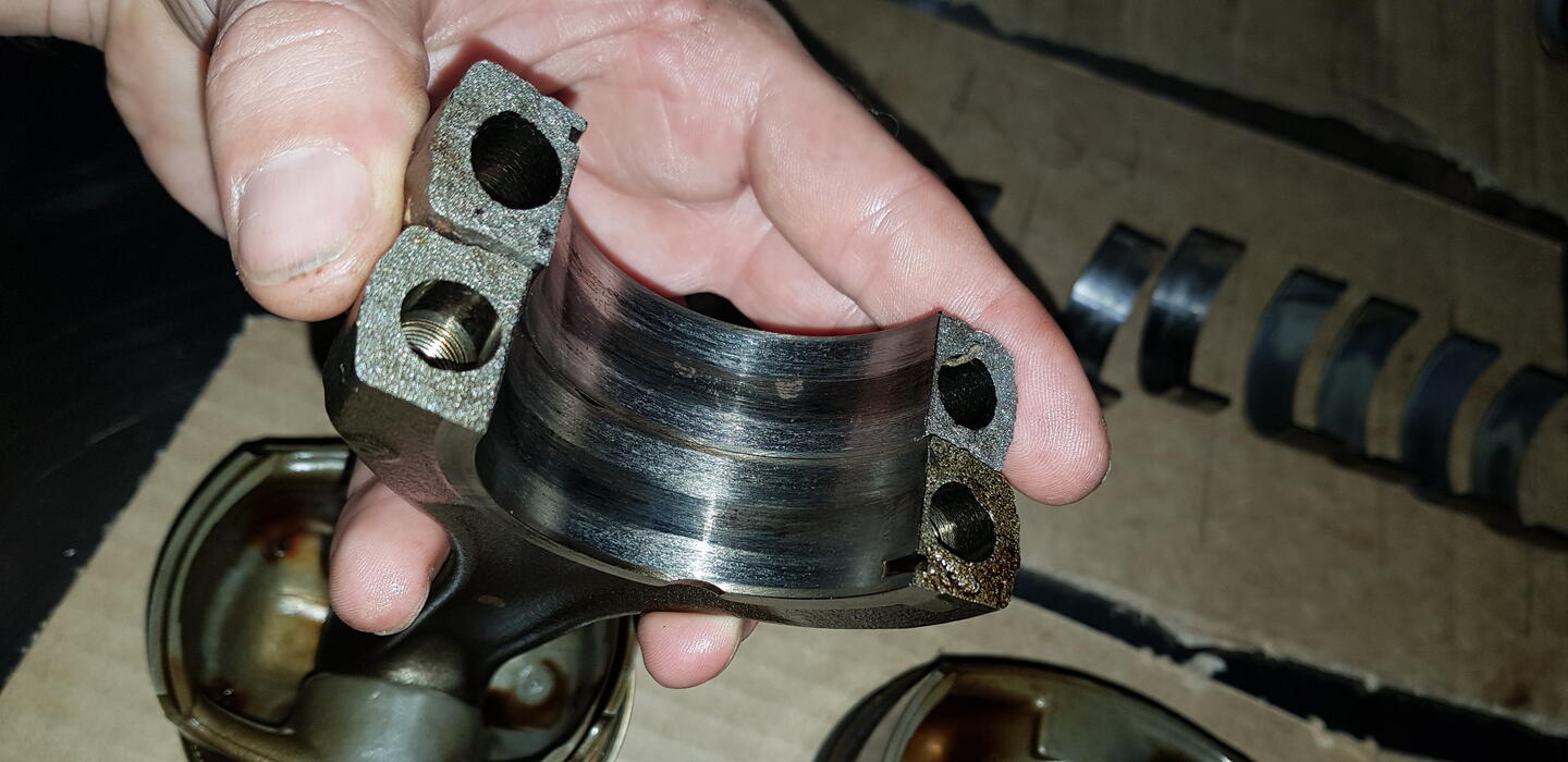

Oversized bearings are NOT for situations where you spun a bearing, machine the crank and now have a smaller journal. Oversized bearings are used to account for manufacturing tolerances.

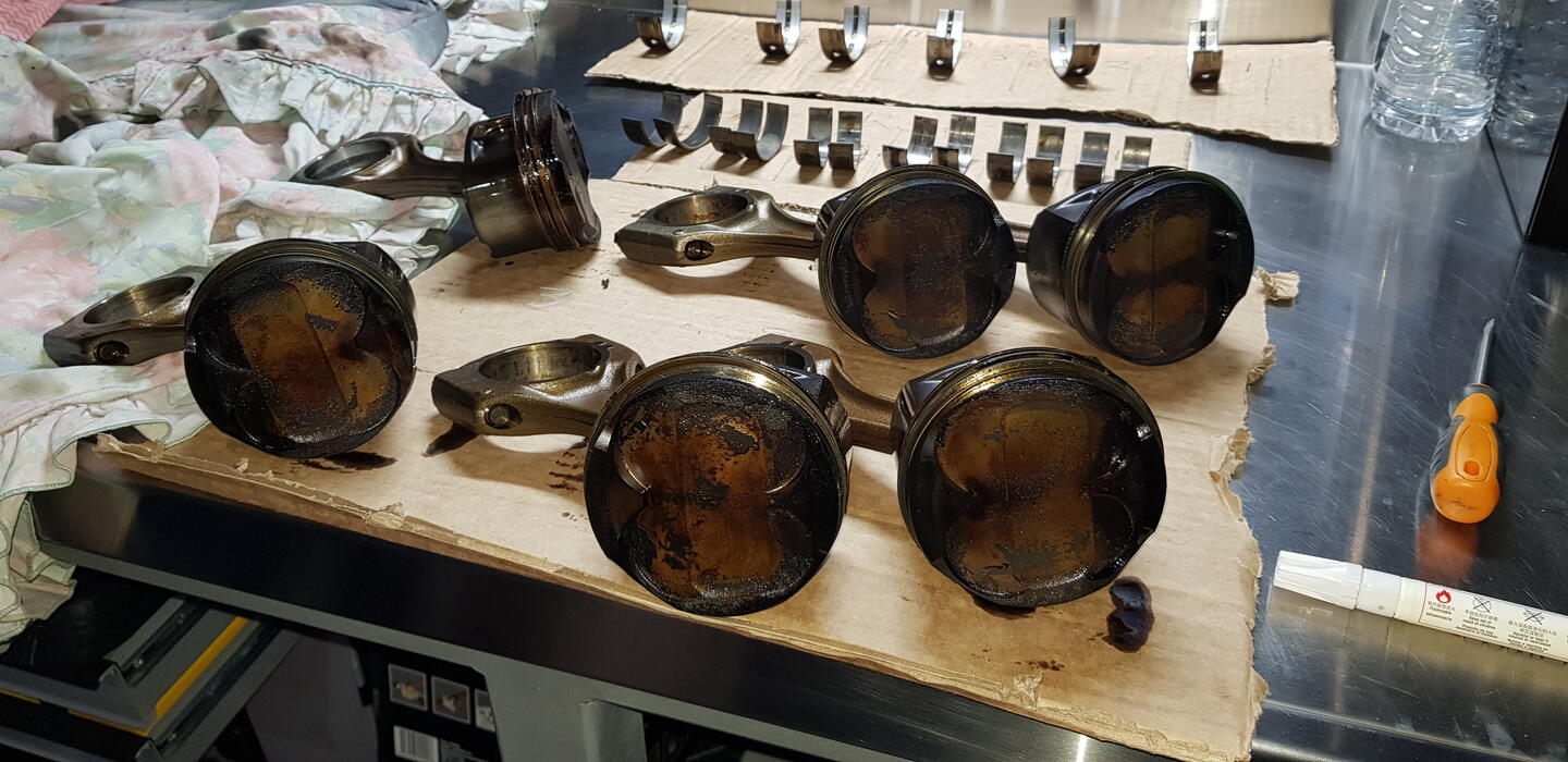

Those pistons have a decent amount of carbon on them. My engine that blew had comparable amount but my new one has much less. Whatever was contributing to the carbon may have been the cause of the wear. Just a thought because this is a lot of effort and money. It's super fulfilling when you get her running again. Good luck with everything. I'd love to see the start up video.This is my Unbuild Journal and why we need an oil thread
Piston 2 did have a broken bottom ring. Who knows if this has anything to do with it.Originally posted by Arith2 View PostThose pistons have a decent amount of carbon on them. My engine that blew had comparable amount but my new one has much less. Whatever was contributing to the carbon may have been the cause of the wear. Just a thought because this is a lot of effort and money. It's super fulfilling when you get her running again. Good luck with everything. I'd love to see the start up video.
