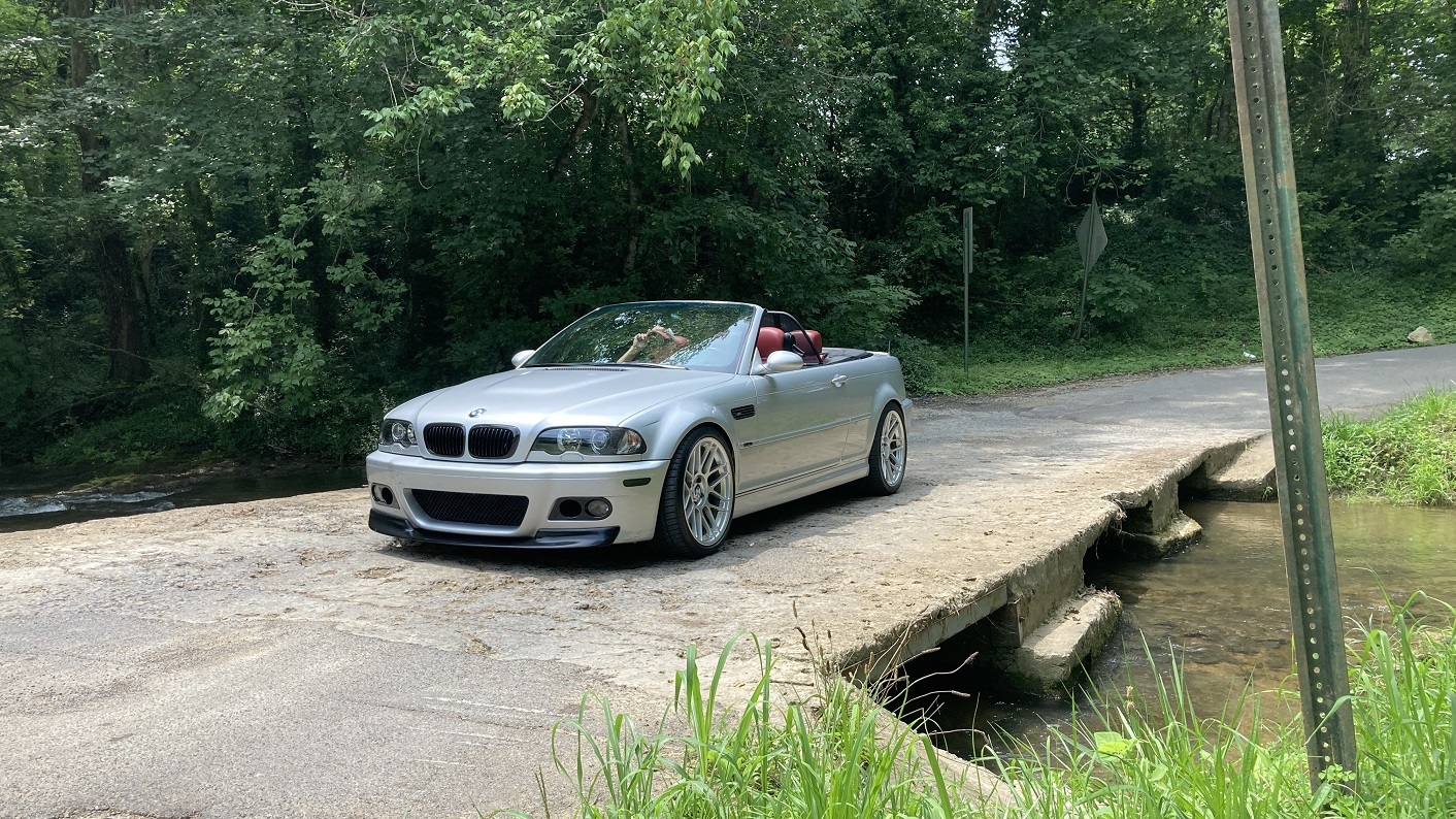

                        I have the bbs RGR in 18x8.5 et38 in front and it's an easy fitment. Helluva lot better than the stock wheels but not aggressive where you need to be careful about rubbing. Running stock camber for tire life they look nice.
                          That is awesome sir, thanks for chiming in. Are you running any spacers upfront? Would love to see some pictures as well.
                          Got the below settings from the build journal:
                          -Singh
                          2004 e46 ///3 | Laguna Seca Blue | Black Leather | 6MT | Coupe | OEM+​
                          BBS RC | Supersprint | Ground Control | Besian | Euro
                            paging Obioban
                              18x10 et25 rear
                              18x8.5 et38 front
                              no spacers
                              stock alignment
                              dinan springs
